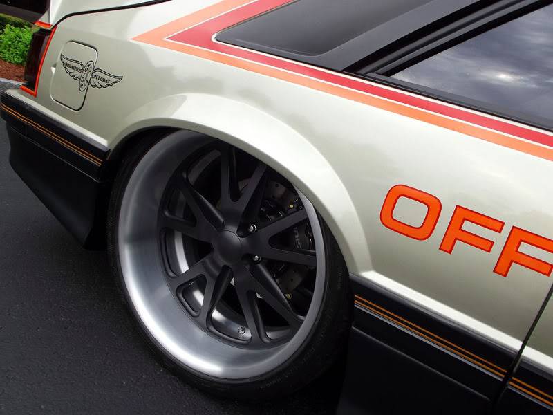

      On another note, I like the FR500 wheels but I was going with custom setup on my so I ending up doing custom wheels but I choose them because they kinda have a similar design to the FR500s if you look at the spoke design. I narrowed my rear 3" on each side and then had custom axles made that used the same offset as the stock fox setup. So you could also have them custom made to your specs for the brake you want to run. I also went custom on the brakes with a wilwood kit that was for foxes but with 9" ford ends.

      I got the exact wheels on my 69!

      WOW! loving that pacecar! Looks great!
