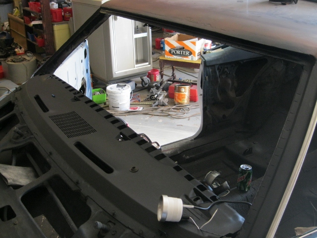

Size:  228.7 KBThanks, I thought the Camaro wheels looked better than the rally II's, which I also have a set of. A little hard to tell but it has Pontiac center caps on them. Here is what the car looked like before putting in new floors and new windshield channel.

      Name:  IMG_1686 (640x480).jpg
Size:  186.8 KBName:  IMG_1688 (640x480).jpg
Size:  189.8 KBName:  IMG_1685 (640x480).jpg
Size:  179.0 KBName:  IMG_1687 (640x480).jpg
Size:  207.2 KBName:  IMG_1689 (640x480).jpg
Size:  186.0 KBHere is the new channel as well as the installed gauge cluster. What I am working on now is a pillar dual pod to house white faced oil and temp, and the volt fits perfectly in the old clock housing that mounts to the console, all gauges are back lit in blue. For such a low buck investment I think it turned out rather nice.

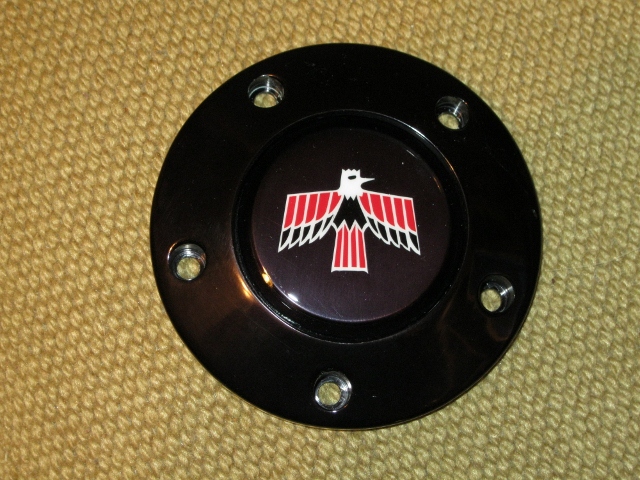

      It is a company called whitefacegauges.com, it was an overlay that you just lay on top of the old gauges, the bird on the gas gauge I had a local print shop do as it was left over from a bird they put on a billet horn button as I am copying the steering whee layout on Adriene Janic's 68 Bird. It's not perfect as it is in several pieces and if you stare between the digits and the speedometer marks you can see a line but it still turned out well. It was $35+-, most expensive part was the blue bulbs at $5 a piece.

      Name:  0810phr_10_z+1968_pontiac_firebird+steering-wheel (640x480).jpg
Size:  66.1 KBName:  IMG_1694 (640x480).jpg
Size:  233.8 KBHere is the look on want on the wheel, I have the button made as I said, the wheel is a Grant model 1020, as I do not have a front end on the car, the wheel is not at the top of my wish list.

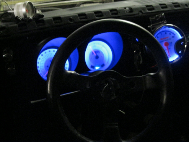

      Name:  IMG_1765 (640x480).jpg
Size:  163.6 KBName:  IMG_1766 (640x480).jpg
Size:  153.1 KBHere is a picture of the gauges lit up in the dark, not bashing the new high tech speedometer clusters but I like the old stuff and being on a budget, this really sets the interior off. I have a set of 90 Recaro Vette seats to install and am going to try to modify the back seat from a later model Acura TL. Fiberglassing the pillar pods now so hope to have pictures of that in a week or two.

      How did you put the top panel on your dash? Mine has a lot more cancer than urs did.

      cut the panel out and replace it with an aftermarket panel. We did this on our 69 Nova using panel bond so we could adjust the placement of the panel. With the dash pad in place it is almost a perfect fit, no seams showing.The 67 bird is coming along nicely. I am building a 67 bird also. looking forward to your progress.

      I was just real lucky as being a GA car, the channel was rusted badly on the sides and the top but the lower / top of dash panel was perfect so it is original to the car and I just cleaned, used POR 15 around the edges and then painted.

      That bird on the overlay and the horn button. Is that a sticker? Tell us more on that. It looks really good.

      I actually had a local sign shop make the bird emblems, they are vinyl and in about 4 pieces, you lay it down by section and then clear coated over the Horn Button. Cost a grand total of $5. And they made several so I was playing around when I did the white face gauge overlay and put it on the gas gauge since it was kind of bland and had a big empty spot. Having the white background the bird's head being white is a little off as it would look better in a contrasting color but it turned out well for just playing. The whole idea started when I saw AJ's interior in last years Year One Catalog and went from there.
