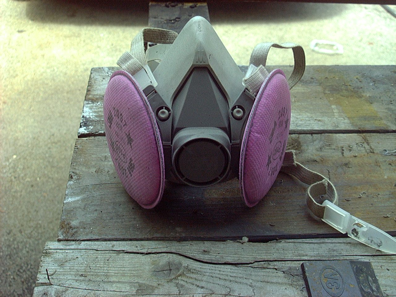

      Respiratory Protection: OSHA assigns a PEL (Permissable Exposure Limit) to all known chemicals that could become a dust, fume, or vapor (dust and fumes are solids, vapors are liquids). These values are assigned for unprotected breathing, and are usually a weight per cubic meter of air (mg/m3). There are many types of respirators on the market that provide different levels of protection. There are also many different types of filters, each type protects you from a different type of nuisance.
      Half face respirators- exactly as stated. Covers half of your face, offers no vision protection. Respiratory protection at the rate of 10x the PEL.
