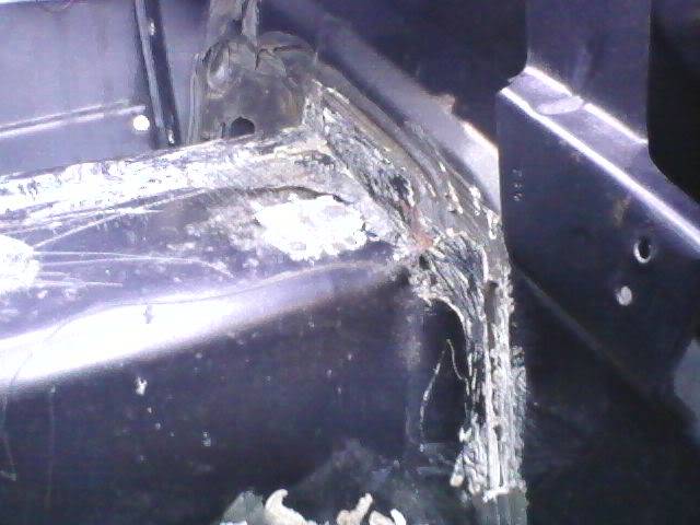

      In this first pic, I'm standing on the left side of the car, near the rear, looking down on the top of the sub-frame-rail. Notice how I've scraped away all the glue so that the new steel can sit flat

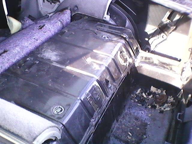

      Now leaning in, standing a bit forward, looking toward the rear

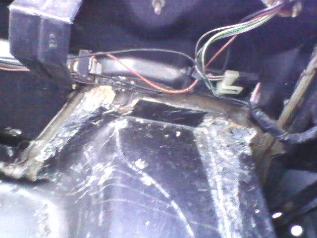

      Now same thing, but looking at the passenger side instead

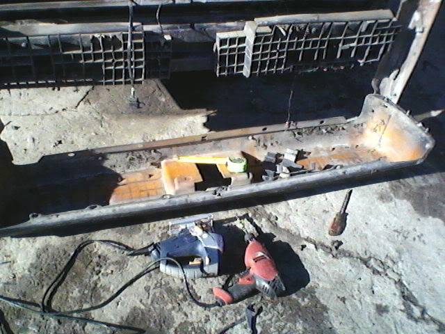

      Notice I have the deck all scraped, hammered, and smoothed flat for the GN plate

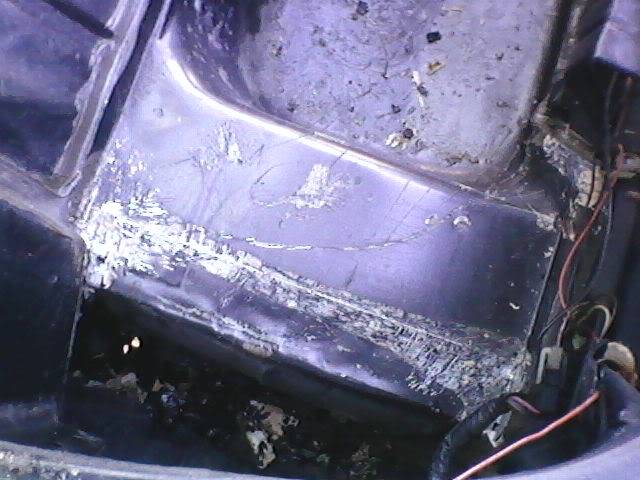

      Here's as far as I got before I ran out of blades ( and drill bits )

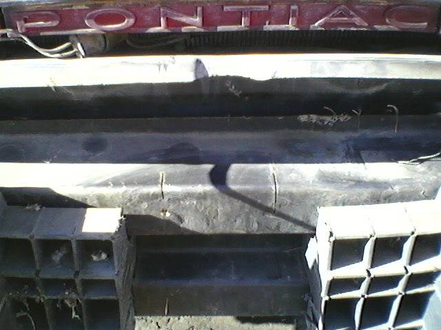

      and here's a close-up
