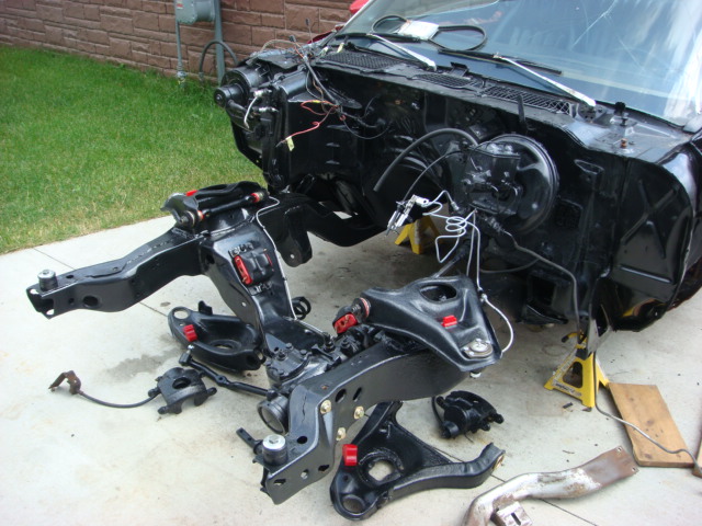

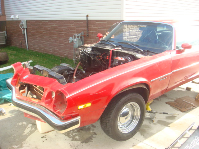

      Tear down began after I got it into the garage!
Size:  171.9 KBName:  ao.jpg

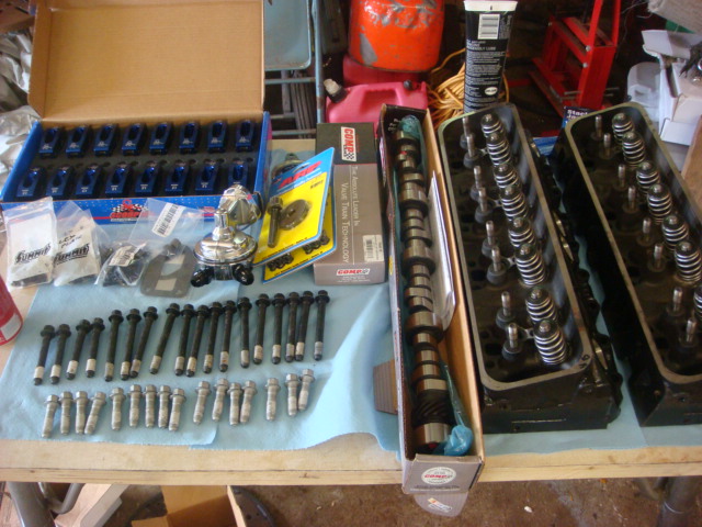

      Thought I would throw up some pictures of the engine build.
      The 350 short block I picked up
      Nothing beats a table full of parts!

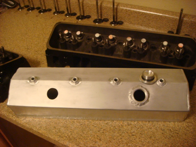

      fabricated valve covers I picked up. Got the oil fill bung welded in. hole for catch can baffle ready to go

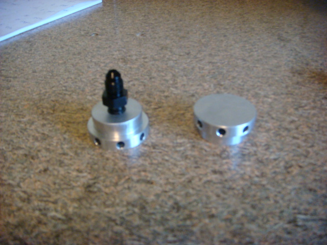

      Here are the baffle for the pcv/catch can I machined the cnc lathe. This was a one operation part turned and drilled with live radial tooling on the 3-axis. I am a machinist by trade.

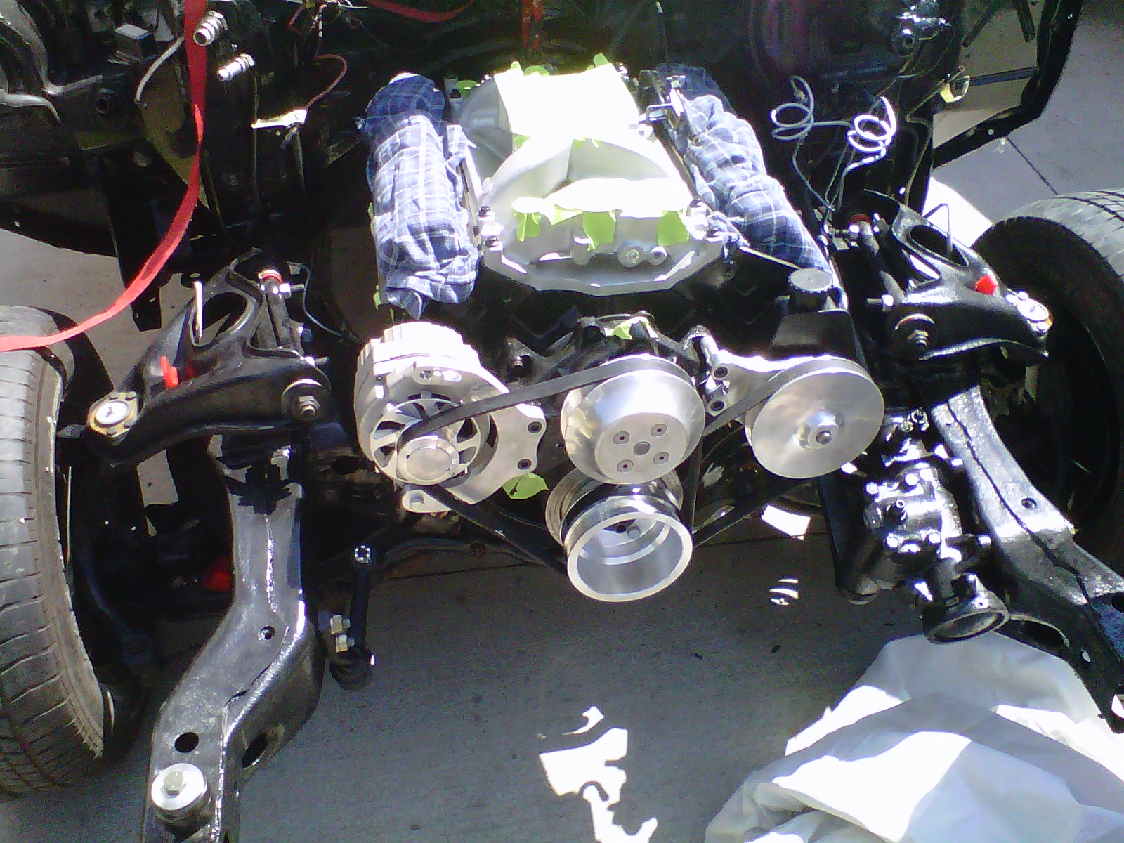

      Engine almost complete. Valve covers done

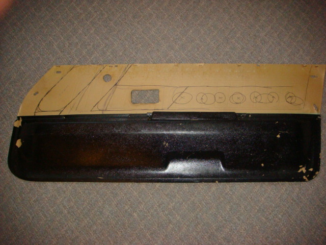

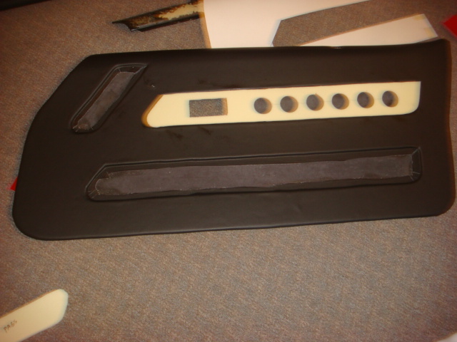

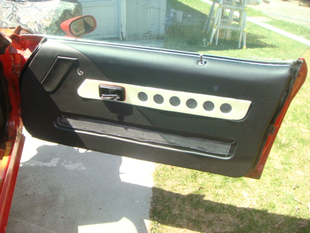

      Well for a change of pace I thought I would post up my door cards I made. I have no prior experience in interior work. I was cruising the internet one night and stumbled across some youtube videos, and thought it looked pretty easy. I made these in the dining room of my apartment. Luckily my girlfriend was very layed back about having materials spread across the dining room... into the living room..with some crap laying on the kitchen island!
      Old door cards torn apart. you can see a little brain storming with my sharpie.
      I made a template from the original door panel and cut out these backing boards

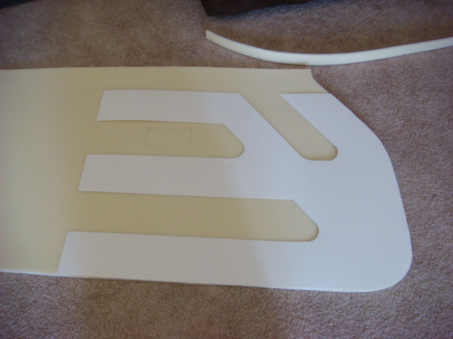

      I made another template of what I was after and cut out the high density foam.
      Here I have the foam cut out and glued to the backing board.
      Here I have the panel covered with vinyl. I was going to make the inserts out of foam also, but ditched that idea.
      I decided I had better test fit them to the door. I did not have the door at my apartment when I was making them, so I had my fingers crossed.
      Well I got lazy with the camera, but here is the finished panel.

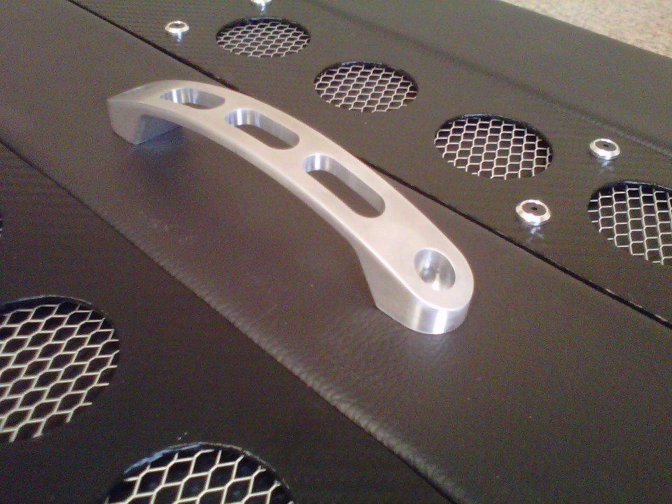

      Here are the door pulls I machined out of aluminum. The door pulls, and the aluminum trim washers on the flat heads screws that you see in this picture were also made by me.

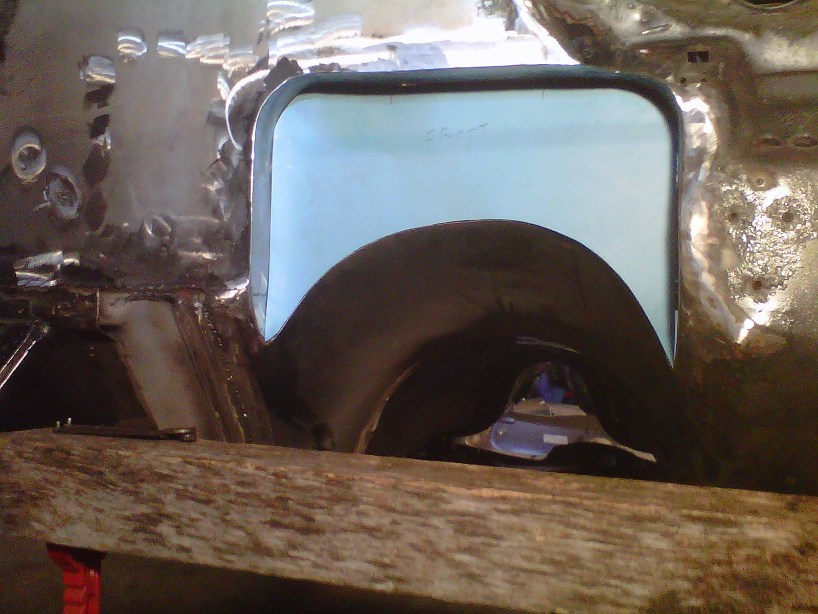

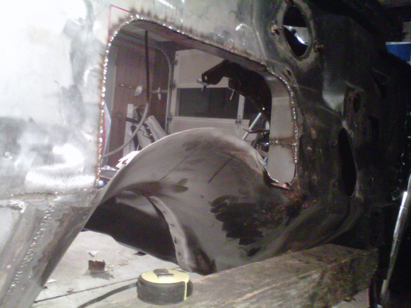

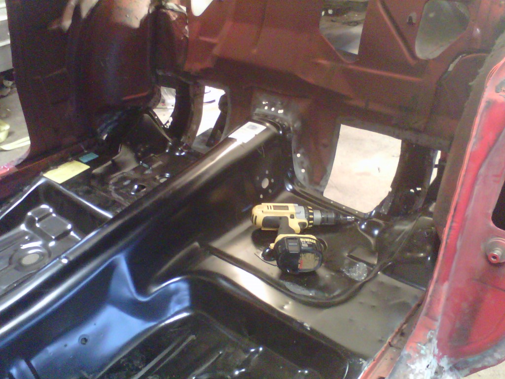

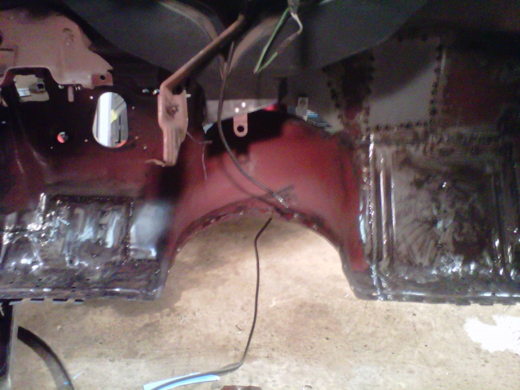

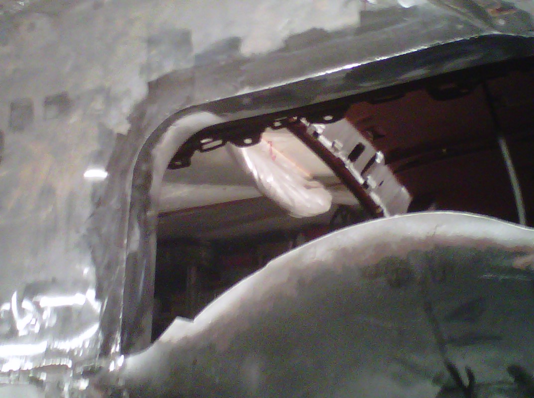

      Well onto the floor repair. Considering the floor was shot, and the torque boxes were literally gone.. well 80% anyways. I decided putting a 70-73 full floor in was the way to go. The rear subframe mounts are a few inches farther back because the bracing was different on the 74-81 to fit the cat on the passenger side of the car. I will need to rework the rear mount on the subframe.. no big deal.
      Well here is the stock floor after some cutting...
      here is the invisible floor. That brace was later removed as the new one is already attached to the floor.
      The new floor...that took 2 months to arrive!
      Leveled out the whole car as best I could. Got it relatively level. Should be within 1/32" all the way around. That burned up a lot of time.
      Fixed the front torque boxes and floor with parts I cut out of my 77' donor.
      After a few hours of leveling, and making sure the height from my front and rear subframe mounts matched up I started spot welding the sides to the inner rocker. I plan to go back after the rest of the body work is done and stitch weld the entire shell.

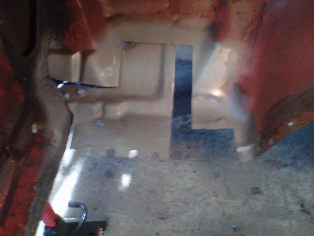

      This is all I have left of the floor. I got the front tips of the rear frame rails welded in that were cut from the donor.

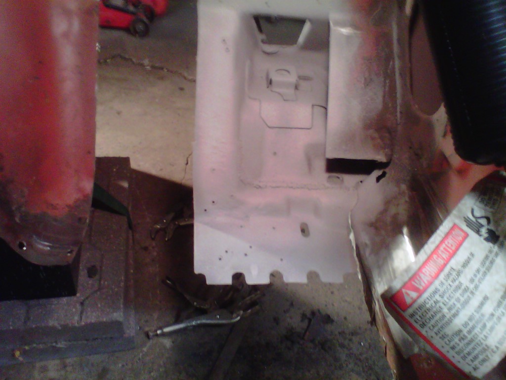

      Onto the firewall.

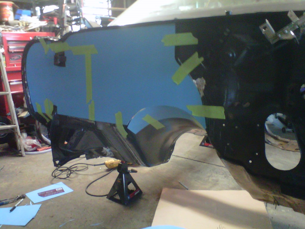

      First off I cut off everything that potruded from the firewall
      Here are my templates in progress. I've come tot he conclusion that templates are your best friend in sheet metal work. I went a different direction with the transmission tunnel, it was just to much flat space. If only I had a bead roller..
      here is what I'm doing with the tunnel.
      I do enjoy a good template making session!
      I am so far happy with how it turned out. When I told a few people my plans they thought I was wasting my time, and that it was to much work...so that motivated me more..
      I still need to get the clutch cylinder bracket fabbed in. I am also hoping to do something with the seam at the top of the firewall to the cowl. I am thinking about trimming it back and welding a piece of 3/16" bar stock to the front to blend it in.
      This is my first real attempt at sheel metal fabrication. I do have a degree in welding, so that was the easy part.. but have never been into the sheet metal side of things. I'm looking forward to doing some more... I have tons of ideas, but the other body work is taking priority, and just have a major overall lack of time.
      My plans for rubber is to do a 275/40-17 on all fours. From my understanding from nastyz28.com... that is my widest option without tubbing. I would like to tub.. but realistically it just isn't in my budget.
      I'm planning on keeping the leafs with a full hotchkis suspension setup. Adding a spring offset, shocks, shock bar..etc would just be to much expense.
      I have been thinking of flaring the quarters to get the width I would really like, but the front would almost be mandatory to look decent..but thats still undecided.

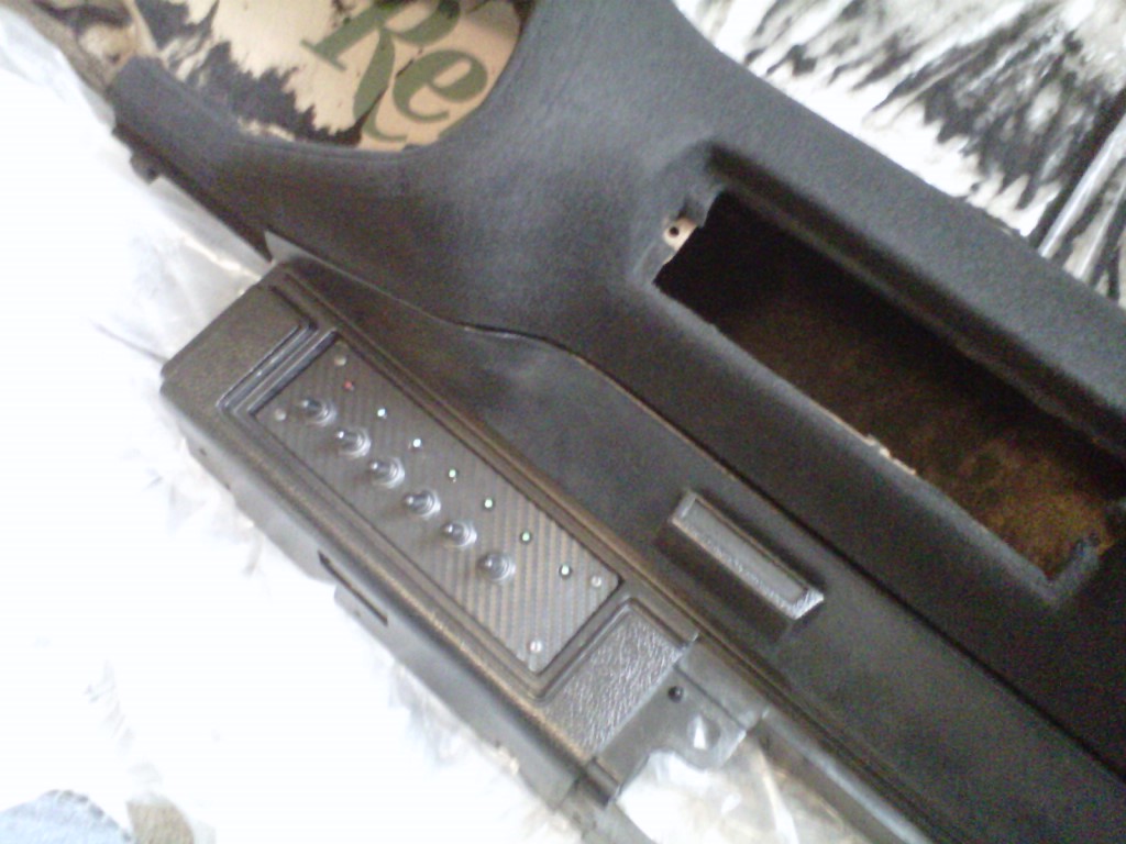

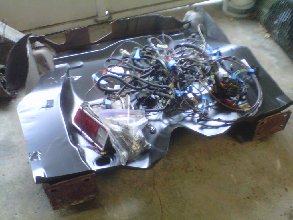

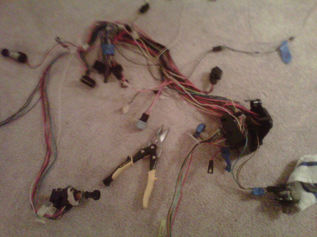

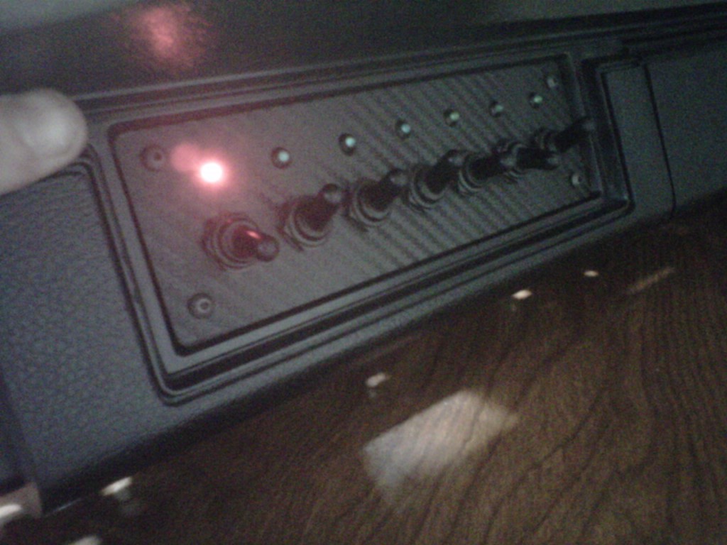

      Being an hour from the car, I am always trying to find small things to do at my apartment...so onto the wiring. My other major hobby is rifles.. But I decided to turn my reloading room and bench(spare bedroom) into my small workshop for my wiring.
      Here is the mess I started with. Thats also my nice new trunk floor that its piled on.

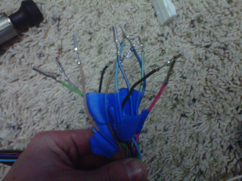

      After studying wiring diagrams I started dissecting the harness.
      Here's a bunch of useless junk I spliced out. (door buzzer, seat belt buzzer, few idiot lights, etc)

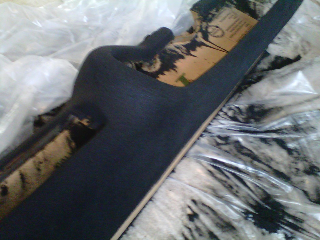

      Oh yeah, the stock dash was tan and had a lovely interior paint cover up job. I sanded it down and decided to 'flock' it. This is used a lot in race cars wether its rally racing, alms, etc.. Oh this was also done in my apartment workshop!

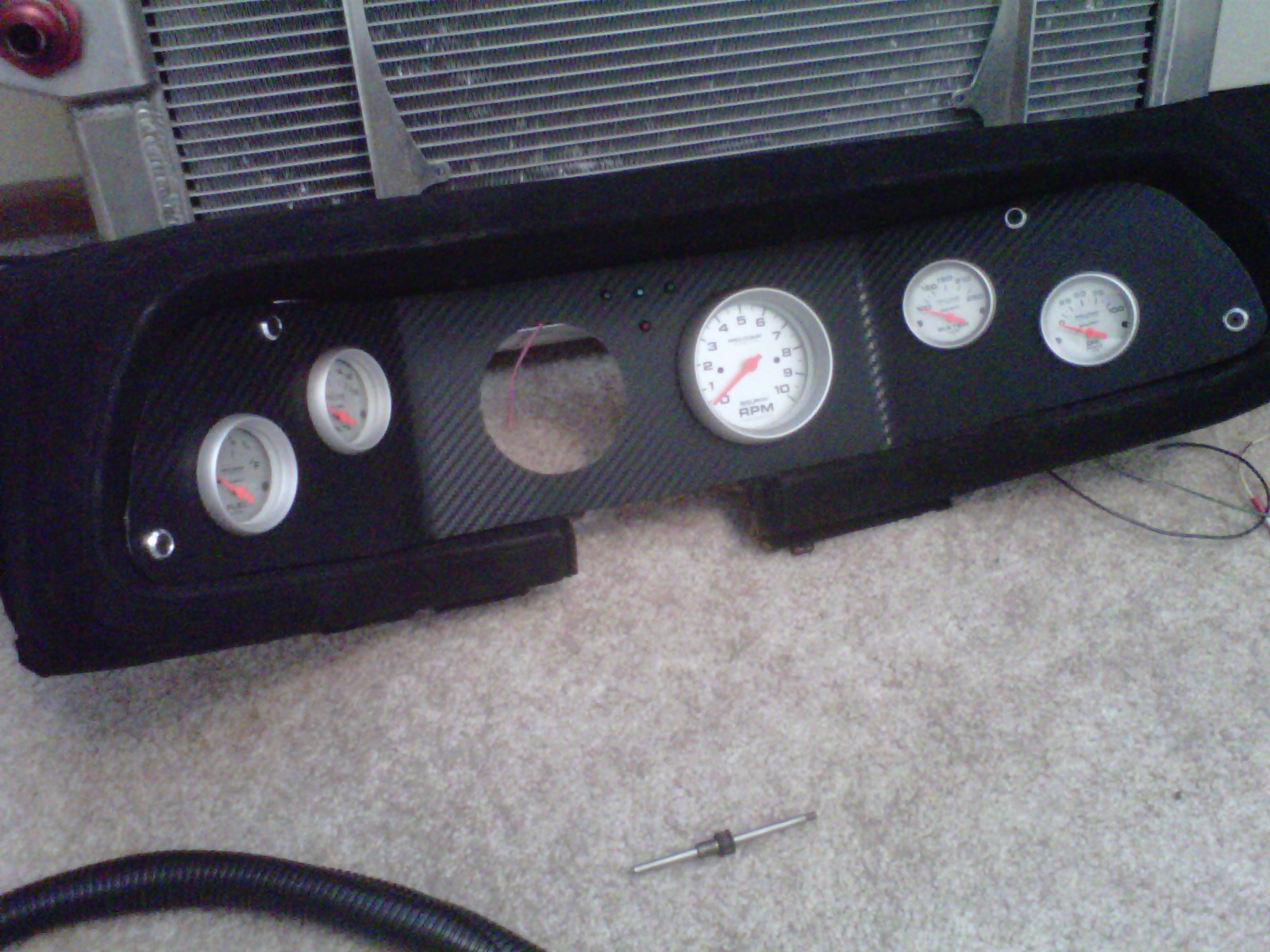

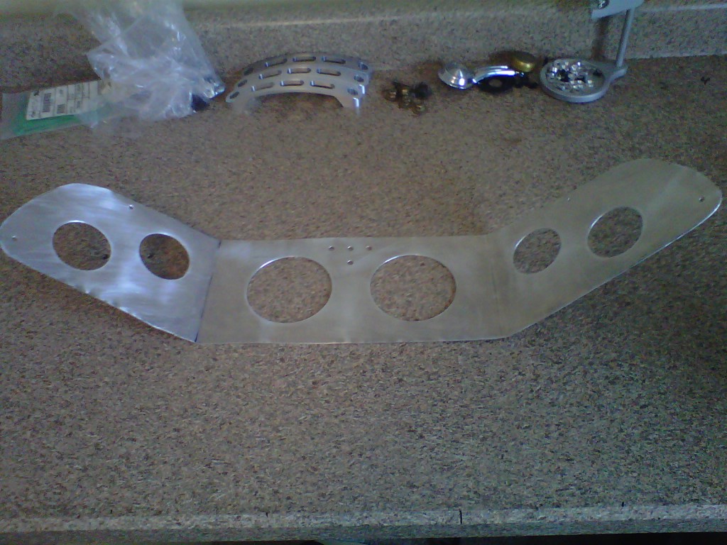

      Test fitting my gauge panel and switch panel in the flocked dash.

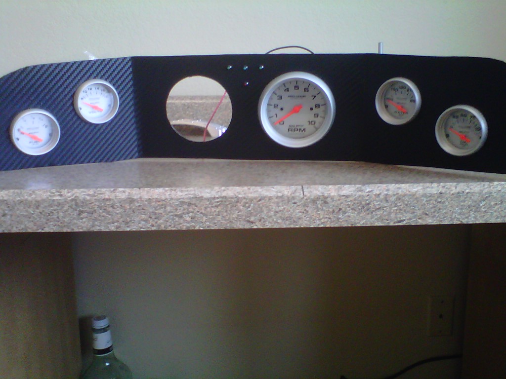

      Next up was to finish off the gauge panel. Also started wiring up the harness for the gauges.
      Then onto the switch panel, switch panel wiring, and also modifying the stock harness to plug into the panel harness.

      How hard is the flocking process?
      Is that real carbon fiber - or some kind of wrap on the gauges/door panels?
      2014 Chevy SS LS3 / 4 Door
      Oct 2011
      Thief River Falls, MN
      74
      Quote Originally Posted by bonecrrusher View Post
      Damn - loving the fab work.
      The flocking process is quite easy. You basically have a basecoat that you brush on. the actual texture is created by applyingfine fibers. There is an applicator tubing that you use to apply the fibers by 'blowing' them onto the wet base coat. kind of like a tar and feathers type situation. The only real way to mess it up is to get the base coat brushed on too thin. You basically mop it on and stop before it runs. check out donjer.com. I got the mini flocker kit for 24.80. If you are doing a dash you will want to have a second person help you with the base coat, and if I were to do it again I would order a second applicator to have a second person help there also. It is impossible to overdue the application of the fiber. just keep blowing it on, anything extra will just not stick and fall off. Only problem is that you have a one time shot at doing it. If it drys you'er out of luck. If you try to do a second layer over it the texture will be course and lines will appear where you overlapped it.
      As far as the carbon fiber, yes its just vinyl. It is 3m brand, and awesome stuff. Search 3m di-noc.
      It is actually textured a bit like carbon. pretty much as close to the real thing as your going to get looks wise. I got a 3' by 4' roll off ebay for something like 45$...so a bit spendy.
