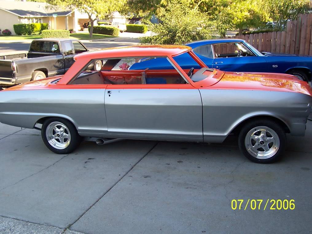

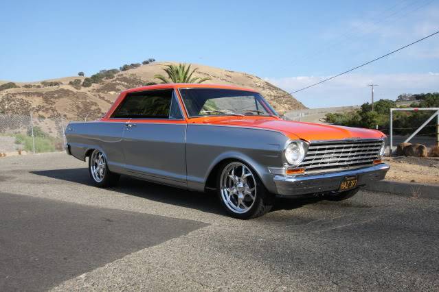

      started out a stock nova intill i got ahold of it back in HS ever sense then things have been changing on it, stared out as just a cruiser for school an the shows, all started one car show where they had the autocross going on, thats changed everything. ever sense then i have been upgrading the car to start racing in the autocross at the show. Got a good start on it but there are still more thing i need to add to get it to where i want it..

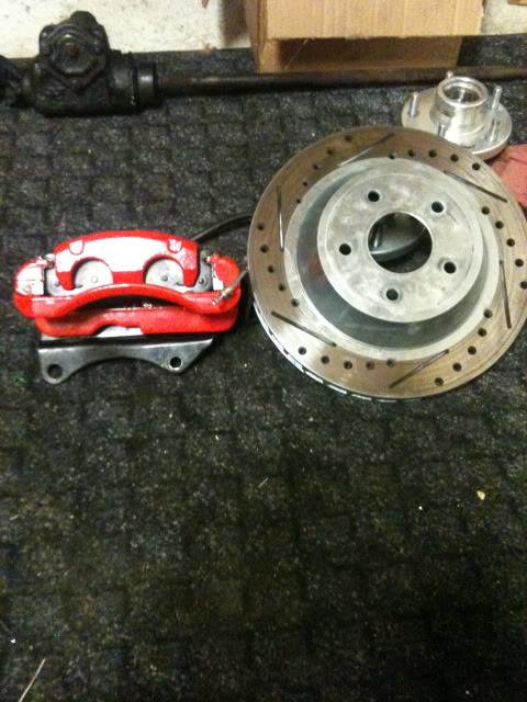

      FRONT SUSPENSION- CPP mini subframe kit (frame brace, tubular upper an lower control arms), Coil-overs, CPP 13inch big brakes, 1 1/8 solid sway bar, CPP 2inch drop spindles & steering arms
      REAR SUSPENSION- Global west 1.5 inch lowering multi leafs, 1inch solid sway bar, frame connectors, lowered
      RIMS- 17inch intros
      TIRES- 235/40/17 BFG G-force KDW(rears) 215/35/17 (fronts)
      MOTOR- just your standard SBC making around 350 for now
      TRANNY- tubro 350 shift kit, 3500 stall
      UPGRADES IN THE WORKS-
      FRONT SUSPENSION- strut bar to tie the front end together
      REAR SUSPENSION- 4link conversion
      MOTOR- alum heads, bigger cam, change out gear drive, electric fans, change fuel system
      TRANNY- 5 speed conversion
      thanks for checking my ride out, ill try an keep the site updated with pictures, its been a fun project i've had the car sense i was 16 an im 23 now dont think i will ever sell it!

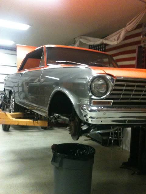

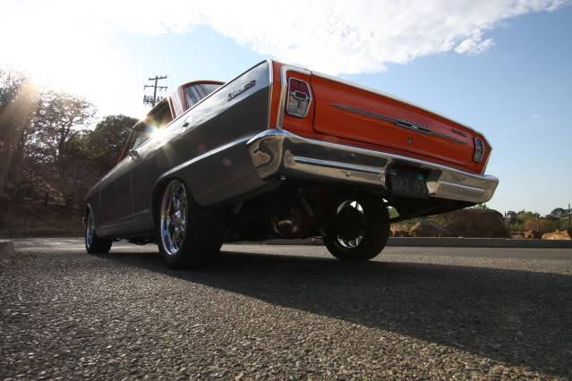

      ill get some better pictures on friday of all the suspension an some of the car off the lift.. most of the photos are older, the recent ones with them rims is when i did all the suspension work! thanks guys

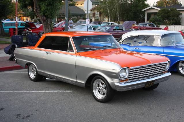

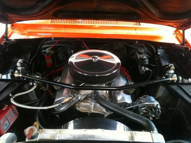

      update 1-2-12
      added the new tower brace bar today!

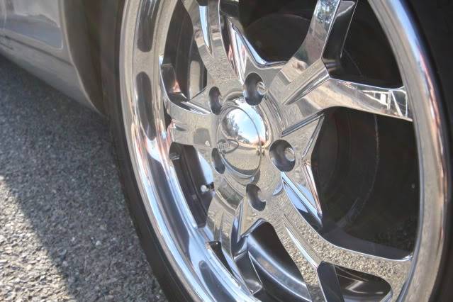

      I like the new wheels, the weld stars looked too small for my tastes, the new ones fill up the wheel well better.
      Windsor
      7
      Weld stars are too common. Keep it unique ;) Compliments on the paint combo.
