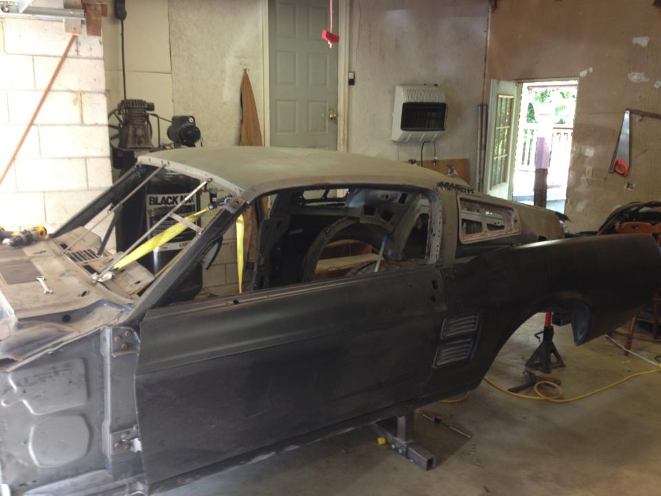

      been a while since i updated, since then i have decided to do a fastback conversion..

      NICE!
      But aren't the A Pillar's more raked on the FB than the NB?

      i thought i read the same once, but i think that's only the 69-70's. I measured my buddy's 68.5 r code and his rake was the same as mine, and the fb roof fit great!
