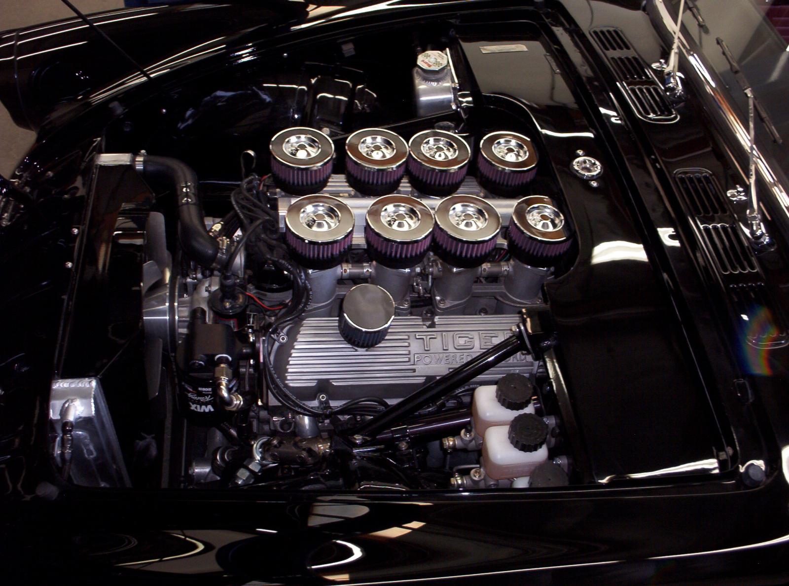

Size:  218.3 KBI have a TWM system for a 351w, new in the box, that I can give you a good deal on. Looks like Webbers, same system Rousch uses on their crate motors. I have this system on a 331 small block that makes 498 hp and 420 ft lb torque, great low end and mid range. Heres a pic of it installed on my 331. If you are interested send me a PM. WOW, sorry for the huge pic, I'm semi computer illiterate!

      Tiger I love that look and would love to use that but I'm not comfortable with that much linkage on a car I will drive a lot... my commute to work will.nearly put 10k a year on this car and I only work every fourth day so I do a lot of short trips and I just don't feel comfortable with that much linkage but it looks awesome!
