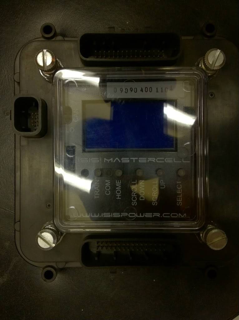

      We put it on a plate in what was the glove box area in the S71 Olds, sharing space with the FAST XFI. You open the door and it's right there, not recessed to save room behind it.

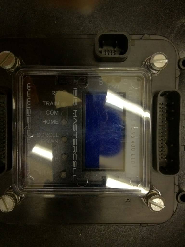

      Thanks for the reply. To confirm, was the master cell mounted horizontally or vertically? I was kicking around a similar idea, but not totally sure how to execute.
      ~ Jason

      I would like to know also Jason.
      I will mount mine on the back of the firewall in the center under dash.
      The first or the second. I have not had it fired up yet so I do not know which way the read out is?

      I'll post up a pic later today.
