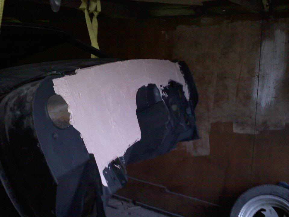

      i wasnt able to find anything so we made our own-
      https://www.pro-touring.com/showthre...pocket-or-brow
      Scotts Speed and Custom
      norcal1320.com

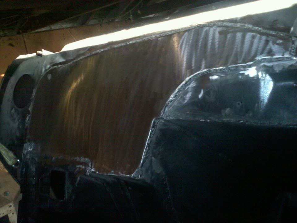

      I put mine in about a week ago and it looks good although I don't have any pictures now. It has a rolled lip at the top and I had to grind down about half way, then I used the closeout panel as a template to cut out the old firewall. I cleaned up the cowl area where the old firewall was and then plug welded the top of the close out panel to the cowl and then stitch welded the sides and bottom just like is shown in the pictures on post #4. $80 sounds a little pricey for a piece of 18 ga. but it was pretty close to fitting out of the box and I would go that route again if I had to.
