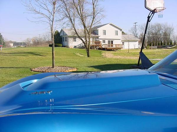

      Im looking to make a heat extractor hood and had a few aero design questions... I would like to utilize an L88 hood, and move the "hump" back a few inches to make for the air flow exit. My question is; since the hump is taller than the first ramp of the hood, will a high pressure area be created at my airflow exit and make the airflow area too turbulent for proper radiator airflow? I wouldnt be opposed to adding a small wicker to the front ramp to help create a vacuum if it was necessary.
      Also wondering how big the exit vent should be? Too big and exiting airspeed might be too slow, and too small might just restrict flow too much?
      Ideas or thoughts? Id like this to be as efficient as possible without making drastic changes to the overall design of the L88 hood
      Design of a regular L88 hood for reference:
      original picture (note hood bulge location)

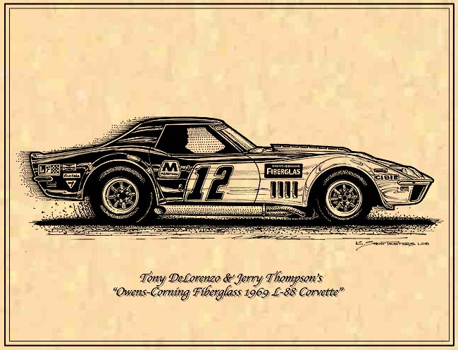

      If you look at that picture of the Corvette, you will see that it actually picks up air from around the ground and from the design of the air channel, it is directed up at a very good angle. That will not only provide some additional down force (and wind resistance which is not so good) but will try to push the air coming over the hood to come up, reducing the air hitting the windshield.
