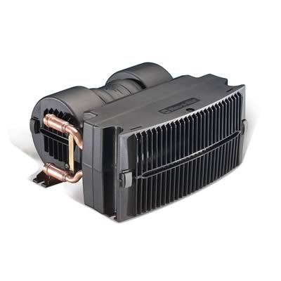

      This is not electric, but pretty compact. If you truly want electric, you may find something designed to go in sleeper cabs for semi trucks, so I've heard...
      http://www.summitracing.com/parts/FLX-640/

      I suppose I could use one of those compact set-ups and reroute the heater hose down along the frame.
      It's more to clean up the engine bay, trying to tidy it up from what it is now

      Think I'm going to settle for the smaller Mojave heater and try to hide the hoses as best as I can.

      http://www.heatercraft.com/ProductIn...roductid=1006H
      something like this would likely work just fine to knock any condensation off the windows....and a healthy treatment of anitfog coating likely wouldn't hurt either

      I ran a Mojave heater in my Pinto Wagon when the core took a crap. Got the add on for the defrosters too
