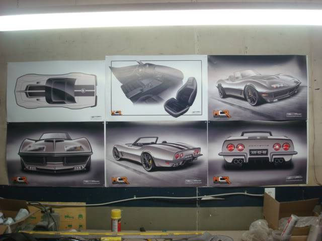

      Nice designwall........

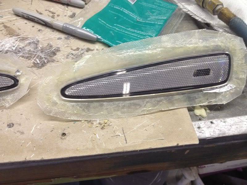

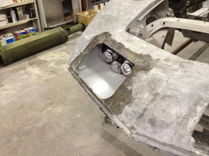

      Marker Lights
      Jeff made the buckets for the Marker lights.. He took a mold from a C6 and laid his own glass buckets that he will fiberglass into the vette body..

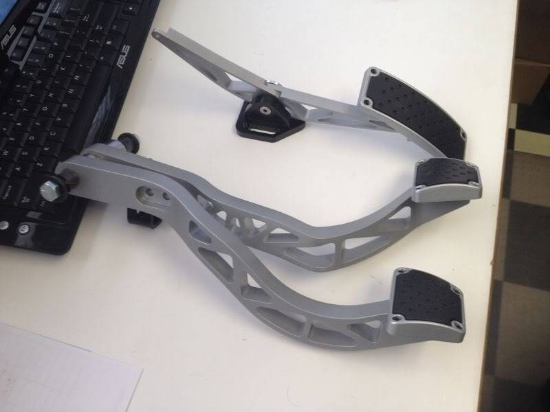

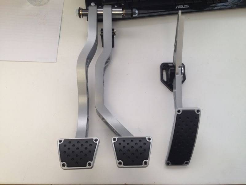

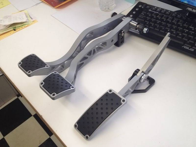

      Pedals..
      Here the very very beautifull Pedals from clayton Machine Works...
      I think its eye candy...
      Im thinking of painting them yellow to match the subtile yellow accents of the car (callipers, pinstripe, etc)

      Pedals....

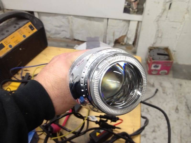

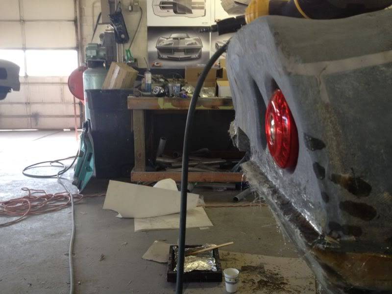

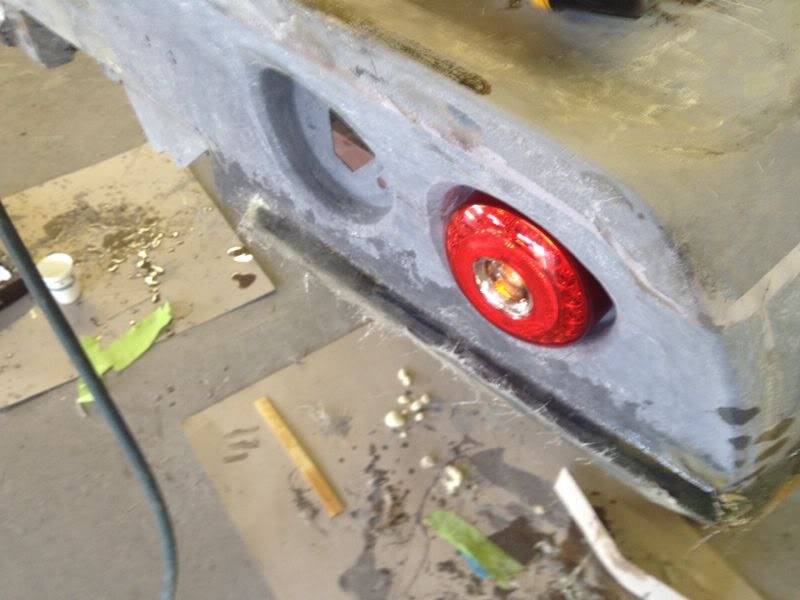

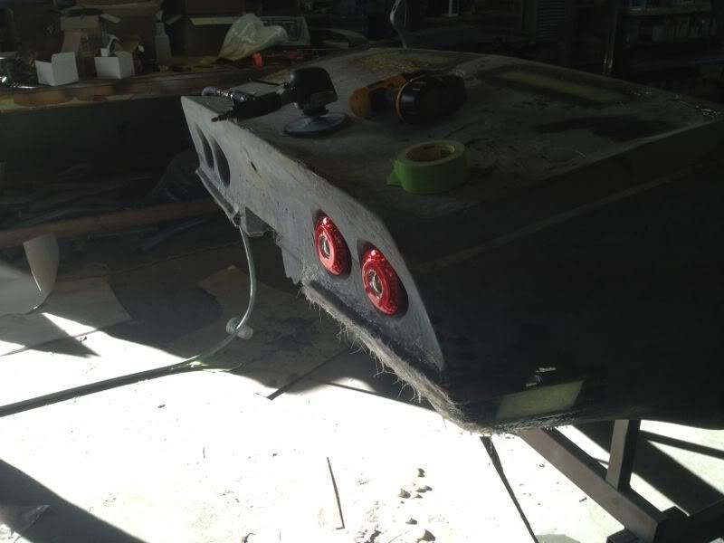

      Lights
      Here the way the Lotus Elise taillights will go in the back.. Looks pretty cool..
      Here the HID lights will get in the front

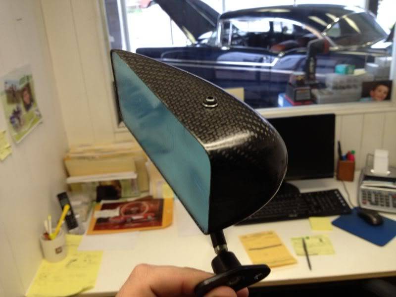

      Mirrors..
      Here, the SPA mirrors arrived as well....

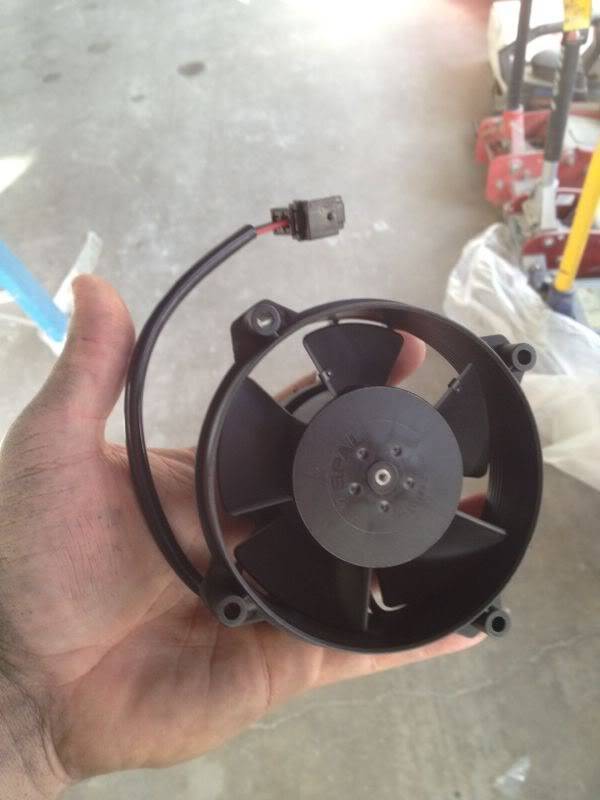

    12. #52
      Dec 2011
      102
      Country Flag: Netherlands

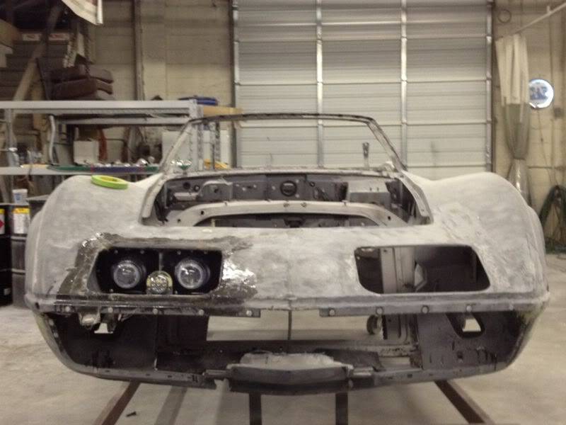

      First pics of the new headlight buckets
      Here are the first pictures of the Headlight buckets..
      Not finished yet and needs fyberglass sculpting..
      These lights are fully adjustable and replaceable... Think it will look bad ass when finished..
      Ill keep you posted here..
      gr, dennis
      Here also the fans that will come behind the side fender grills.. These will help getting the BB 632 heart out of the engine area..

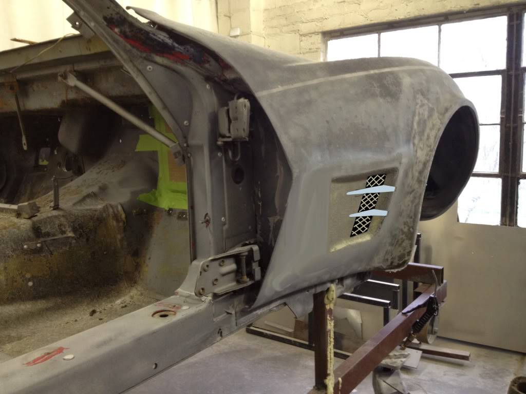

      Side Fender Grill Mockup
      Take a look at these.... Jeff sculpted the fenders. Then photoshopped the mesh and spears on to show how it will look....of course it will look much better when finished but you get general idea.
      Gr, Dennis
      Here how its was designed..

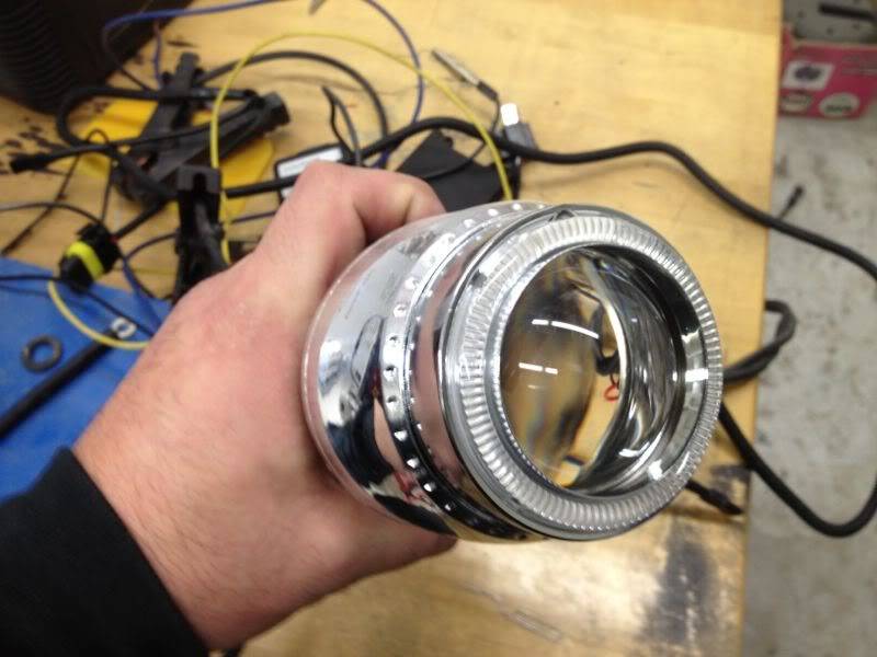

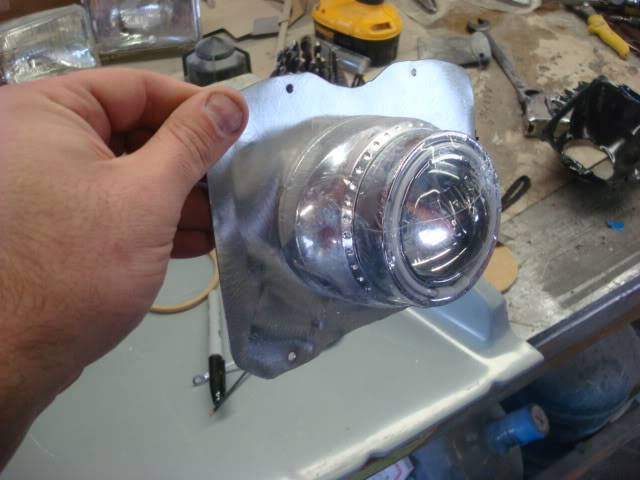

      Adjustable headlight update
      Adjustable backing plate for HID headlights.
      Mounting HID's in housing and then we will fabricate a 3D painted cover that these headlights will slightly protrude through. This makes them fully adjustable and easy to change the bulbs.

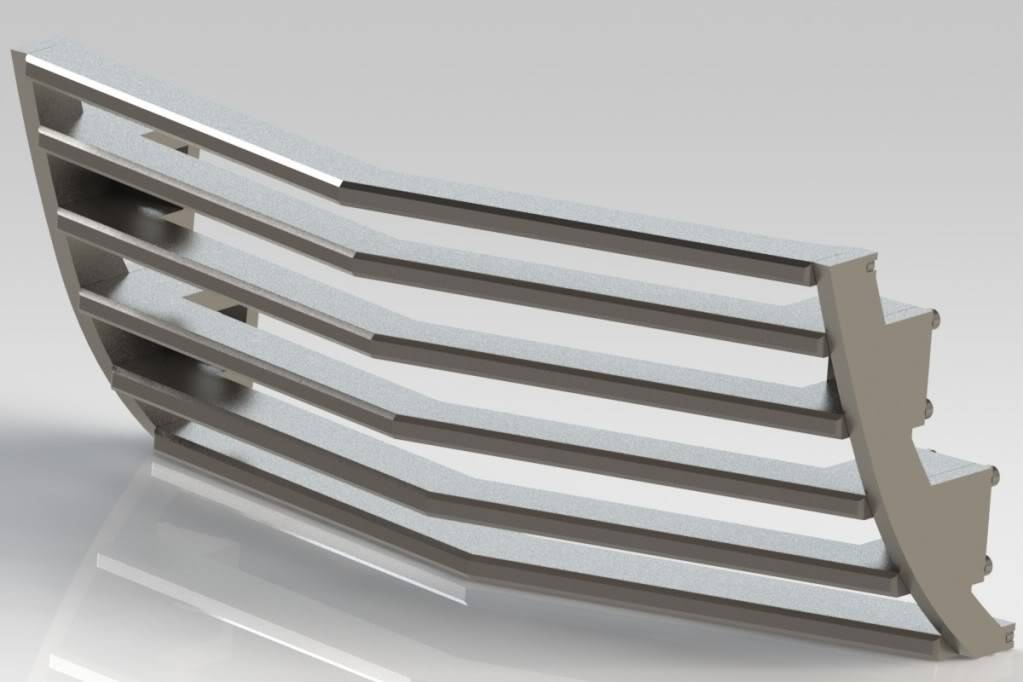

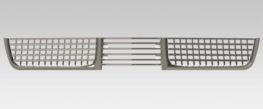

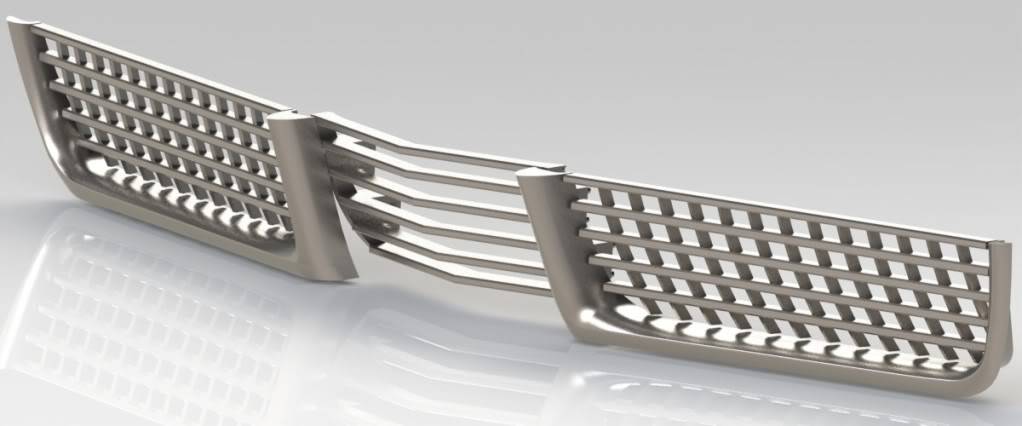

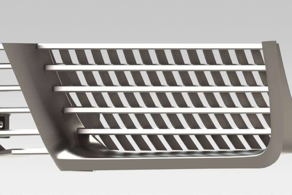

      Solidworks images of custom CNC grilles
      These eliminate the turn signals that are now in the headlight buckets and also the lower bumper mount. It also gives the grille a more bulky modern look.

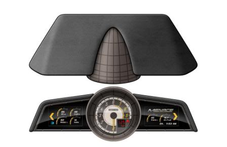

      Hi guys
      here some updated photos of the gauges... i wanted a bit more detail in the gauges and the center cone to be a real eye catcher under the front window..
