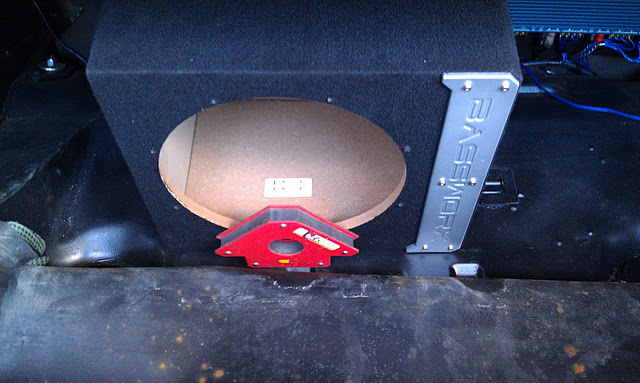

      Pulling back the carpet and trunk liner, I positioned the box where I wanted and held it in place with a strong magnet.

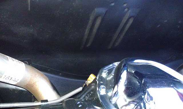

      Looking up from underneath the car and behind the rear axle, I used the dimples and impressions in the floor pan to judge where my bolt holes needed to end up. And then the drilling began.

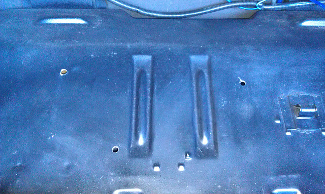

      Since the angle of the pan where the box will be bolted to will cause the box to lean backward, I wanted two bolts in the upper corners of the box and the third bolt centered and lower. As the car accelerates, the box would have a tendency to fall toward the rear of the car so I wanted to minimize the box from ripping through the anchors.
      I drilled my first hole with the box in place, put the bolt through it and then found the right spot for hole #2 and did the same. Since there's clear access to this area from underneath the car, it was fairly simple to judge where the holes would end up by looking at where the first bolt is poking through. Here's a pic of all 3 bolt holes in the pan looking into the trunk.

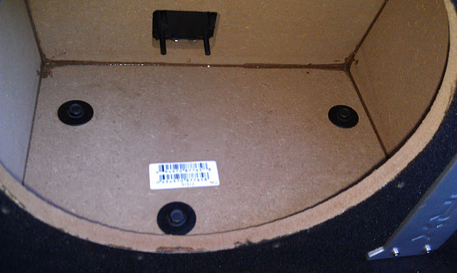

      Here's a pic of the nuts installed hand tight. Plenty of room to get a wrench in here.

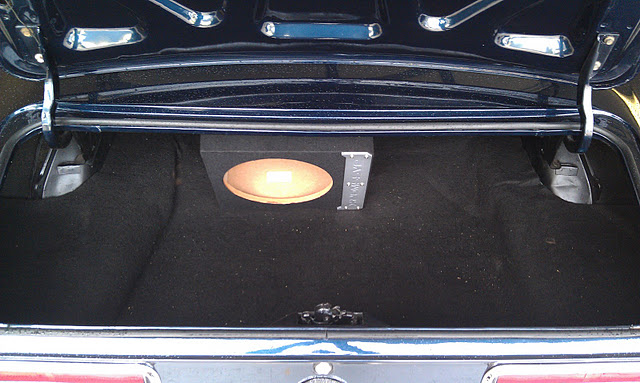

      All that was left was to tighten up the bolts and reinstall the speaker into the box. The finished product looks like this.
      There is significantly more bass sound coming through than just having the box sitting in the trunk. I have a subwoofer volume control knob in my center console and had to turn it down about 15% after testing the stereo. The box is extremely stable now. I don't ever see a need to have to remove the box to load the trunk so I'm very happy with the turnout. Hope you enjoyed.
