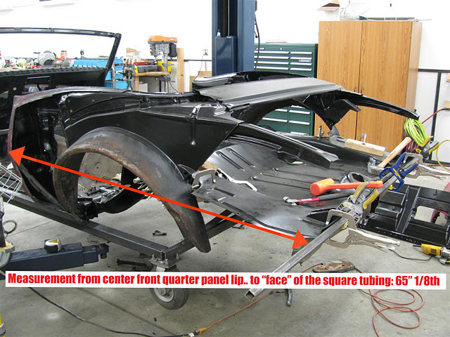

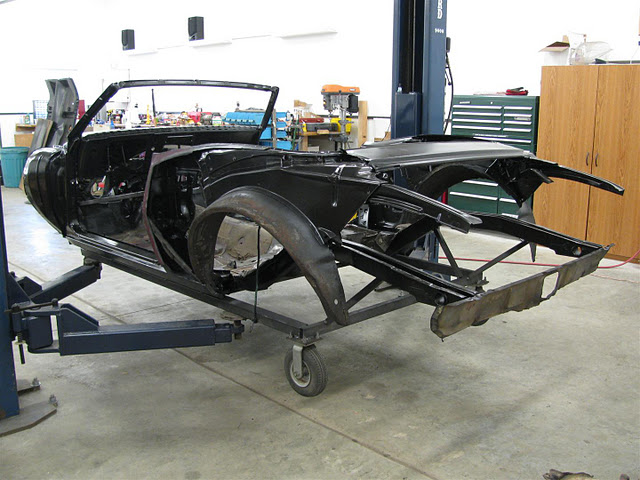

      As you can see I have taken the car down pretty far in the battle against rust… and am finally getting ready to put parts back on!! (exciting time)

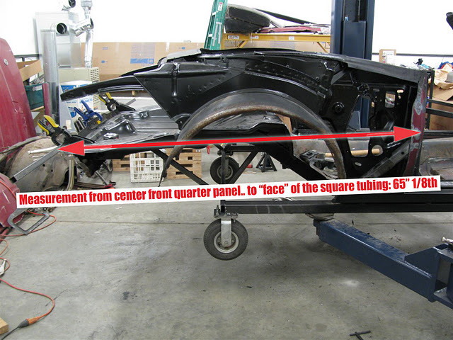

      With so much of the car gone, I find it a challenge to find places to measure from to make sure everything is true and square with the rest of the car.
      What I came up with was:
      Clamp 1” square tubing to the back of the trunk pan… (where the tail panel will be attaching) and then using this bar to measure from the front of the quarter panels (right in the middle of the door opening and back to the front of the 1” square tubing. I figured this way I know the trunk is squared up as far as the quarter panels are concerned. Right now it sits 65 1/8” inches back from the front quarter panel lip by the door opening.

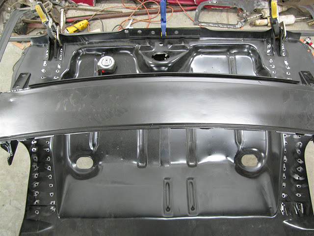

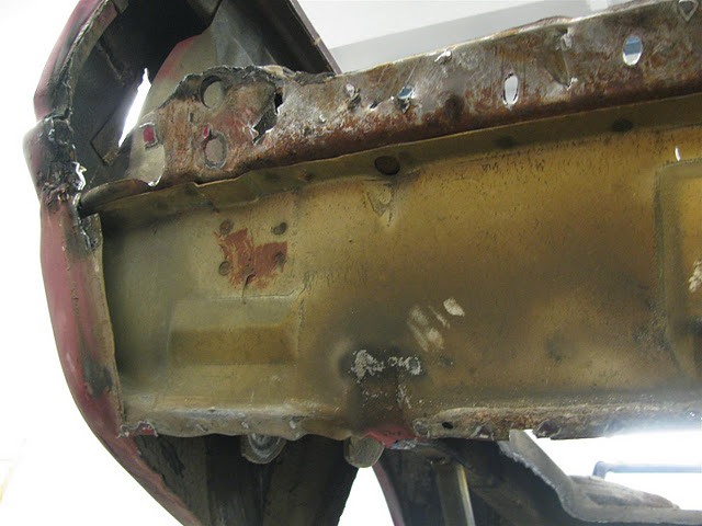

      I do have the original inner rear panel in place, but it doesn’t seem to help locate the exact placement of the truck for I can push or pull it in or out a good 1/4 inch also… I did take pictures of the "overhang" of the trunk floor to this panel... but not measurements
