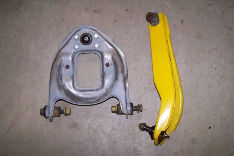

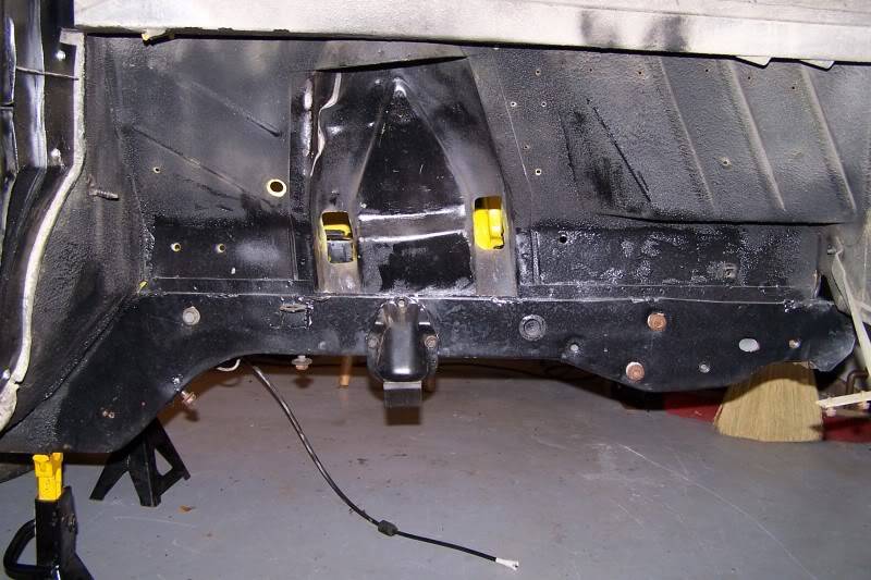

      Here's the stock suspension (former owner went a bit overboard with yellow paint)
      Engine compartment
      Passenger wheelwell
      Stock control arms

      I would suggest looking at the "build up" control arms available from the circle track industry. Basically a ball joint holder that you attach your own radius rods to. No reason you couldn't put a coil over mount plate where the spring pocket is now and run the shock down through the upper arm. Use heim joints for caster/camber adjustment. THis stuff is all relatively cheap. I'll try to find some links for you when I get more time, but I wouldn't be surprised if you couldn't buy it all from Speedway. Don't want to offend any site sponsors, but I doubt they have a lot for your application anyway!
      I'd look at going with a wider spindle track width (longer arms), and run less wheel offset and scrub.

      I would weld plates onto those stock upper control chassis mounts and cover up those holes and redrill where you want them. Let me know if you want geometry help.
      If your LCAs are horizontal and you are happy with the ride height I would keep the same chassis pickup points. For budget reasons, you might want to keep stock spindle.

      Your lower arms are what is referred to as "strut rod" type. LOTS of circle track arms available for those. You might even find a design that bolts right in to your lower mount.
      The upper arms can be made with bent rods (adjustment is a little more difficult) and no cross shafts. All you need to do is get the heim joints square to each other and they will bolt right in your stock upper mount holes. That is where I was referring to running the 1/2" heims. They are small enough that you might fit a couple alternate mounting holes in the stock brackets, if you so choose.
      To figure out the ride height, all you need is a front tire diameter. You already have the spindle and ball joint. Put the spindle back on the lower ball joint and measure from the center of the spindle pin (drill mark on the back side) to the center of the ball in the lower ball joint.
      Let's say that's 4". If you run a 26" tall front tire, the center of the tire (spindle height) is 13"... - 4" to the ball joint puts the lower ball joint 9" above the ground. With the LCA "level" at ride height, then the LCA mounting hole on the crossmember would also be 9" above ground. From there you can find the height of the rocker panel, bottom of the crossmember, etc. to determine if that ride height is acceptable.
