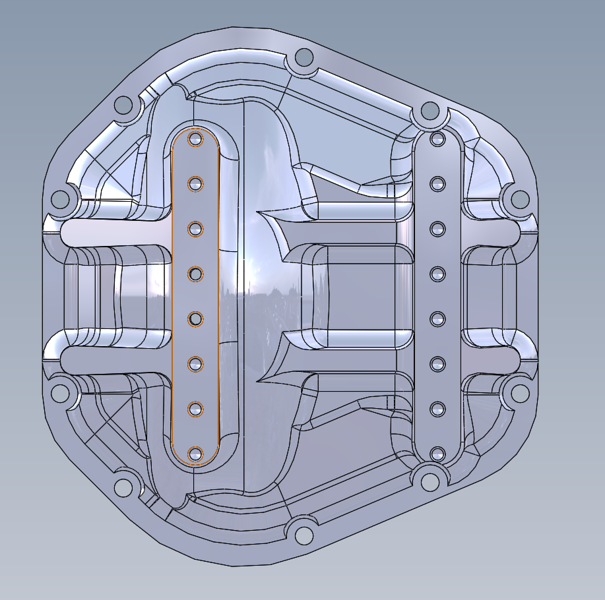

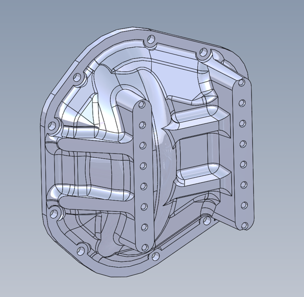

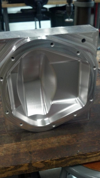

      The rear suspension in this car uses a watts link. In my normal knuckle dragging self, I welded up the watts mount on to the Dana 60 cover with a lot of adjustability, welding and warpage. After talking to Aaron for I long while, and looking at some of the cutting edge stuff he was doing. I decided to see what we could come up with in aluminum.
      Aaron started the 3d design work, and in my opinion, it is nothing short of spectacular. He just started making aluminum chips, and I'm not ashamed to say it gives me abit of a chubby. The contrast between my parts and his is like comparing a couple of paper cups and string vs. a cell phone. Aaron just has the one side done, and sent me the pics today, and I had to post them. Like magic.

      Looks great. I can't remember if the 60's have a drain plug in the casing, but if not, be worth adding one to the cover before you do the other side. Saves dropping the whole thing with the links each time for a service.

      You ever see some things that are so awesome that it slightly hurts inside.....cuz that just happened to me

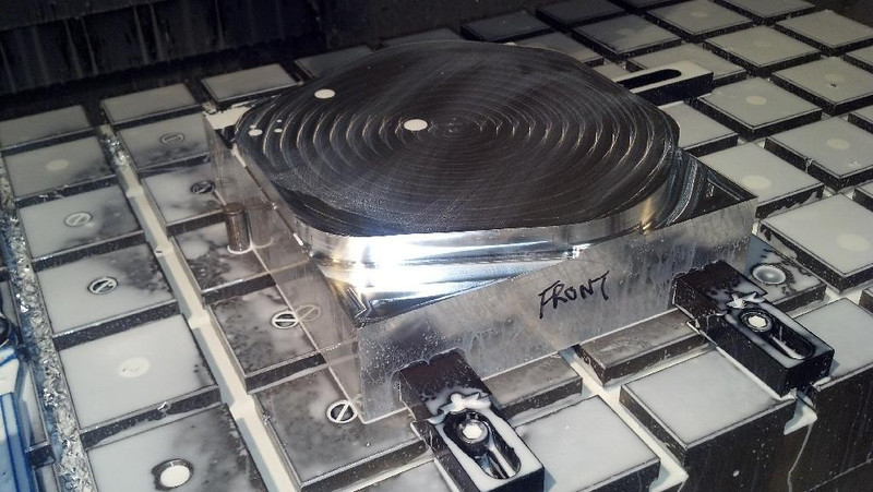

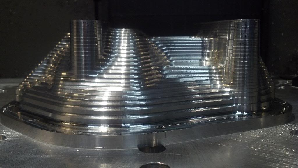

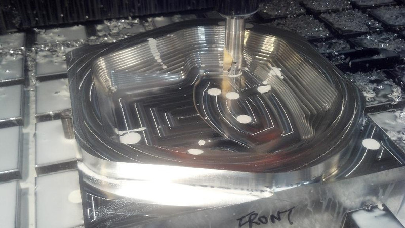

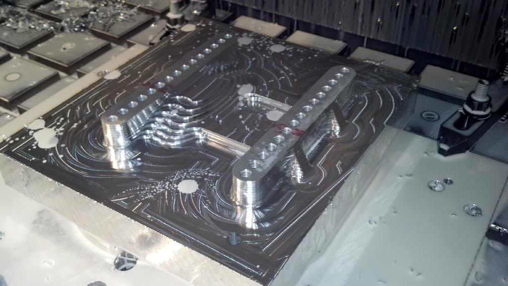

      Trying to get the outside profile cut today, but the new year is challenging me already! Nothing new, but our CAM software package crashes occasionally then won't let you get another license to use it for almost two hours for some reason. Have to have IT look at it.
      Anyway, Happy New Year!

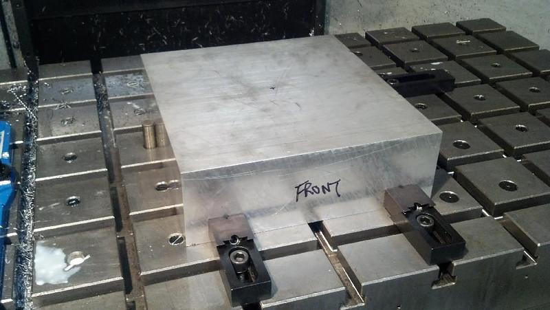

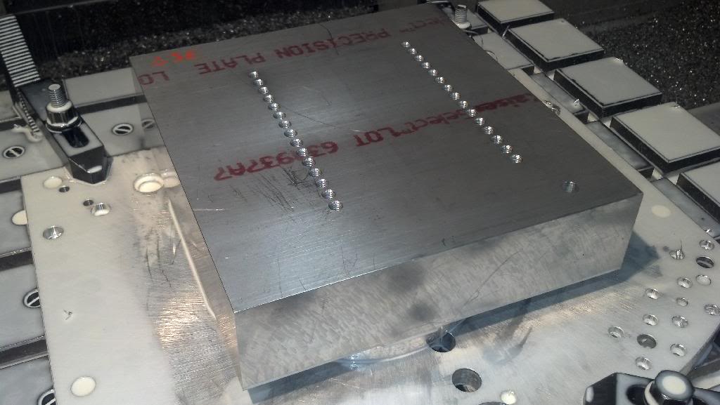

      Some may have noticed tapped holes in the mounting flange..how's that work? I tapped them to use them as mounting holes to machine the backside. They will be opened up to clearance holes when I'm done.
      So far today, I've drilled and tapped 30 adjustment holes and begun machining the outside profile. The roughing pass, shown below partially done, will take over two hours. The finish profile will take well over 4 hours. After that's done, I need to machine some additional bolt head clearance and add the fill plug that Ron wanted. He chose to not put a drain plug in.
      Enjoy
      Aaron

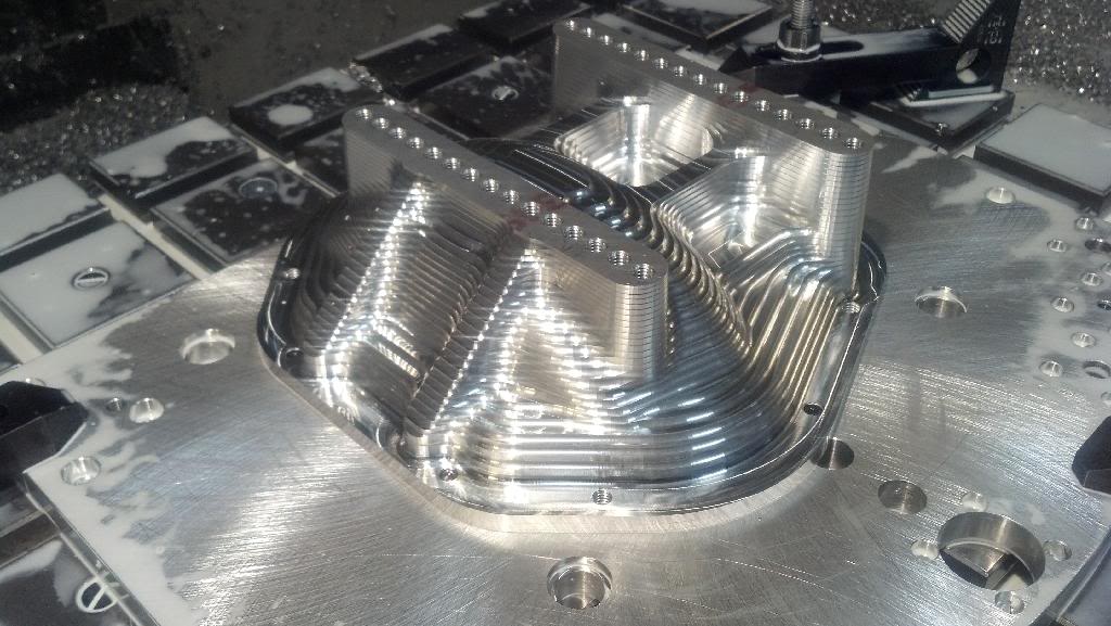

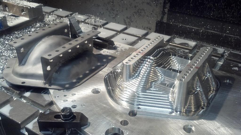

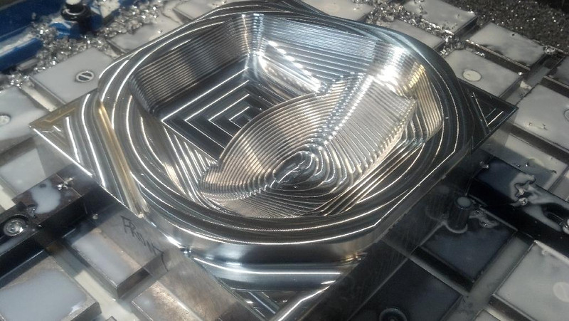

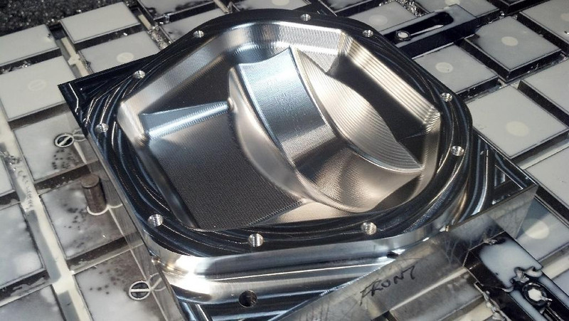

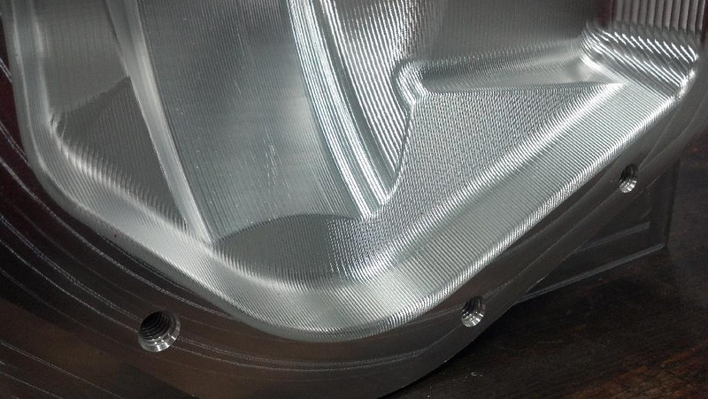

      Few more. Done for the day, got some family coming over...

      After the finish pass, it will be a lot less ripply...I think that's good?
