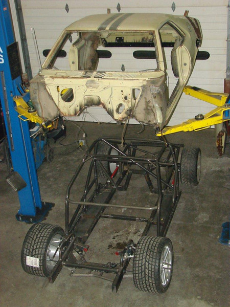

      Still crazy busy at work, drilled the spot welds yesterday to remove the front clip. Originally I was going to try to use the sheetmetal inner fenders and core support, but figure I might as well have a jungle gym in the front to match the one in the back. My new game plan is to make a new firewall which will be part of the chassis with pedals and column. I need to set the engine and trans back in the car to see how big the dog house will be, really hoping I can use the original dash.

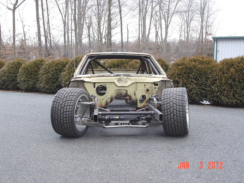

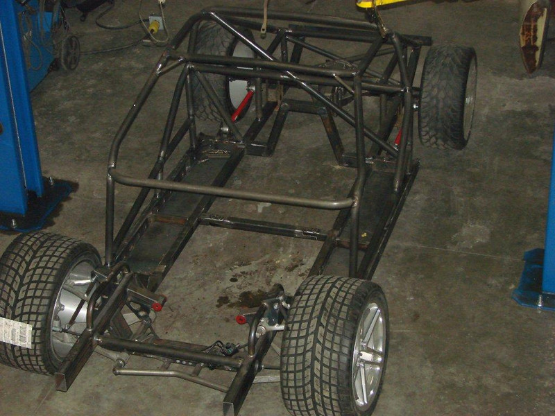

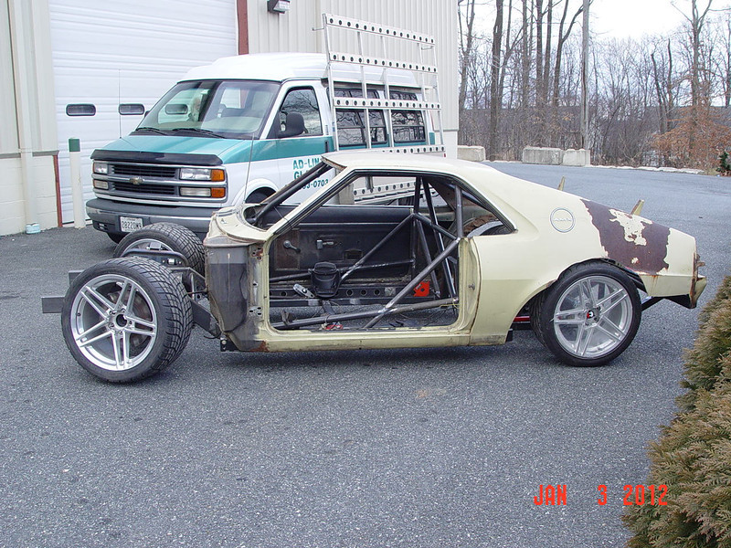

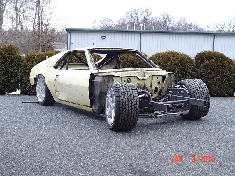

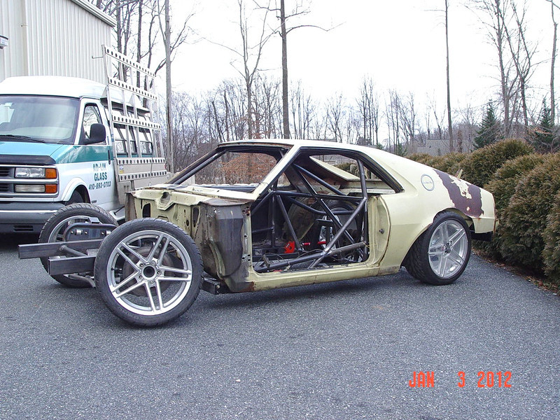

      The cage work is about done, lifted the body back off to finish welding. Will set the engine back in this weekend to run the exhaust, and get the firewall built. Big tires are mounted on the front, just has rollers on the back.

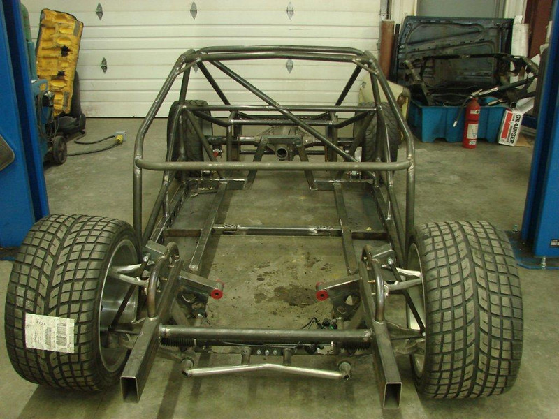

      A few more crazy pics

      Wow Ron! Just getting caught up and I see these insane photos. That's unbelievable, man this car is gonna be soooooo way bad. I hope that after lots of practice after I get done with school I can walk in your footsteps one day. Keep up the great work, you're an inspiration!

      Now don't take this the wrong way, but without the front end and with those huge front tires...

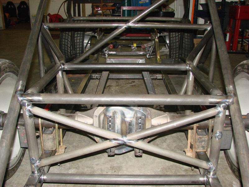

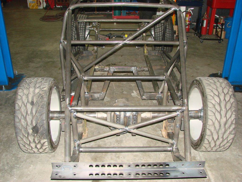

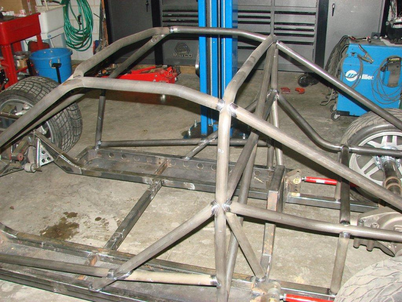

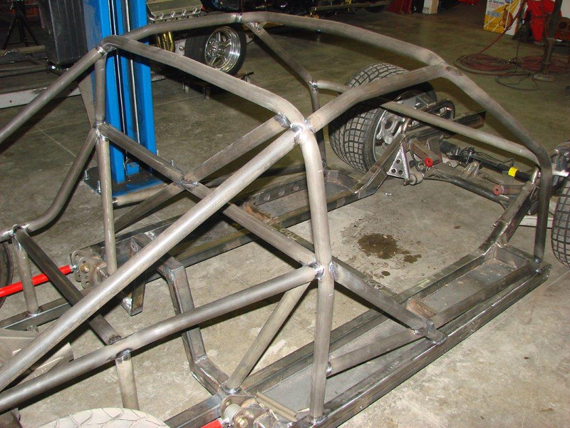

      People used to think I worked fast when I had 30 hours a week to devote to the car hobby (pre-children) but you are really gittin' her done. I would like to see some more x-bracing int he floor though, I know you have that torque arm in the way, but when I was doing my chassis' in Grape analysis, the x-bracing in the floor from corner to corner was huge for stiffness. YOu have those nice solid steel floors on the outer rockers but they are not tied together. If it were me I'd bring a tube from each "floor boxed corner" and bring them as close into the trans x-member as possible. Probably not even possible on the front but there is definitely room in the rear. Just a thought.
