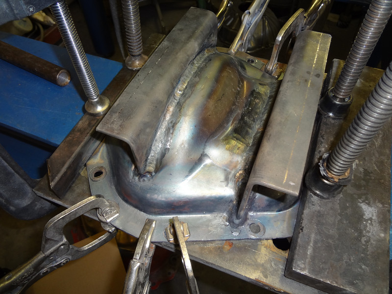

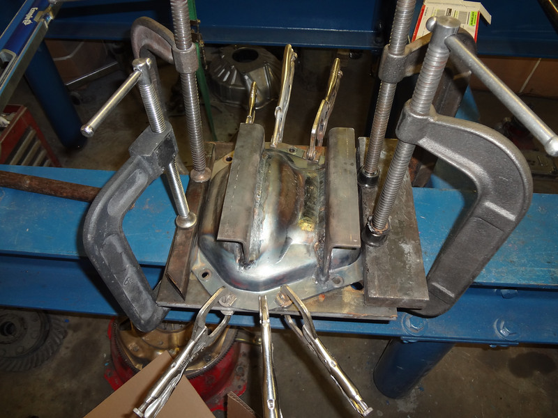

      Got the fins welded on the Dana cover, had more time straightening the cover then I did making and welding the brackets.

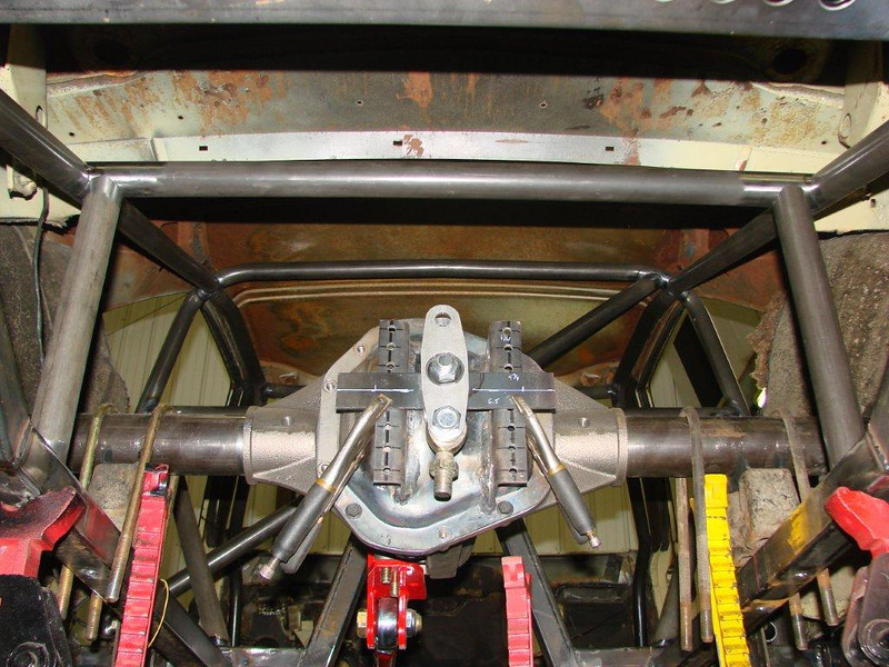

      They will get a series of holes on them, and the watts football will mount to them and should have several inches of adjustment up and down.

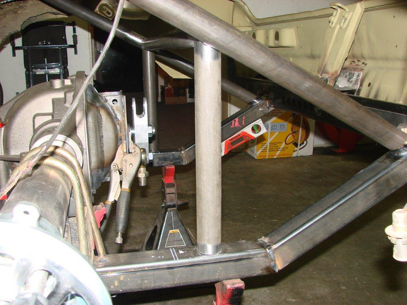

      Just something to think about, but from track experience with torque arm cars, we've found that swinging front mounts like this tend to produce bind under throttle. Basically, as the rearend is trying to drive forward on the angle of the lower links, the torque arm is trying to pull its front link into a straight vertical position. So, once the link is vertical, things are all bound-up. That said, because of this action, we found it to work best when the angle on the link was such that the top was further to the rear of the car than the bottom.
      What I've been mulling over on the TA suspension design I'm currently working on is to use a sliding front mount, to look very similar to leaf spring sliders that are used in place of shackles. If it's primarily a street-car though, probably won't make a noticeable difference.

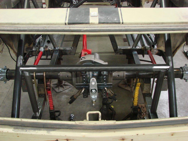

      Down bars are done, the door bars are next, and then the rear of the car is going to get real busy with tubing.

    16. #236
      Woodstock, Ga
      695
      Can't wait to see the chassis and cage setup with the body pulled back off. Should be a mean looking go-cart lol.
      Robert

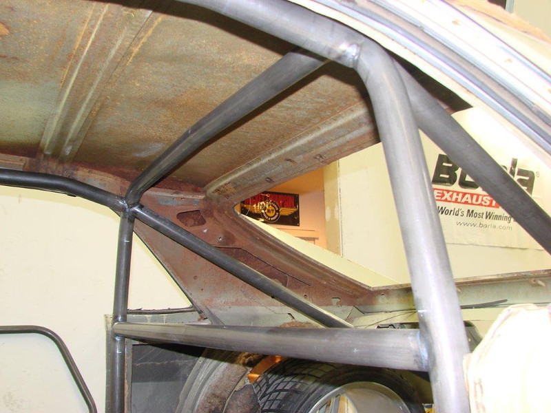

    18. #238
      Dec 2011
      Bel Air MD
      9

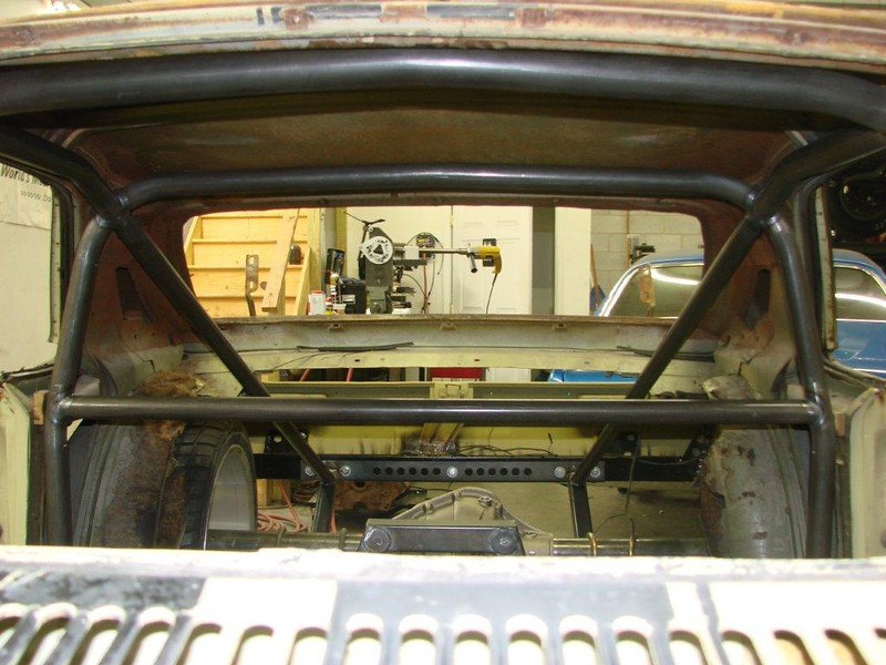

      Another odd view
      I love this pic, be neat to have this view with the body off. HINT HINT

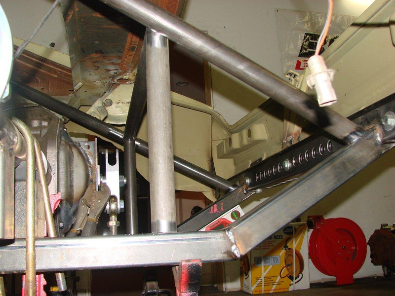

    20. #240
      Maryland
      1,863

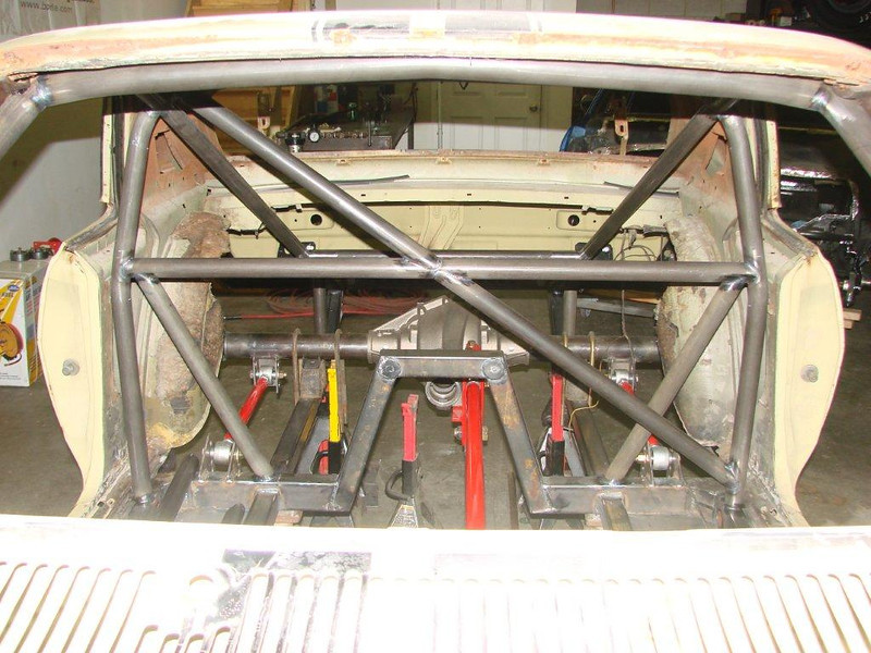

      Getting closer on the cage, and got most of the watts laid out. Have an X that goes between the watts links, and the door bars, and she'll be coming back home.
