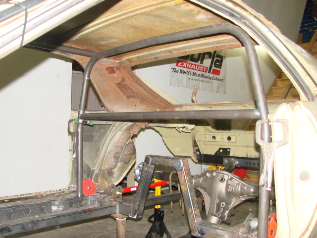

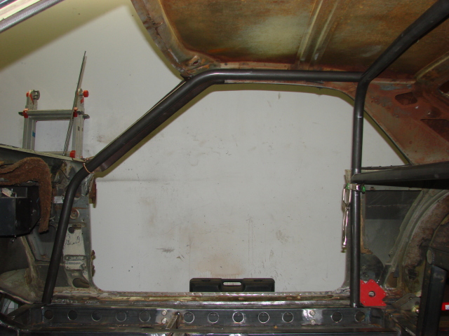

      Main hoop got bent and tacked in tonight, the front bars started, Looks pretty good, need to get the watts link calculated before I get the rear bars in.

      hey, I think your rear end may not be at the right angle
      LOL looks awesome

      How much room is above the main hoop? Did you get it all the way up so us tall guys and ride lol.

      Also, with the centerline of the rear end sitting so high up in the body the back of the trans will have to be raised up quite a bit to get the driveline angles right. Good thing you are making a whole new trans and driveshaft tunnel, cause it's going to be HIGH!
