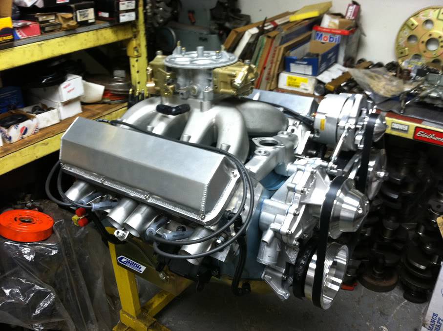

      Many of you have seen the white 73TA test bed platform for the yellow WarPath build, but what many didn't know is that we used the white for testing products and parts we planned to use in the final WarPath build...The white car has kind of been the redhead step child for a couple of seasons and late this year we broke that cycle....
      The car was treated to a host of upgrades that included a full Carbon fiber front clip (windshield forward),,, DSE sub-frame, a Nine inch full floating rear end along with top of the line Wilwood's on all four corners and a T56 Magnum 6 speed from Shafi....
      Now the final piece of the equation,,, the new 474ci poncho power plant.... this engine is sweet and will be a real wake up call for whom ever is driving on any given day in this car... The motor has the new CV-1 Canted valve Pontiac head and a custom built Jesel roller shaft system (first ever for Jesel on that head)and a ton of custom machine work performed by RP Motorsports and Astro Machine.... We'll be looking for about a 50-60% increase in power from last years motor and hope to Dyno it in the coming weeks.... Alike the WarPath, the WarPath Light will likely run the Holley injection system when placed into the car....
