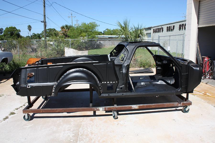

      Pictures always make welding a car together out of reproduction metal look SO easy, but how is everything fitting for you? I had a hell of a time getting parts to fit worth a damn on our '69 firebird convert. Full floorpan, and firewall extensions so far. Left me wondering if everyone else goes through the same thing, or if I just got some junk parts...lol

      Josh, yeah none of the repro parts are perfect. There is a lot of tweaking involved, but for the most part I have been pretty happy with the fit ! So in answer to your question your not alone !

      The first time I set the floor in place, I could stick my fingers in between the floor and the rockers the gap was so wide. I was like..."How the hell am I supposed widen the floor to close that up?!" haha

      Wow, one HECKVA project bud - good on you! Since you had no reference points for anything behind the cab - how do you get/keep everything aligned and make sure it's not off when it's all welded up?
      Chunger,
      Thanks , If you look at the pics you'll see we built a jig to locate the bed, and other jigs for tailgate spacing ect.

      looks great.... was looking at your jig for locating the floor/bed did you use the "risers" with the bolts to locate it... did you use those in holes that were from factory
      Thanks ! Yes, I used the factory locating holes.

      Thanks, The sheet metal is all Dynacorn. Fit is not too bad but as usual there was alot of modding to do !

      Fitting inner wheel houses , Quarters and doors. The contours look pretty good but I will have to close the gap !
