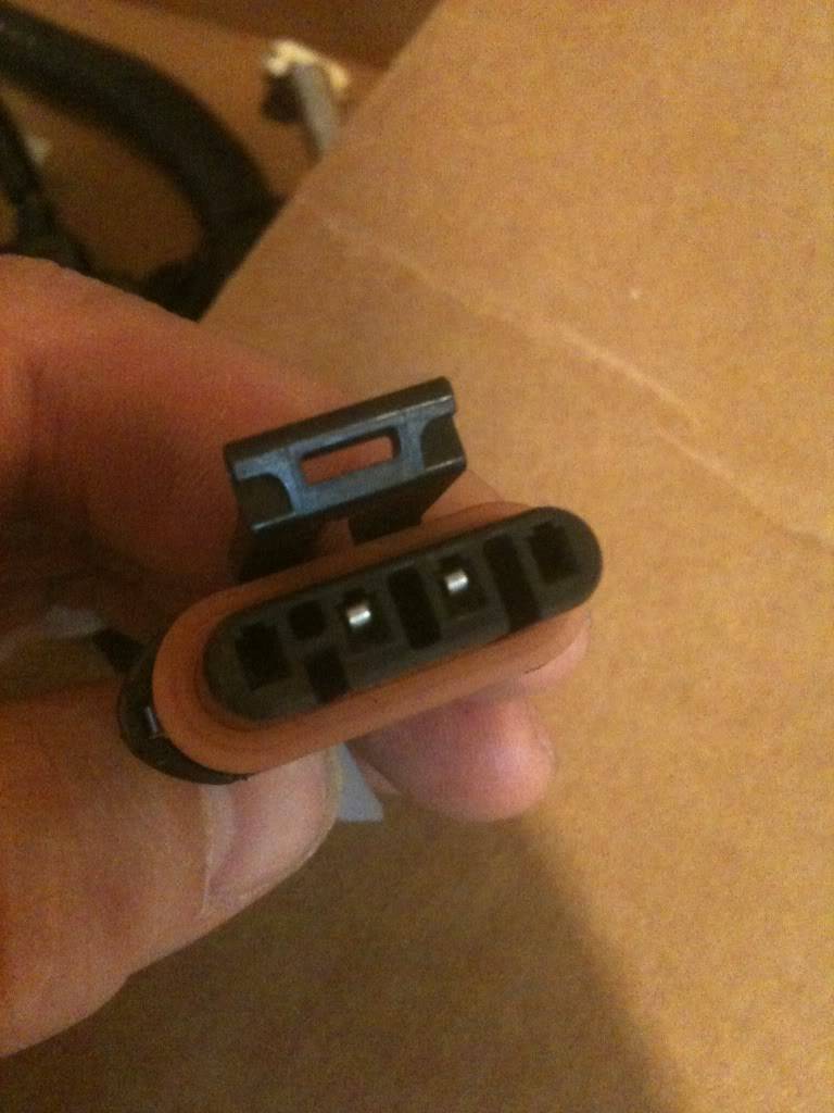

      I am trying to figure out what alternator to buy. I will be running a lot of electrical accessories,tablet PC,Duel fans power everything, hid lights...So I need a good alt. I have a 4 pin connector on my new harness from Speartech it is from a 2004 Corvette. I am also building the bracket so what should I get?

      That looks to be the connector for the CS-XXXD (CS-130D) Alternators. The alternator for the 2010 Corvette should work. I'd imagine the 2004 Corvette uses the same alternator. I'd double check with Speartech
