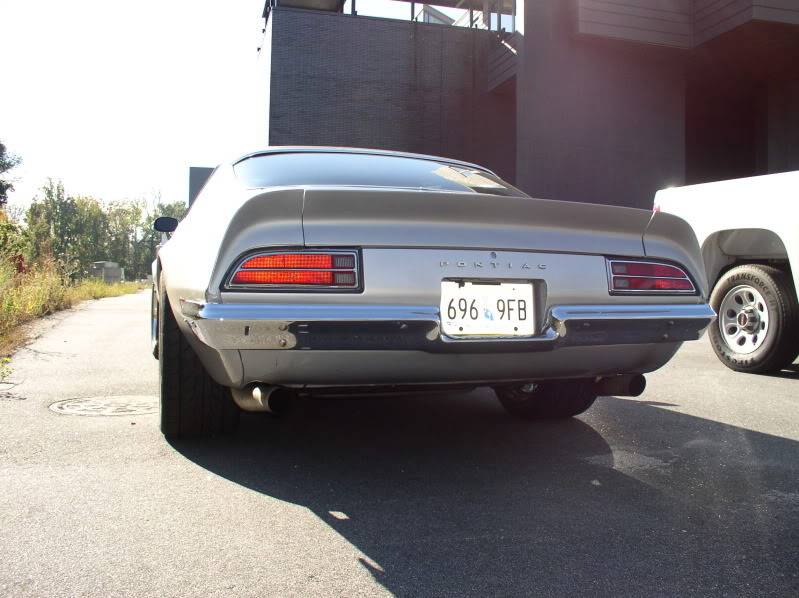

      I've got a '70 Formula with a 285/40/18 on the rear. I did have to flatten the seat belt hump, roll the quarter lips, and massage a few areas, but nothing major to make it fit. The later Birds, from what I've read, may have slightly less clearance than mine though. I would say a 275 w/ no problems, and the 285 if you don't mind tweaking it a little. BTW, My rear wheel is an 18X10 w/ 6.0" backspace. I would recommend 5-7/8 backspace though.

      Do you have any pics of your tires/wheels?

      Here's a couple..
      I need to get a few shots from directly behind the car. I'll try to do that for you.

      Very nice! I am thinking mine will sit a little higher, maybe an inch off the fender wells if that makes sense. I never realized how flat the rear windows were on the early 2nd gens.

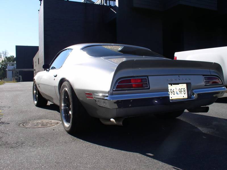

      I drove my car to work today, so here are a couple more. The springs are Detroit Speed 3" drop, but I think it still needs to go down just a little more.

      Thats about the exact stance I want
