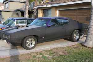

Size:  8.2 KBI few of you may have seen the original posting I did for the car, but here it is the official start of the thread. The project is going to be built and financed by myself but with special mention and interest to the MWR recreation department auto hobby shop. For those of you that dont know that is the Morale Welfare Recreation. It is a set of programs and services that are beneficial to the soldiers, sailors, marines, airmen and their families. As the build moves along I intend to use the car as a teaching tool to instruct those willing to learn on how to go about some of the aspects of building a car beyond the standard practices (oil,brakes,maintenance). Instruction that is not currently available. I hope to gather enough interest in the project that at the end I will be able to approach the MWR and have them bring about a program like this for all of the major military installations.
      I got the idea for the design while listening to the beginning of Voodoo Child by Jimi hendrix and looking at the Boyd Possesed wheels. So Thank you Jimi you did much for all of us!
      About the car
      When purchased:
      Original 1969 GTO with 35,000 original miles
      1976 pontiac 400 with a 671 blower
      stock TH400 transmission
      12bolt BOP rear
      Re-upholstered interior
      met. Purple/primer black paint
      Plans:
      LSx 403
      CNC heads
      MAST VVT SS cam
      ARP head/main bolts
      Forged cryo treated internals
      Twin 62mm billet wheel Turbonetics
      CX racing intercooler
      Custom stainless exhaust, engine mounts, oil pan, coolers
      6L90 Trans
      Shrifter six paddles
      aftermarket torque converter
      custom stainless oil pan
      Corvette C6 brakes
      Narrowed currie 9" rear
      Custom frame
      Curretrac rear billet upper and lower arms
      Fays2 Watts Link
      Adjustable QA1 coilovers front and rear
      AFX tall spindles
      SPC ultralight control arms
      SPC Tubular lower arms
      Hellwig sway bars front and rear
      NAPA premium steering components
      Hydratech Hydraboost balanced system
      Tom Lee quick ratio steering box
      Tom Lee power steering pump
      Custom stainless fuel tank
      CTSV pump with vaporworx pwm controller
      Bonspeed GTB /or/ Racer 2
      19x8 20x10
      Custom Interior
      G8 dash/console/pannels
      2006 GTO seats.
      -Shep
