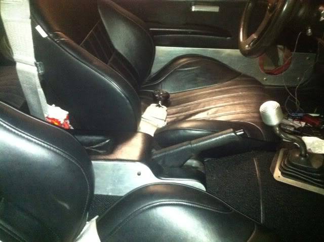

      I used a pull handle, lines, and brakes from an 98 Camaro. I also used the console from a 94 Camaro.

      I used one I found at Pick N Pull from a Honda (Civic I think) for $10. The black vinyl matches my interior good and it works well for me.
