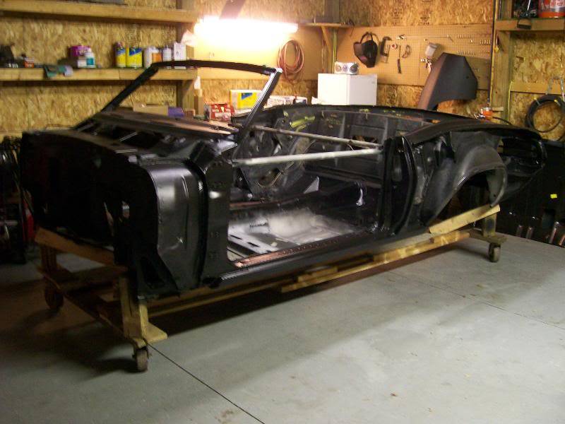

      Here's the dolly we built for our '69 Convertible. We needed to be able to transport it from my parent's house, to the sandblaster's (1.5hrs away) back to my house (in between) so I could work on it.
      I've been installing a complete floor pan in it, and thought the car would be ok given the bracing that was welded in (by the previous owner) but once I hung the doors to make sure the car wasn't bent or bending, I found out that it was indeed tweaked a bit. He must've taken the car apart, THEN welded braces in. I took it off the dolly and put jack stands under it to make a "level" surface, cut the braces out and rewelded them in place, and that did the trick.
      Just take plenty of measurements and don't skimp on the bracing!

      Thanks Josh, I was considering a wooden cart like that, are you bolted to the body anywhere or just perched on it?

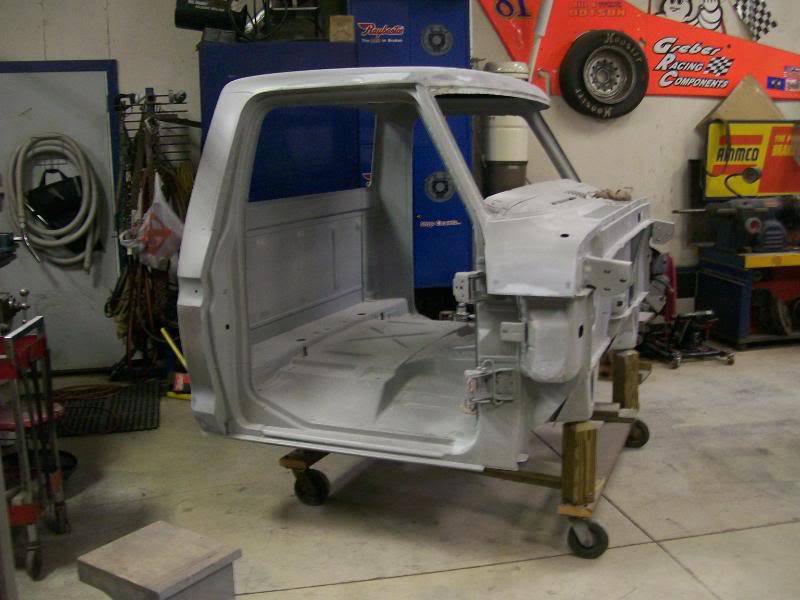

      Just perched on it. It's actually a dolly my parent's neighbor built for his '73 F-100. I did the body work on the truck and painted it, and after it was done, he didn't need the dolly anymore so I took it and we added some length to it.
