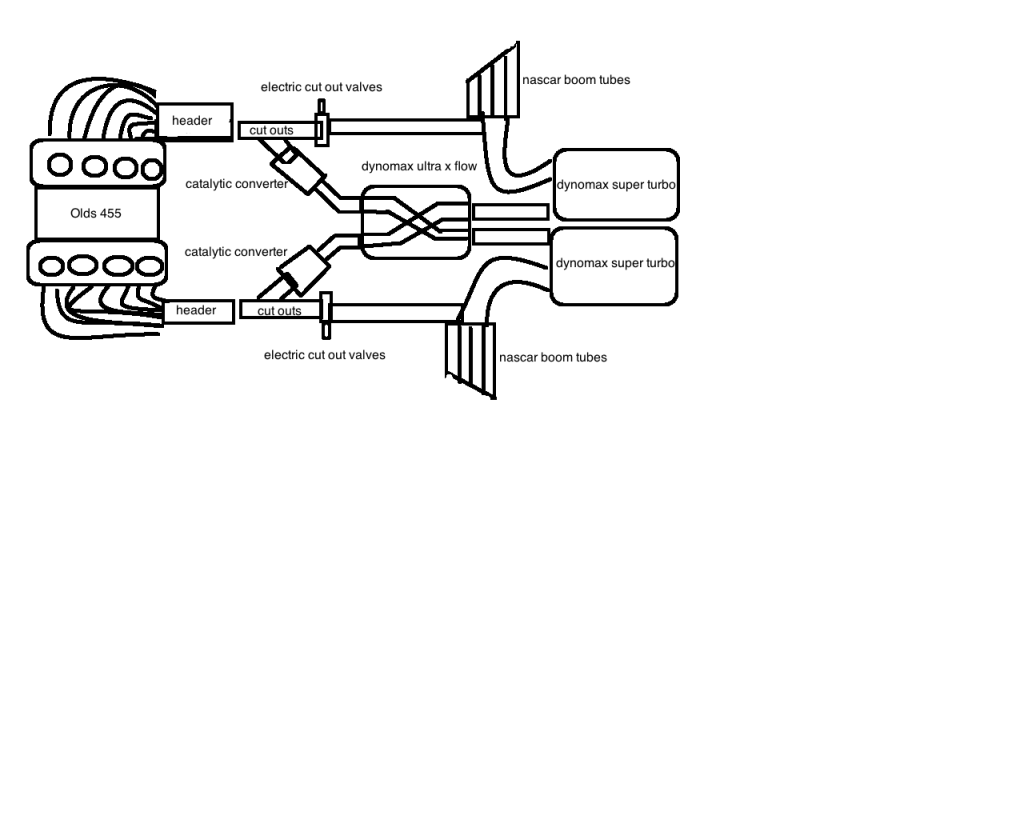

      this is what I'm planning on doing on mine

      Quote Originally Posted by hessdawg View Post
      love it just might have to stell this

      Quote Originally Posted by robertjra View Post
      It will be a while till I start on my exhaust, so if you do please post some pics

      I like hessdawg's concept. Might be a bear to package that with the IRS....not sure how much room you have. Even a big dual in/dual out muffler where he has drawn his x pipe and merging back to the sidepipes after will help quite a bit.
