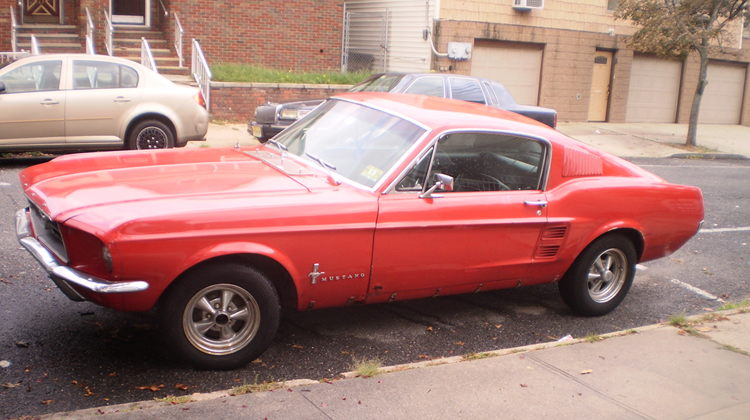

      Here is what my car looks like as of today
      It has rust issues in both the rear quarters behind the wheels, driver side door and driver side fender, also behind the wheel. This will be my daily / main car. I bought this car because I love the style, not to be sitting in a garage %99 percent of the time. Since it is a daily driver I plan on upgrading the basic safety aspects of the car first. I have ordered the Wilwoods 12" drilled and slotted brake kit. People have told me to avoid the drilled rotors because as is stated in the Wilwood website " A drilled rotor provides the same type of benefit, but is more susceptible to cracking under severe usage; however, for street and occasional light duty track use, they will work fine". Im more interested in the latter part since as I said it is a daily driver and I'm more interested in looks (I hope that didnt turn some of you off) I had to get bigger wheels because the rotors would not fit with the Cragars I have on now. So I got these 17x8" wheels
