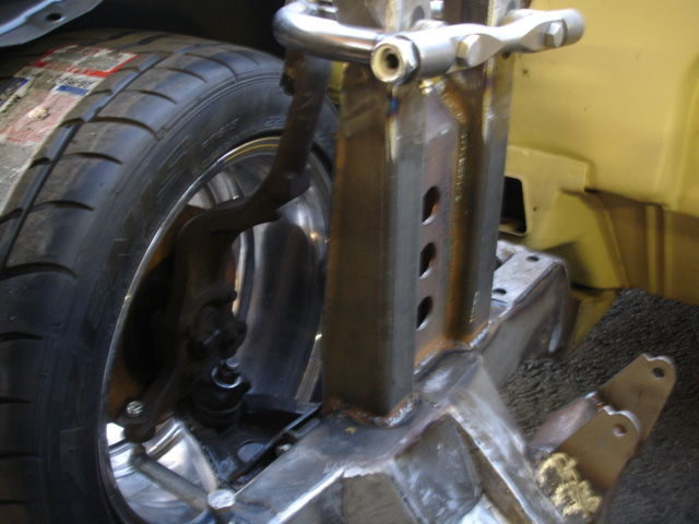

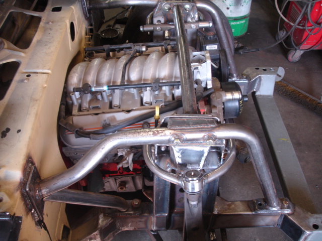

      Maybe Ron will see this thread. He has the front suspension fabbed up on a 68. I will get him to post up some pics for you

      Its been a while, but here were the pics that were on Lateral G

      Here is a shot of the funky set up.

      I think that is pretty nice. Looks good. Do you like it and recommend doing it?

      Quote Originally Posted by wd69ss View Post
      If I ever finish it, I think it will work very well. Limited applications though, the upper control arms are so high, that they would pop out the top of my hood on the Mustang. That car started with a Fatman subframe, when I got it it was such a pos, so out of square that I had to cut it up to square the body mounts and suspension points, and it kind of snowballed like everything that I do. It is doable, but it would be easier to call Detroit Speed or Jake, (which weren't avalible way back when)
