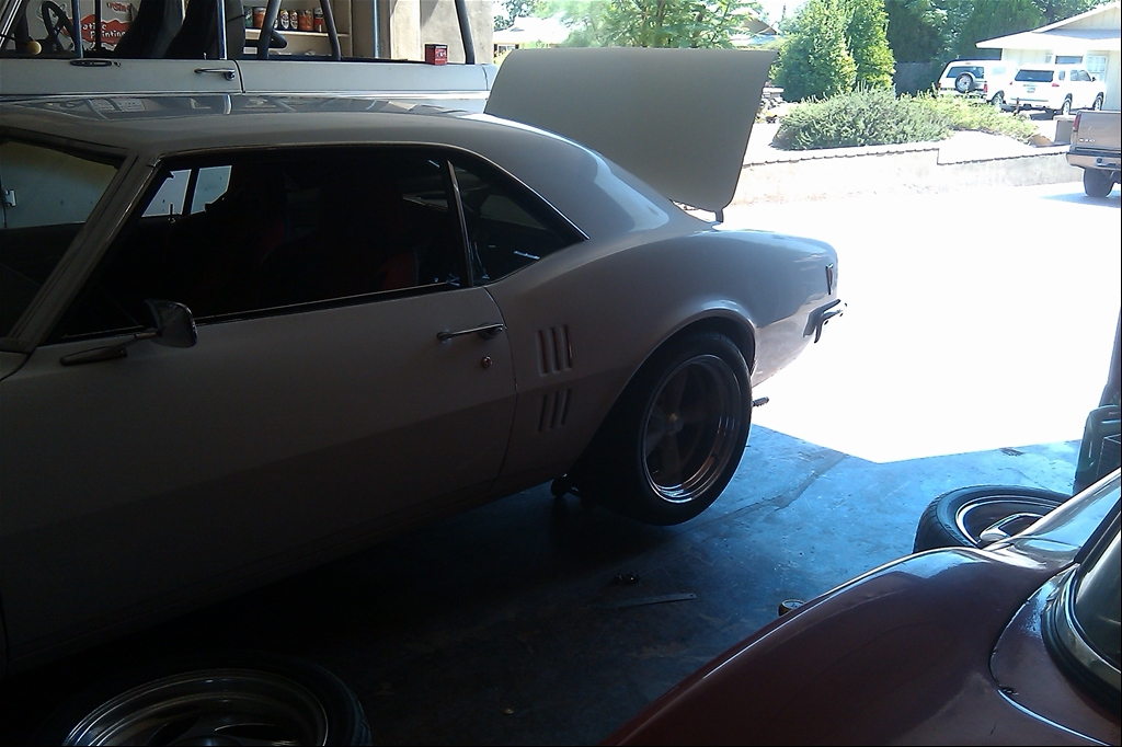

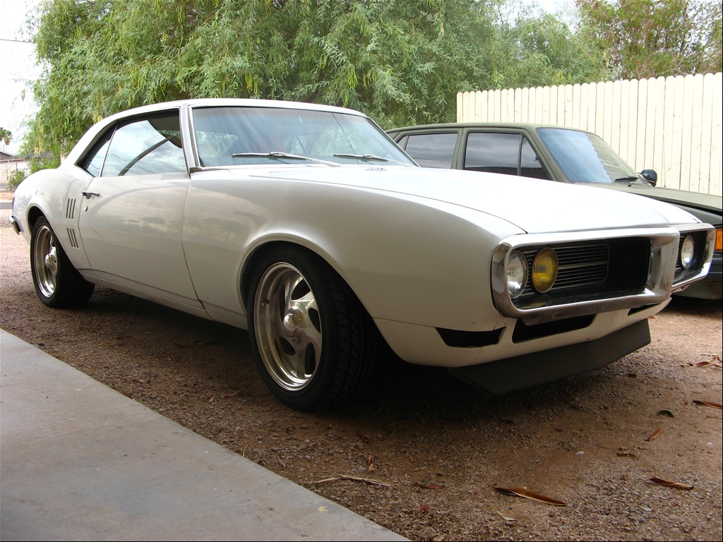

      I tried on some wheels and tires this last weekend that just confirmed that its time to update the look of the car. Im leaning towards more of an old school look for the car, most likely Vintage Wheel works V45 or V48 wheels in 17x9 front with 275-40-17 and 17x11 rears with 315-35-17 tires. The rears in these pictures are 315s. I need to figure out how to photoshop the V48s on the car so i can see which ones I like better.
      I think the bead blasted 5 spokes are an improvement over the wheels that are on it now.

      Nice build! Love the new wheels... the yellow lights are a nice "trans-am" look too!
      I remember when your old style wheels were popular...haha, I actually had a set on my chevelle for a while.... my how the times have changed..haha - good luck with the upgrades!
