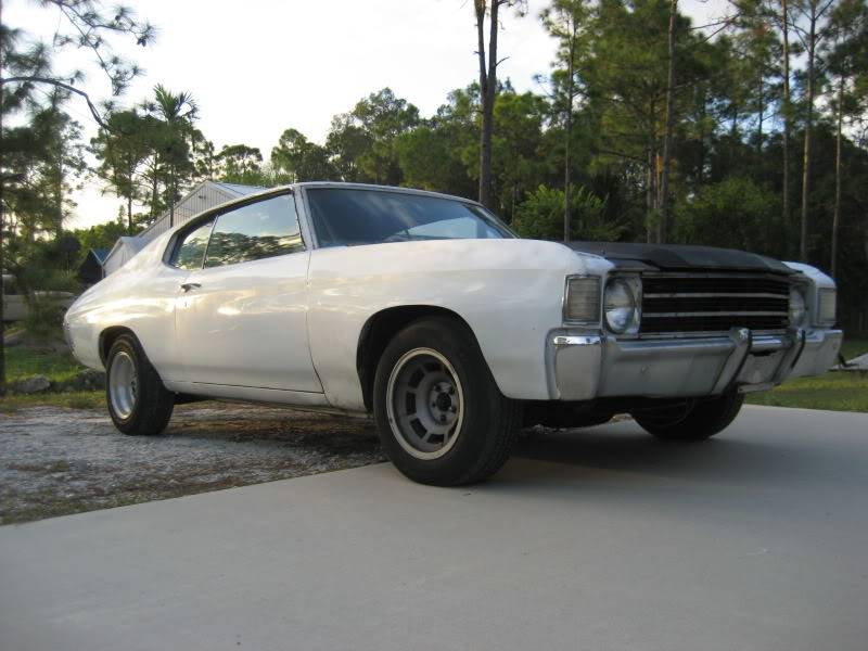

      Well hello everyone and i appologize for my lack of time on the computer! my name is tim but everyone calls me zip. I started this project with a friend almost 2 years ago now. it was going to be a mild makeover car to flip. My friend was fronting the bill and I was to do the concept and build. After about a year and a halfs time and still having a long way to go, it seemed to be less like a flip and more like a personal project. My friend did not mind the timeline thus far but i just didn't feel right about having his money tied up. I knew that with my new baby boy here that things would only slow more. Lucky for me I have a great friend, Shawn Marasco with his own custom shop in Orange City, FL. It's called Rockstars and Custom Cars. We used to play in a band together and had even taken autobody class together in high school. Well now with his new shop i asked him to take over the project build and handle the frame, suspension, motor, and body completion. basically, from this point, I will be handling the concept and reassembling the car. The car was a malibu 350 that i decided to go freestyle on. I decided to do a sort of "what if" chevelle being they never made a rally sport. i am incorperating some of the key styling features of an rs but not all or limited to. like I said...FREESTYLE! I will reveal those feature as a make them! lol I also figured what would be more perfect for a rally sport than a real performance package pro touring build. I want to keep this car a true driver with show and peformance capabilities but not go too overboard trying to make it more for a track. It will be made mostly for comfort, styling, and reliability. So now that I have truely bored everyone to death who has made it this far... here are some pics... i'll probably screw something up with the link so please inform me.

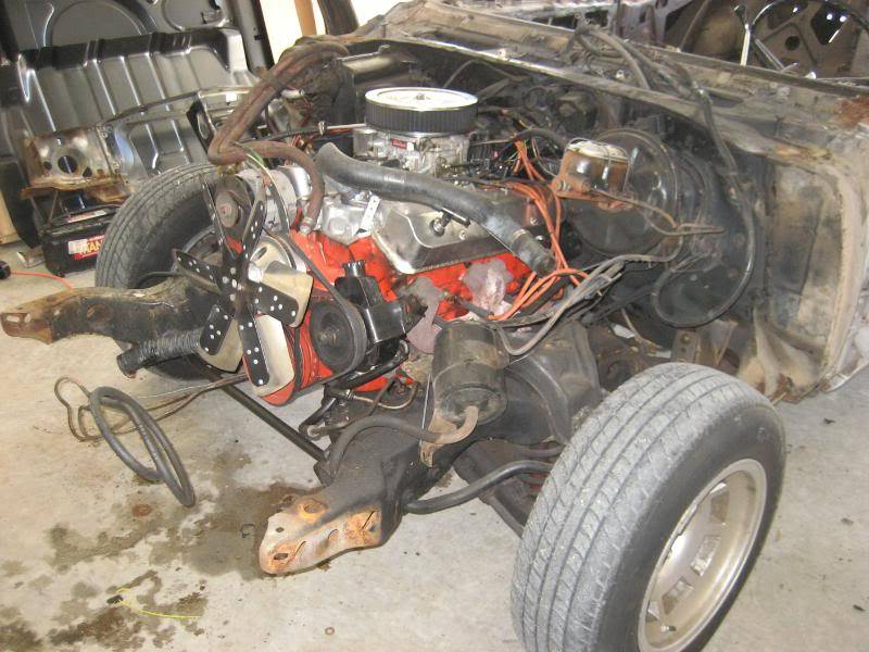

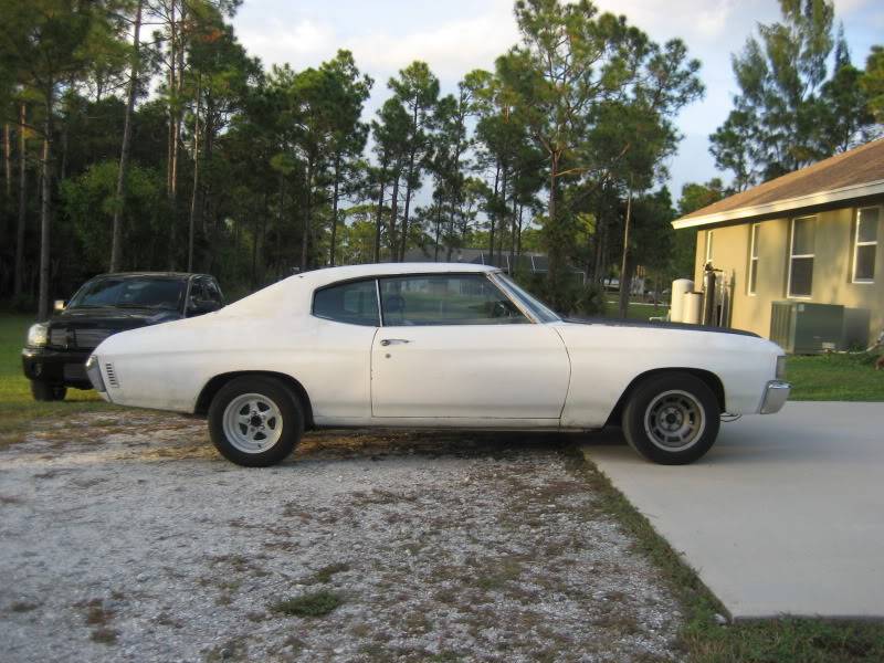

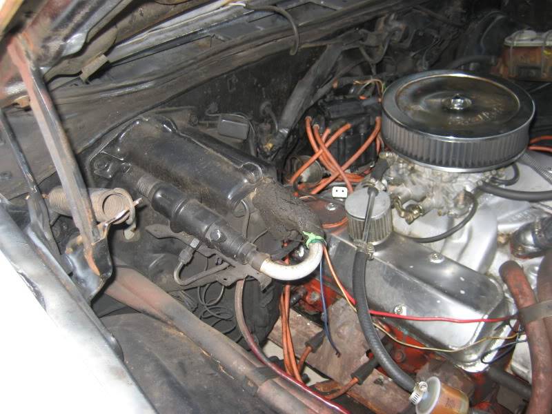

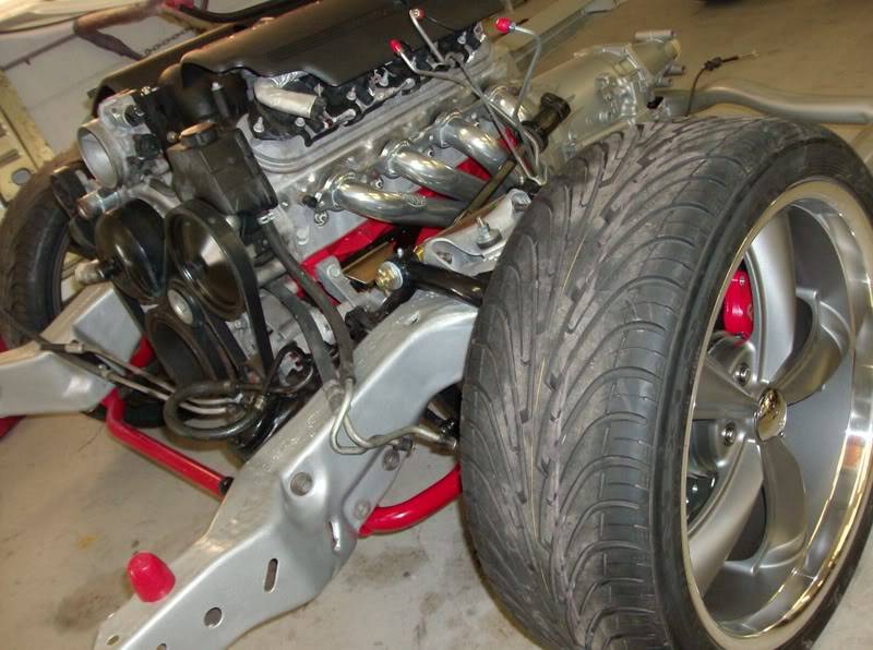

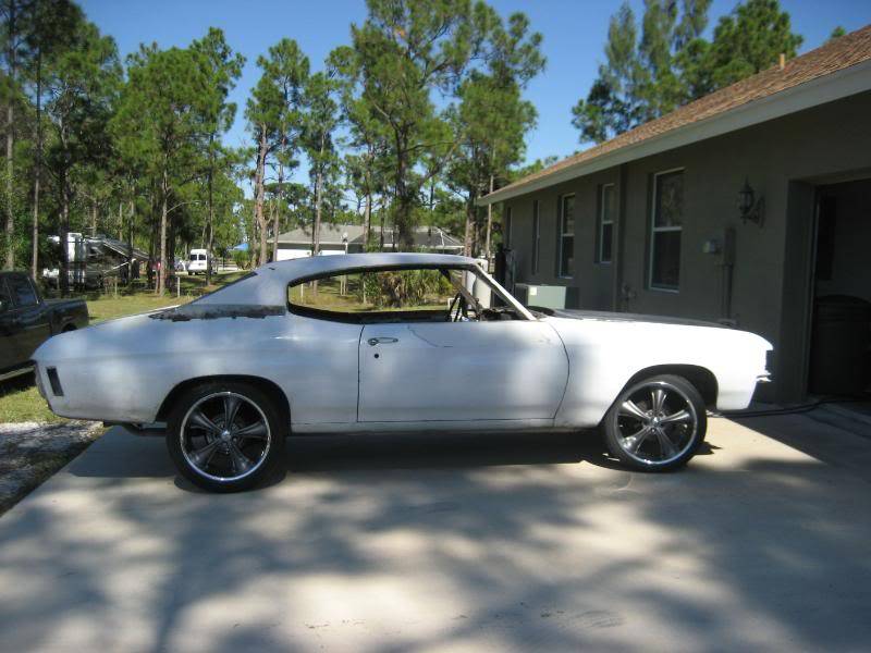

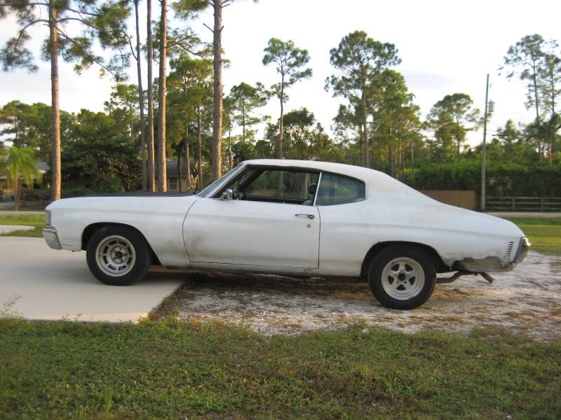

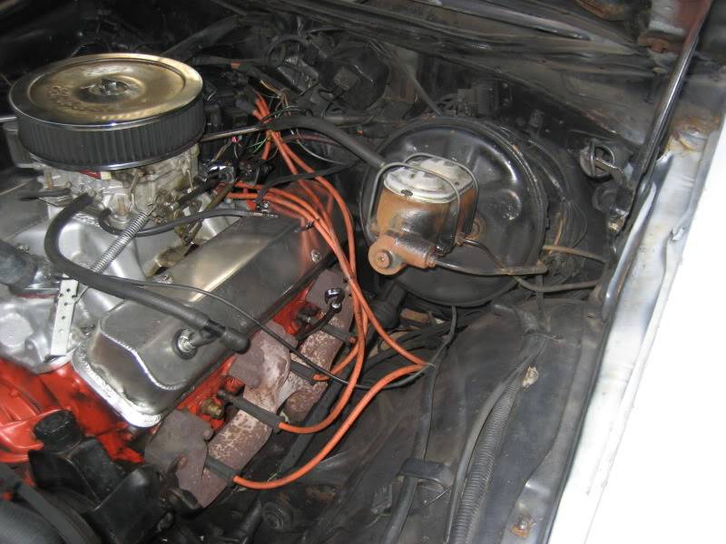

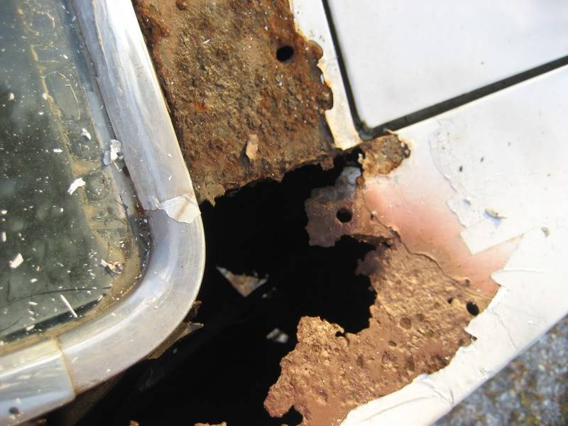

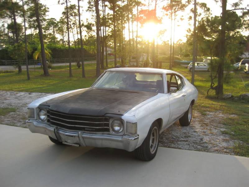

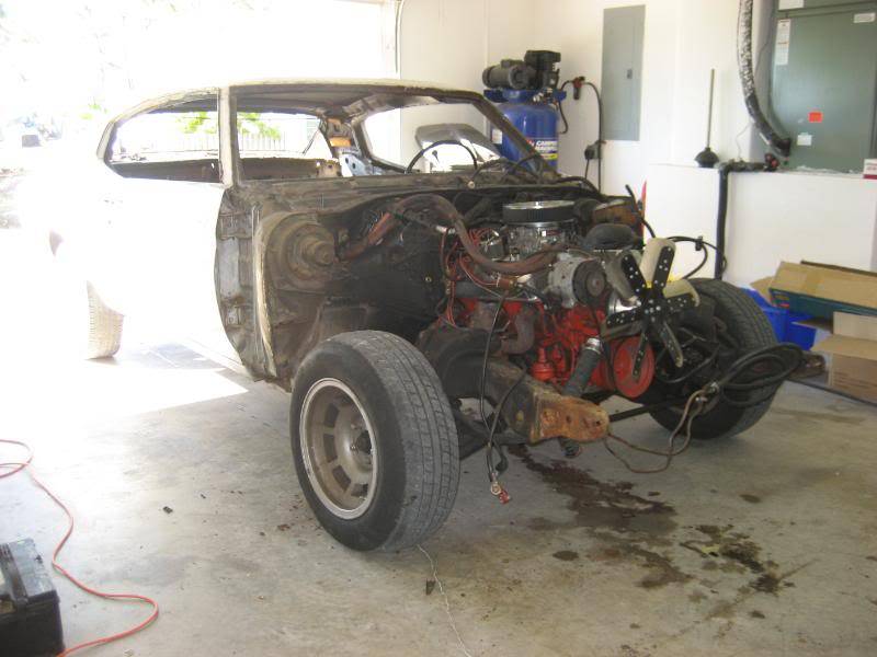

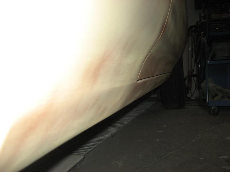

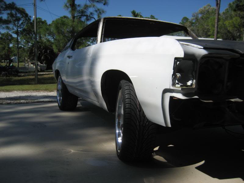

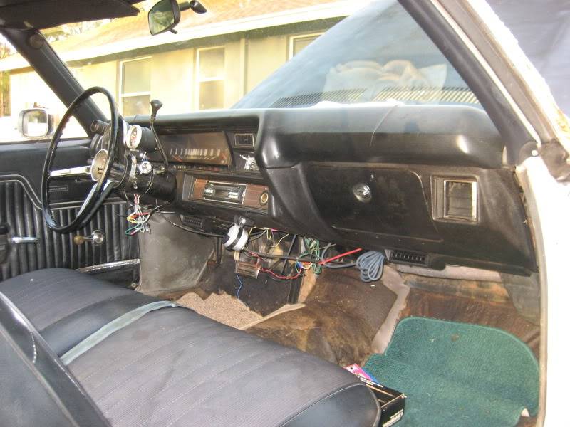

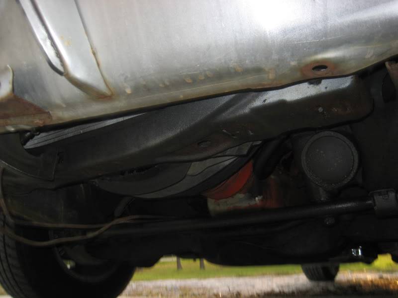

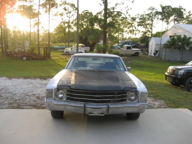

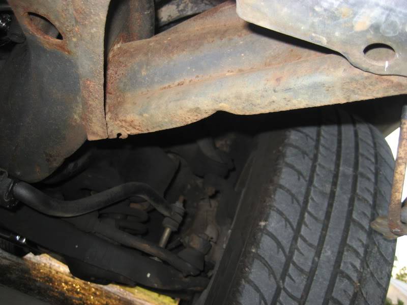

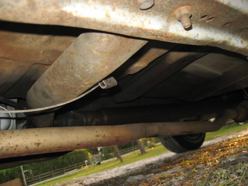

      Negative Ghost Rider here are the pics

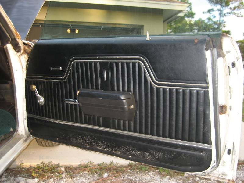

      Underside

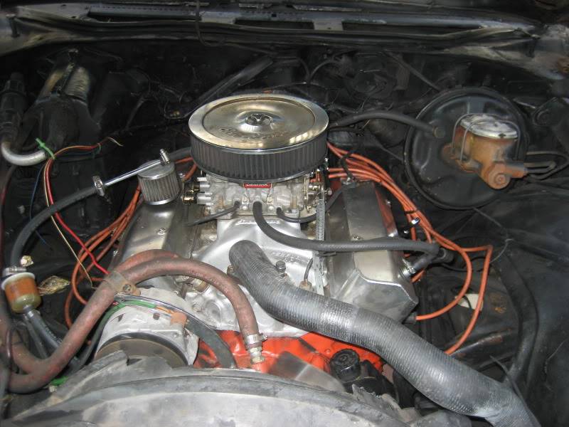

      Engine

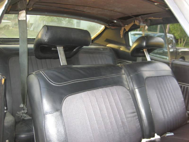

      Interior

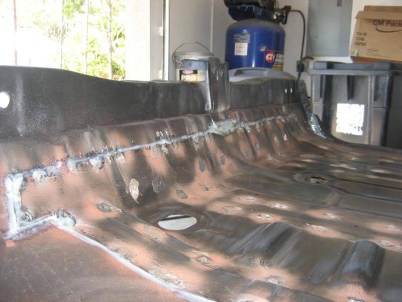

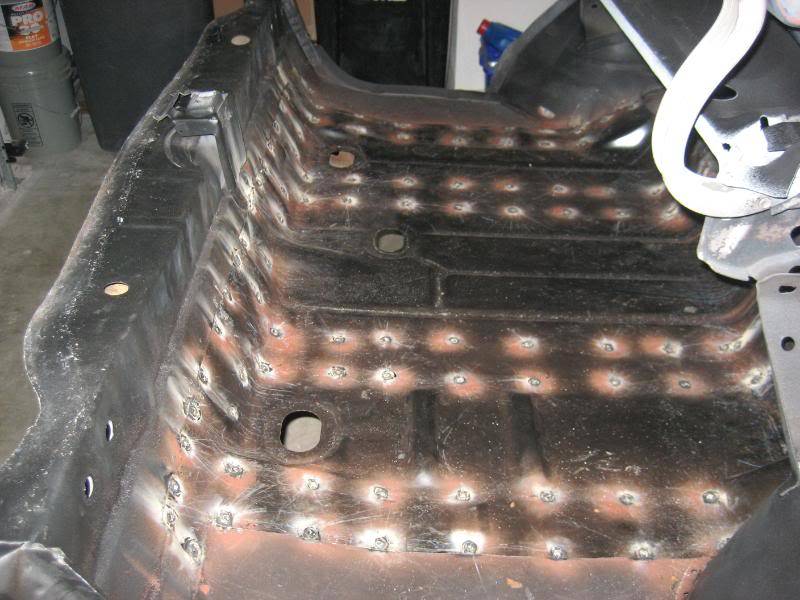

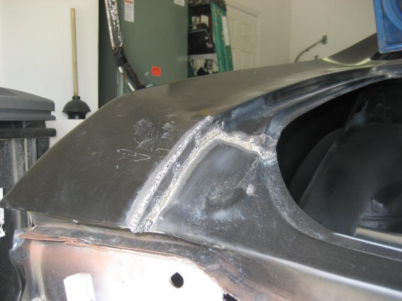

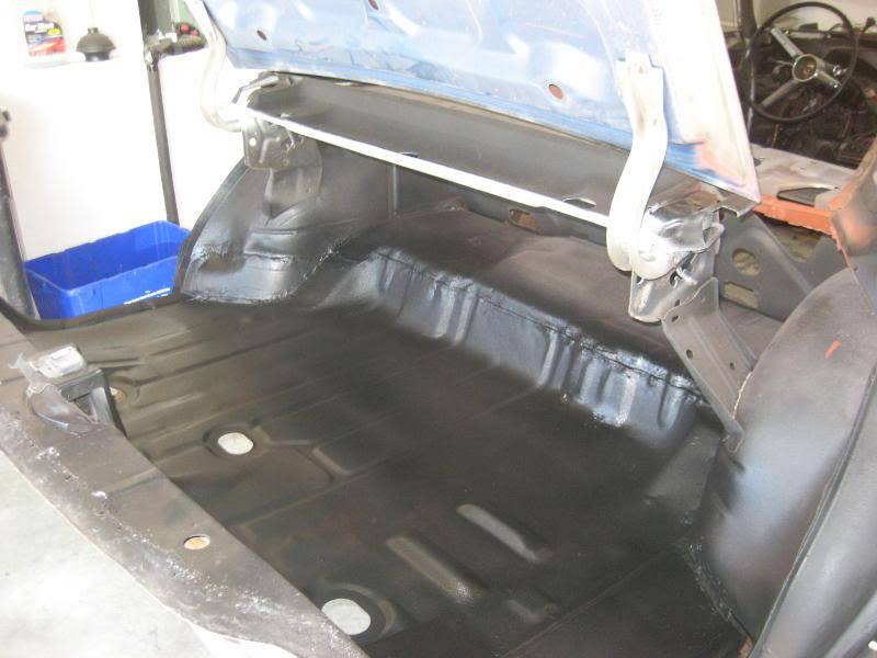

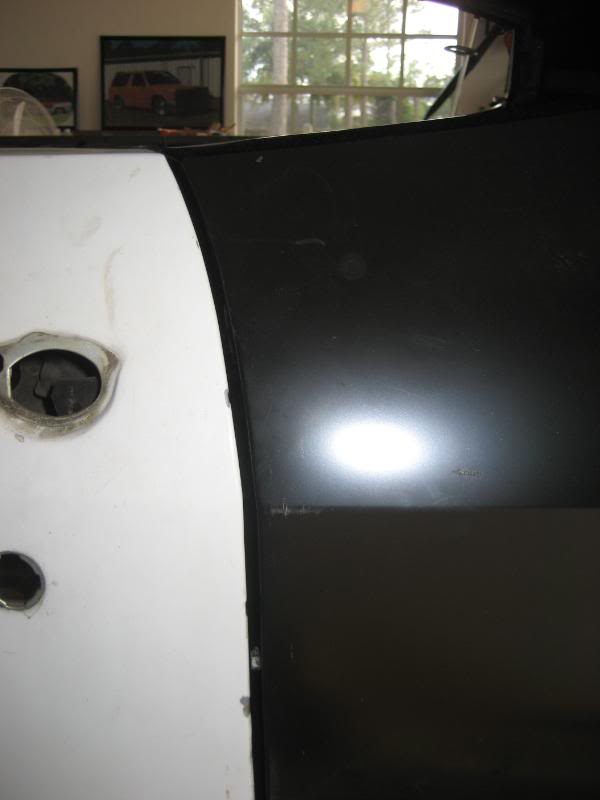

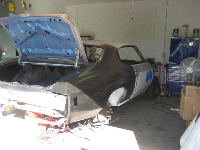

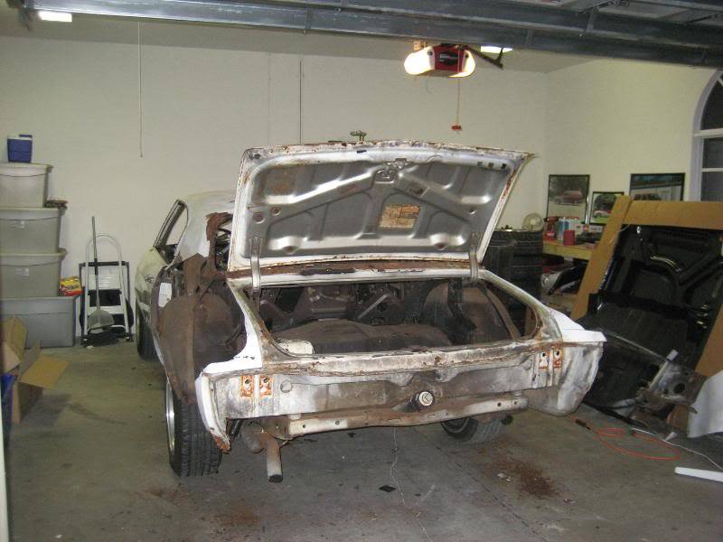

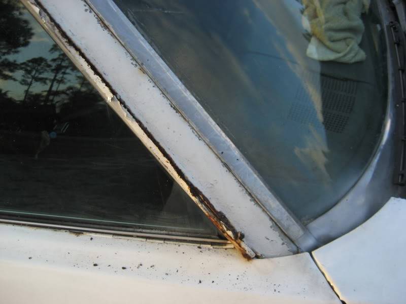

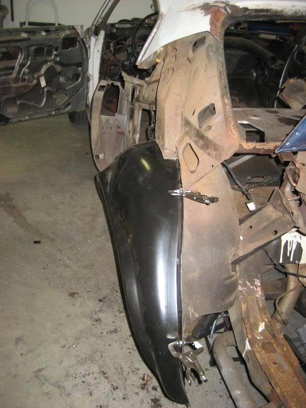

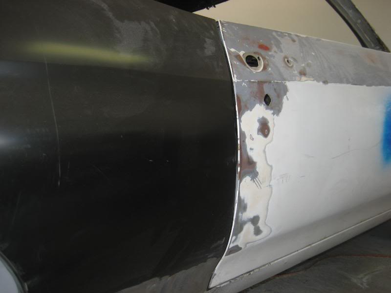

      The metal work begins
      And some bling
      What can brown do for you?

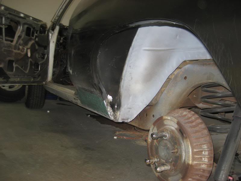

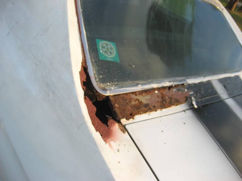

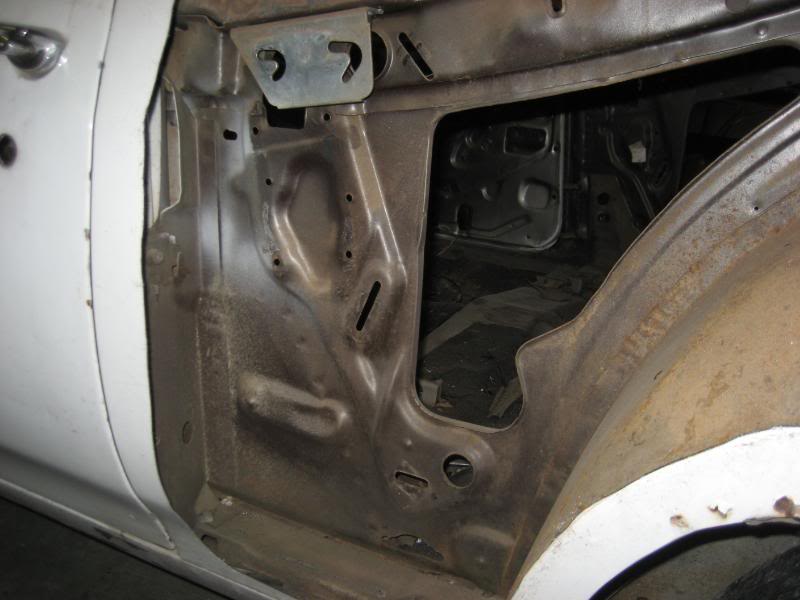

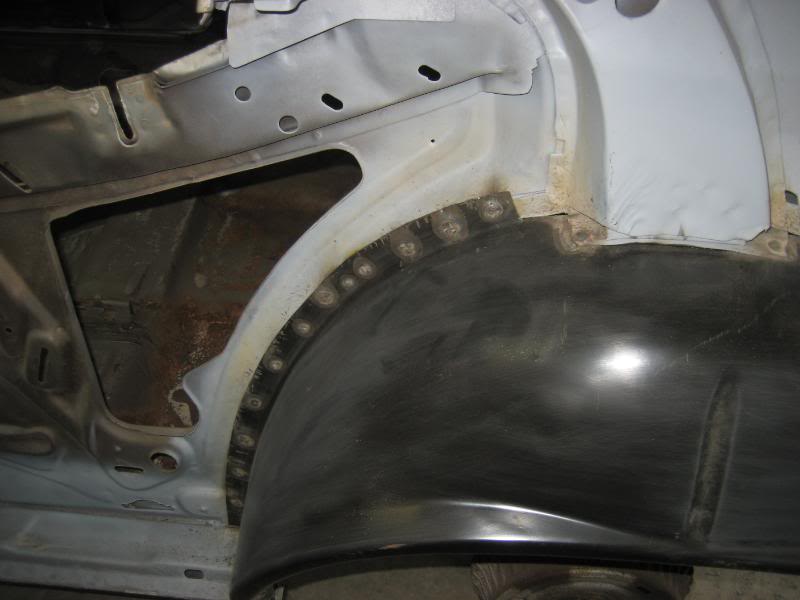

      Panel repair
      Chris Smock aka Blazed67
      Fort Myers, FL
      1,003

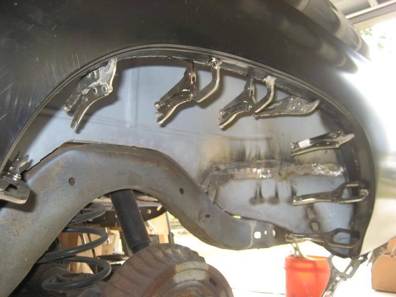

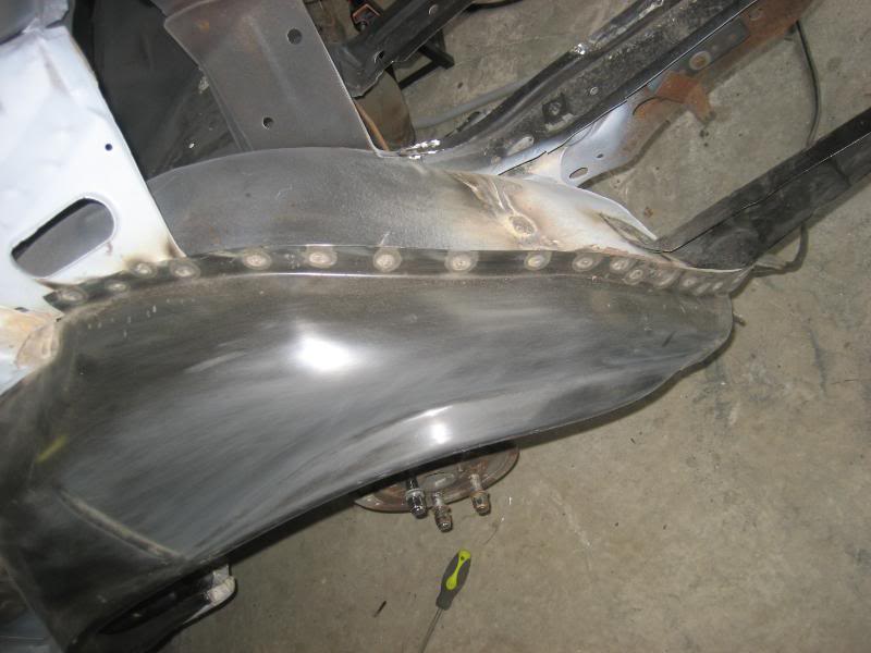

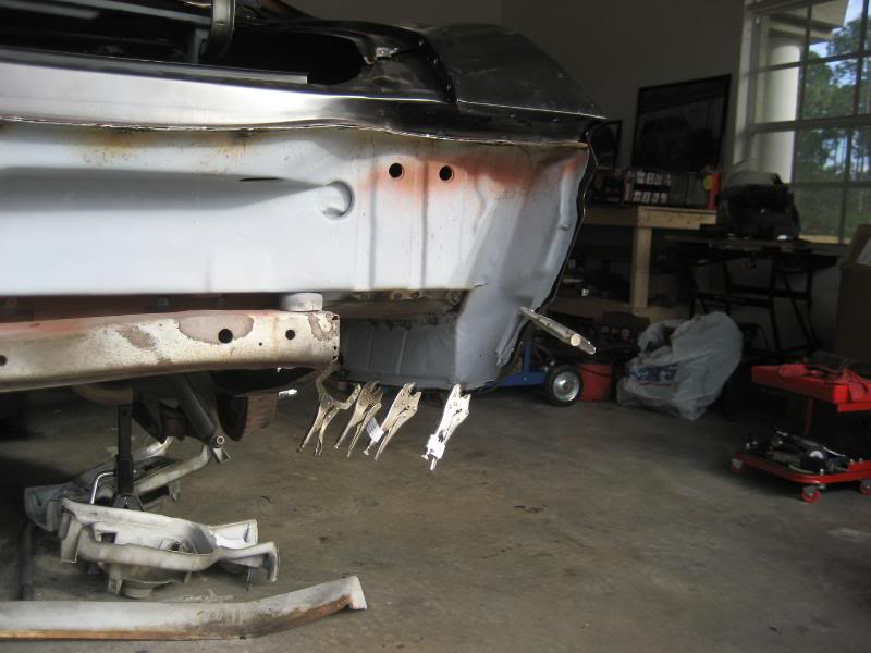

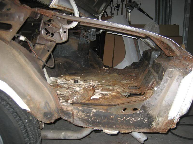

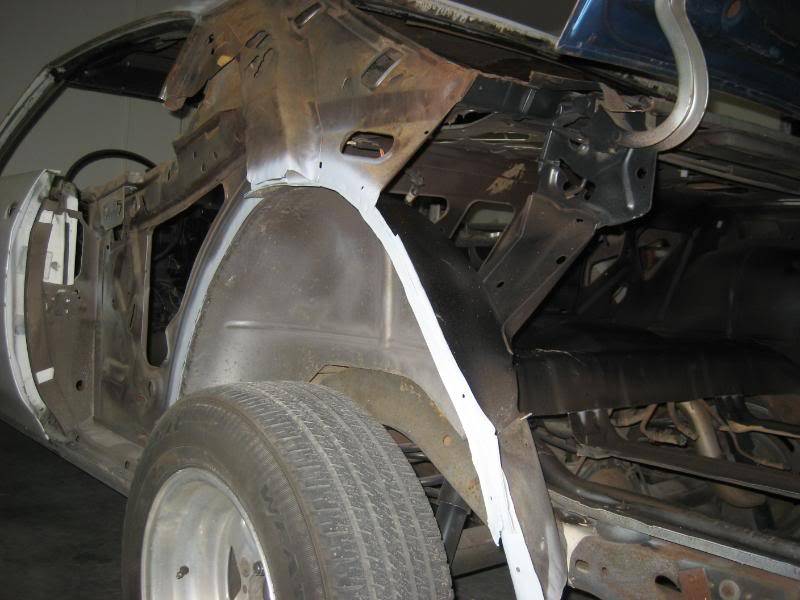

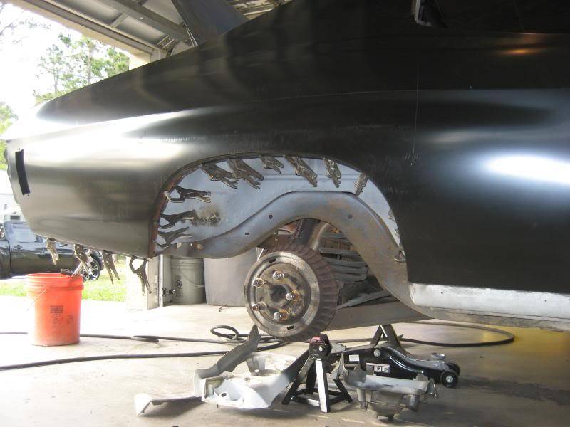

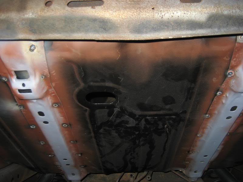

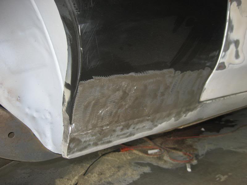

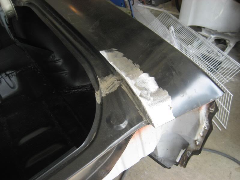

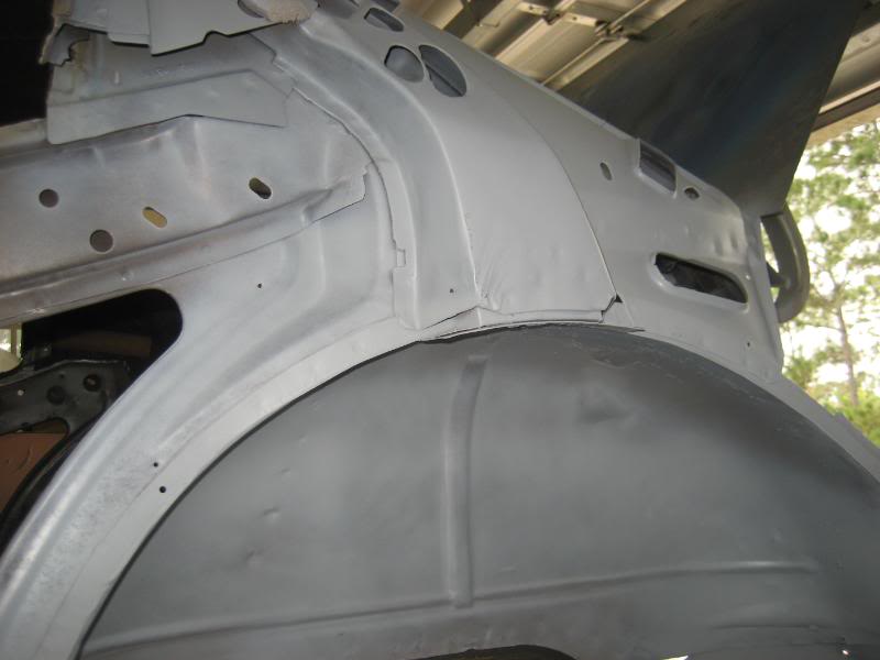

      More repair
      and
      Wheel wells

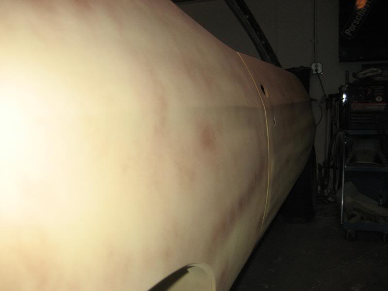

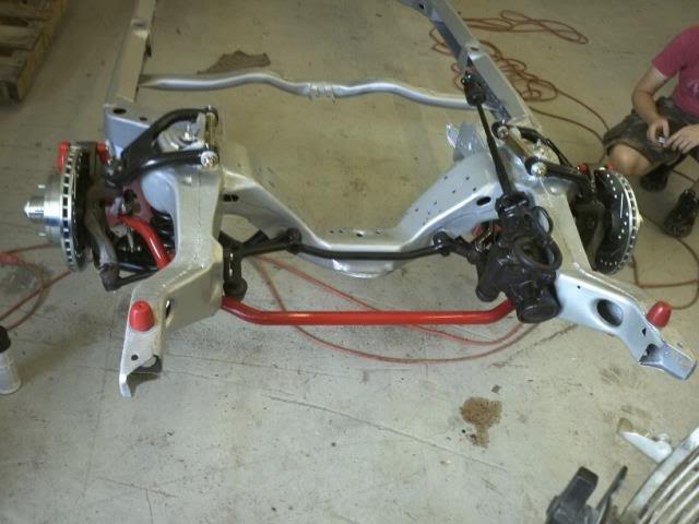

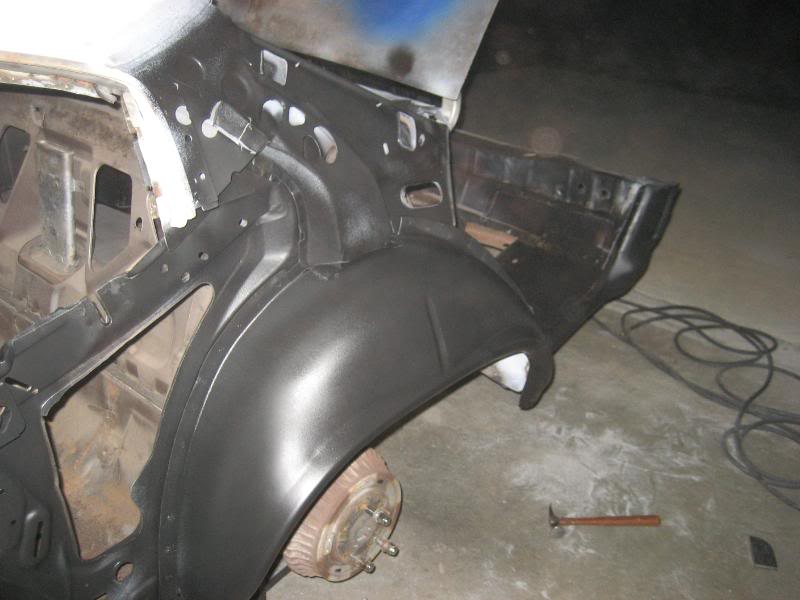

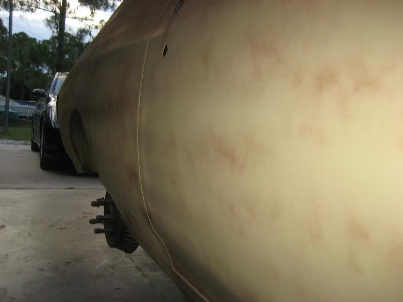

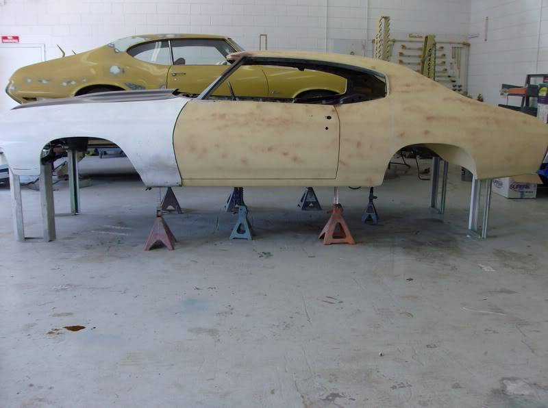

      And some color
      Where'd the frame go?

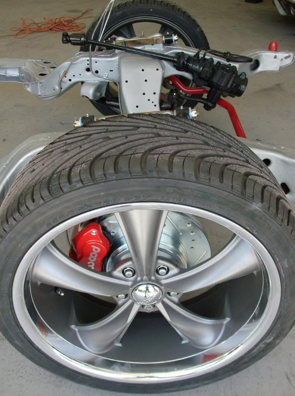

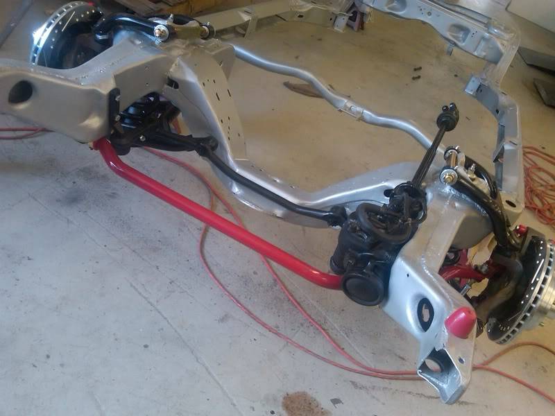

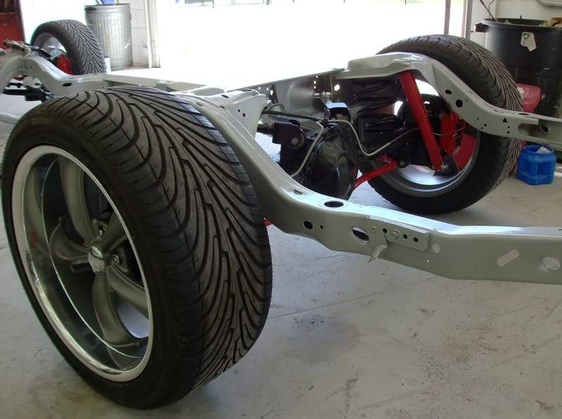

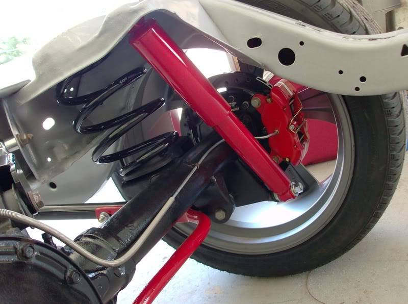

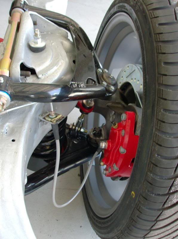

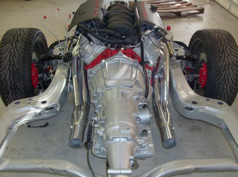

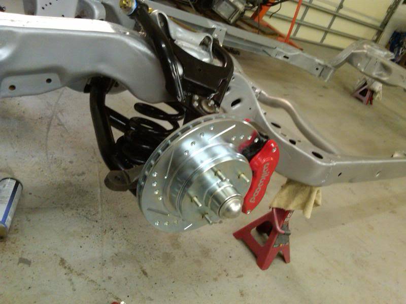

      chassis-
      stripped and painted (sprayed) with POR15 silver
      UMI rear upper/lower control arms
      Mr Performance front upper and lower control arms
      UMI front and rear sway bars
      CPP front lowered 1" coils
      CPP rear lowered 3" coils
      KYB performance shocks (rears painted red)
      stock restored/rebuilt steering box
      new front end bushing kit for steering linkage
      restored center link
      CPP 2" drop front spindles

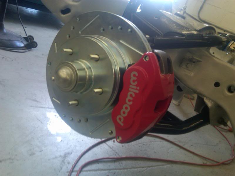

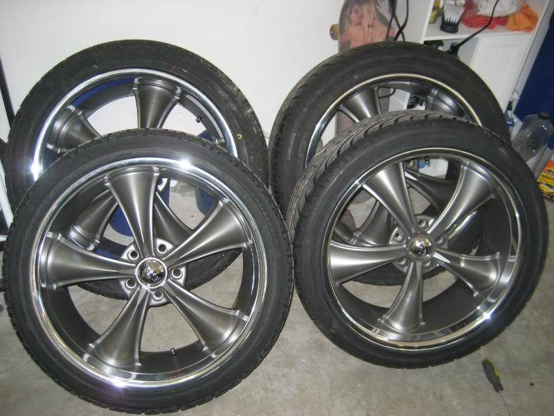

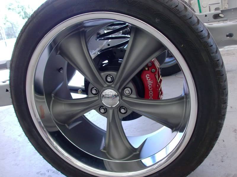

      Wilwood dual piston calipers on 12" rotor in front
      Wilwood dual piston calipers on 11" rotor in back
      Wilwood master cylinder
      12 bolt rear with 3:73 gears
      shortened aluminum driveshaft
      custom trans crossmember with exhaust tubes
      Flowmaster series 40 exhaust
      Dougs ceramic coated longtube headers

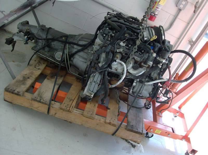

      LS1 motor from an 01 SLP camaro gone over and fully refurbished
      4L60E trans
      corvette fuel rail covers that will be shaved, painted red, and have custom chevelle emblems on them
      all new brake lines

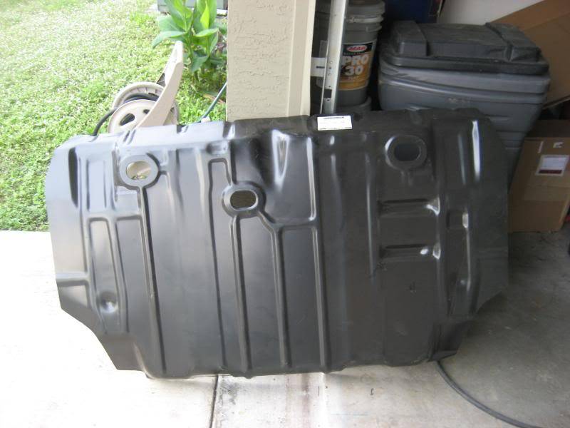

      new gas tank and sending unit
      external hp fuel pump and lines
      custom radiator and electric fans new
      vintage air gen IV

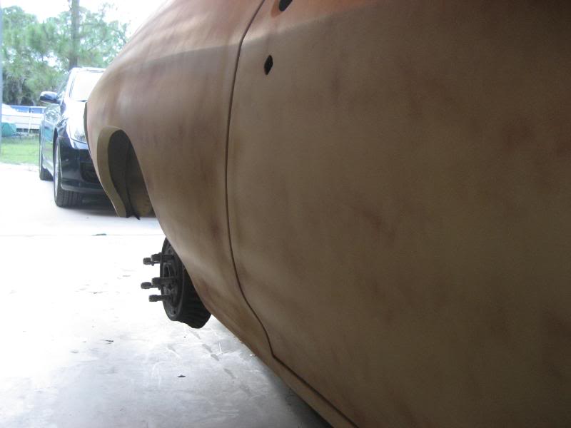

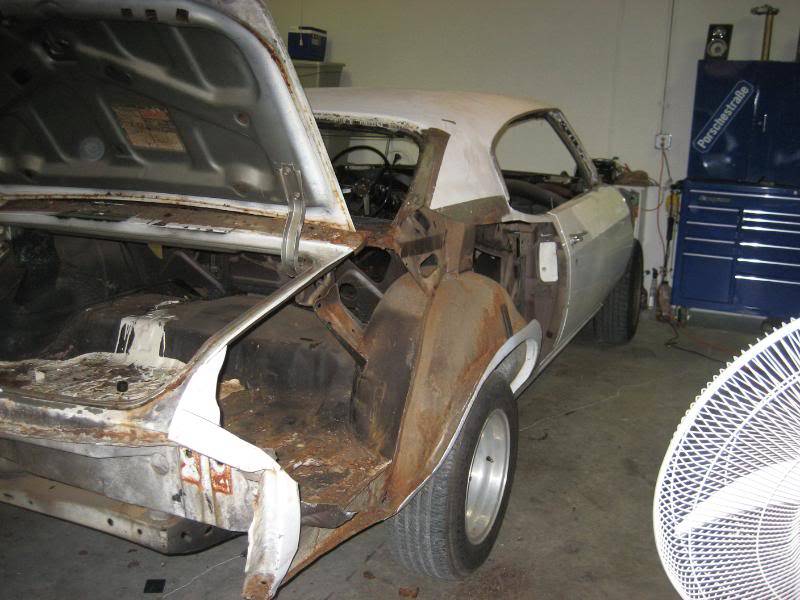

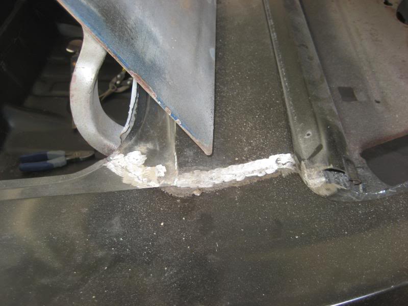

      Body-

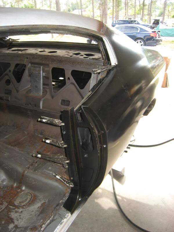

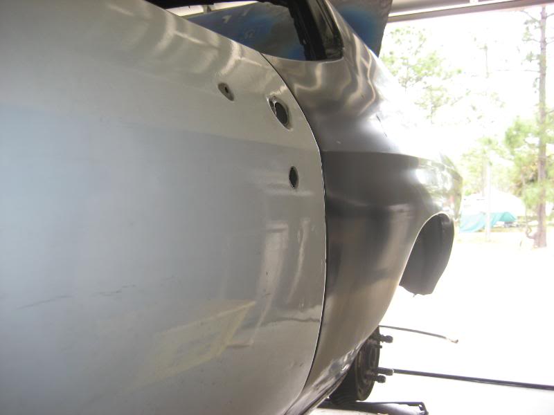

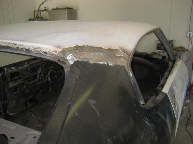

      new goodmark quaters
      new outer wheelhouses

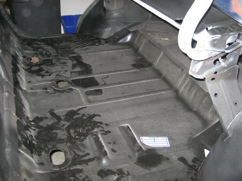

      new trunk floor
      new trunk drop downs
      new rear panel
      inner structure that was solid was stripped, epoxied, and rhino lined for corrosion protection and sound deadening
      underside and inside will be coated with Lizard Skin
      Quarters were etched and rhino lined on the inside before installation.
      I am ICAR certified and used the most modern standards for installation.
      the quarters were attatched with 3m panelbond and welded at the cosmetic seems as well as the structure points (rear body and B pillar)

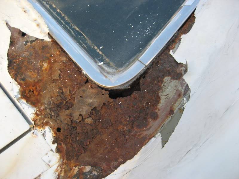

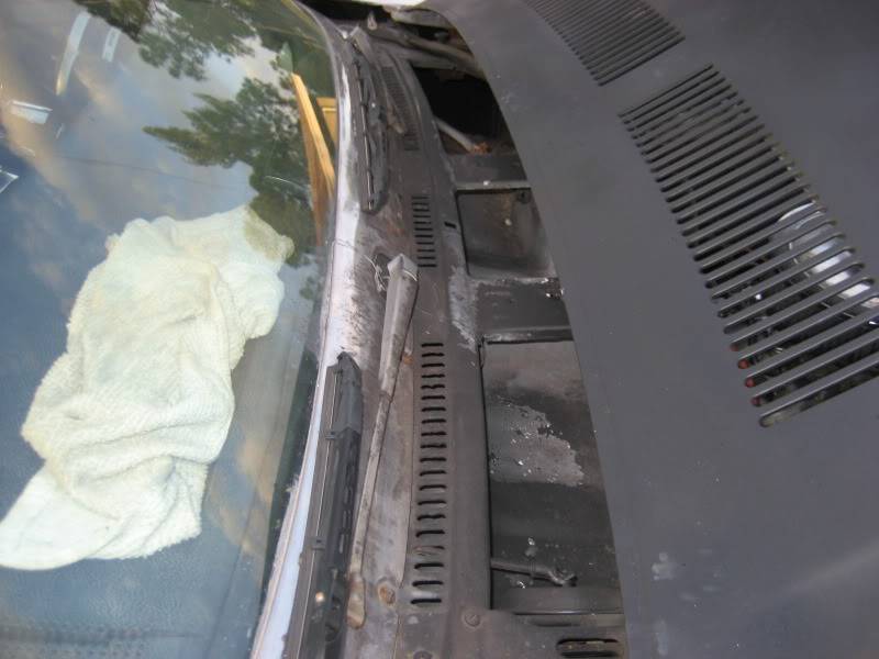

      light rust was in the roof from vinyl top sweat which was stripped, ospho treated, etched, and repaired.

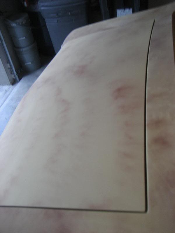

      the trunk lid was originally replaced with a new one but fit horribly. I found a used one in very good shape and restored it. i sectioned the ends of the trunk lid and quarters to meet with a straight line against the rear bumper.

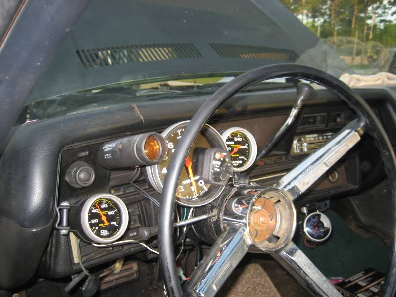

      interior-
      mostly stock appearing bright red bucket seat interior
      bucket seat backs and bottoms will be smoothed and painted body color along with the bottom of the dash and several other interior pieces. i'm building a custom guage cluster with intellitronix guages and push start ignition.

      i did all the metal work in my two car garage! I decided that I just didn't have the space or time to do the body off so shawn at rockstars is taking it the rest of the way up to being ready for wiring, interior, and assembly. We went to high school and auto body school together and even played in a pretty big band in orlando for some years so we definitely have some history!
