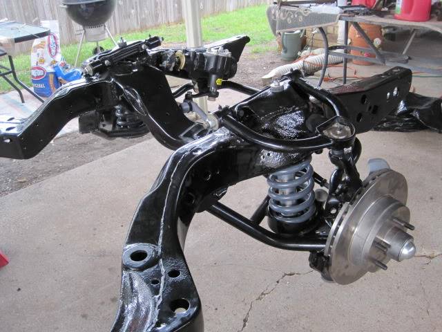

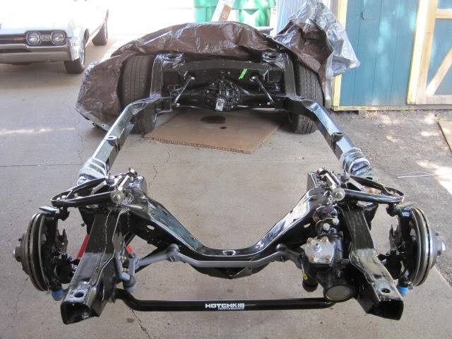

      Guys I'm building a 64 F-85 and just now completing the front end. Installed is the B-body GM spindles, 92 IROC Z ILE 12inch rotors with Caprice police car calipers and all the mix and match parts for this setup. For now installing all new 9.5 inch finned rear drums from Moser on a Moser 9ich. The car was originally with all drums and the single line 64 master cylinder. I need some help deciding what to buy in terms of a dual master cylinder, power booster (also going to need an electric vacuum pump because of the cam) proportioning valve and distribution valve and where to mount it. Routing of the hard lines on the front of an GM A-body.
