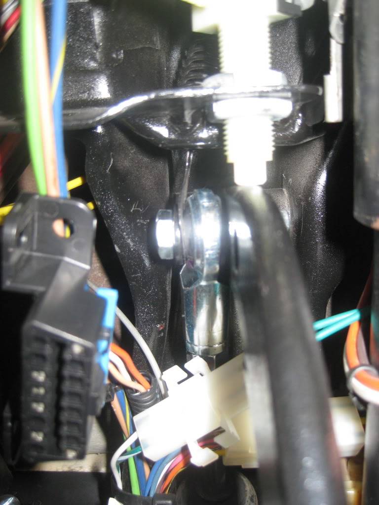

      It came with the rod attached, I have never pulled back the rubber boot to see how it is attached to the MC. Are you saying that that, in your case, the supplied rod was the wrong one? Mine is just a simple threaded rod about 4" long. I added a female heim joint to the end and bolted it to the brake pedal arm. I can adjust length with the heim join, but after the last time I just have left is where it is and backed off on the brake switch to give it more room. Here is what it looks like:

      I used my rod from my 7/8 bore master and it did exactly what you are describing. It made no sense but I even called Wilwood and they verified that you CAN NOT use the same style rod. If you can't pull the rod towards the drivers seat, it's the wrong rod.

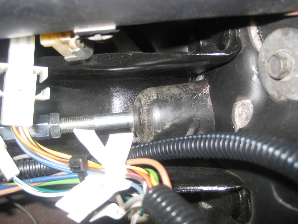

      Ok, I took a look and it has a C clip holding the base of the rod to the MC. I am a little concerned about remove it as there was a bit of brake fluid in the boot when I removed it. What is behind the C clip?

      Pull the master cylinder off the car. No way you will be able to do it in the car. You need to remove the current rod by taking out the c clip. Then you just need a stock style threaded rod that you can cut to length. You will also need to pull out the center bushing in the master cylinder bore.
