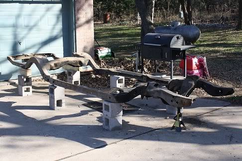

      Lots of welding and grinding to strengthen frame:
      Frame rails boxed in
      Gussets welded in
      Transmission crossmember cut to length and rewelded
      Preperations and measurments being made for clearencing spring pockets for ridetech suspension parts

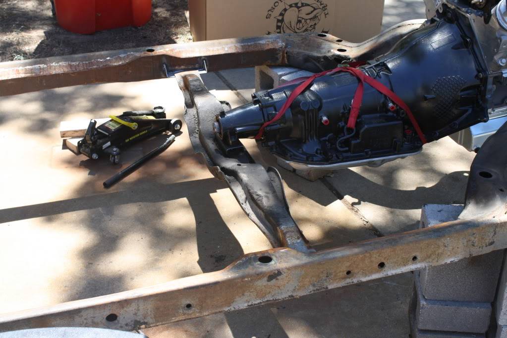

      Started mocking up the engine and transmission today and ran into a problem with clearance between the oil pan and engine cradle. See pictures below.
      The pan just buries into the back of the cradle:
      I have a full inch of clearance between the front of the oil pan and the cradle:
      After making several measurements the engine appears to be forward about 5/8" from original
      So I quess my questions are:
      1. How much clearance is enough between the oil pan and the back of the engine cradle. 5/8" to 3/4" enough?
      2. What is the minimum clearance allowable between the front part of the oil pan and the top of the engine cradle?
      I would like some feed back on this because if I am going to have to move the engine stands I would like to do it once and account for both front to back and up and down.
      Any pictures of your clearances from your LS3 to 66-67 A bodies would be great as well.
      Thanks again-Ken

      Well I decided that moving the engine stands back would be the easiest and least expensive thing to do. So here are the results.
      This is what I started with:
      New holes drilled:
      I tapped them for ease of install:
      Engine stand reinstalled:
      Engine and transmission reinstalled:
      Oil pan clearance much improved:
      Measurments make me believe I will have close to 5" to the firewall. All looking good I welded in the transmission crossmember brackets to the frame rails.
      Measuments made and lines scribed:
      Marked areas prepaired and brackets welded in:
      Finished product:
