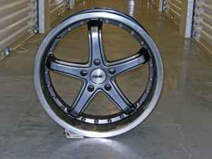

      5x120 offset (BMW) Front 19x8.5 235-40-19 Rear 19x9.5 265-30-19.........this is what he posted the rim and tire size. Will the fronts work? i know a 8 inch will but I didnt know if since id have to put spacers it would still work? I have a stock suspension. I really appreciate it...you guys have always been help full. this is the wheel. Think it will look good? Name:  3nc3k93o95Q15X25R3b7if5913a59dca51330.jpg

      was just told they are ssr wheels with bmw center caps
      952
      probably too much backspacing to run without a set of expensive adapters.

      yea i dont know the backspacing. what would it have to be for a 8.5 to work? I dont mind a little rubbing. I plan on running air ride with the tru turn and dont mind doing a little massaging.

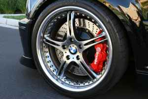

Size:  7.4 KB found these... I think they will work cuz they are 19x8 and 19x9.5. I gotta find out the BS. This pic is the rear. Anyone think I should go with them or the bmw ones?Name:  3nc3k93o95Q15X25R3b7if5913a59dca51330.jpg
Size:  8.3 KB. Its going on a gray 69 camaro with black rally stripes. it currently has weld racing wheels 15 inch so they wont be clearing the big brakes.

      either way if you plan on running any BMW wheels on a F-Body you will need at least a 1" spacer/adapter because u need 4-3/4" back space in the rear
      Im running a set of M5 3pc wheels with a 1-1/2" spacer in the rear and i think the spacer in the front is larger not sure because i still have the front fenders off
      But if ur not scared of running spacers i say do it, u will save tons if you buy used BMW wheels and theres a crap load to chose from too

      I run HRE wheels from a BMW on my 69 Firebird without spacers. The fronts are 18x8.5 with a 5.3 backspace and the rears are 18x10 with a 5.9 inch backspace (keep in mind I have an AME subframe and G-Bar). The wheels off the older 5 and 7 series cars usually fit without spacers. 3 series wheels are usually a bad fit. Some of the M series wheels will also fit but you have to get the offset and check if you don't want to run spacers.
      I also picked up a set of HRE BMW wheels for my 64 GTO that will fit without spacers.

      What year M5 did you get your wheels off of? I have E46 M3 wheels and the rears fit fine with no spacers.

      Yeah those bimmer wheels are SSR GT3's.

      M5 was a 2005, and the rears are 10-1/2" wide 6" lips but the center where the wheels get bolted on is about 6-1/2" from the rear lip edge.
      M3 wheels have less backspace then M5 wheels and 6/7 series have the largest and you can run an 11-1/2" rear wheel on them and i have put 750li wheels on a 69 chevell with a 1/4" spacer in the rear no spacer up front

      i had those ssr on my rx7 back in 2003. color is called anthracite. very nice metal looking color.
      as for you question, to be completely specific, the bmw 3 series wheels from the early 2000s will not fit any first gen camaro without a spacer, period. as stated above the 5 and 7 series from the early 2000s will fit without spacers as the offset is lower. bmw 3 series is around 38-40mm offset while the bmw 5 and 7 series is around 20-25mm offset, so close to an inch difference.
      i am running 19s made for a bmw 5 series and they fit fine with my drum brake set up, cough until i got greedy and put 285 tire in the rear, lol. had to whip out the big frickin hammer and massage the metal a bit for clearance. now that i went with 14" brake rotors on the rear, i do not know if i will have any clearance issues yet as the car is still currently on jackstands. worst case scenario, BFH again.
      if it were me, i would not buy them as the only way they would work is if you run a big spacer thats about an inch thick. and for that kind of money i am sure you can do better.
      IF YOU ARE GOING TO RUN BMW WHEELS, MAKE SURE THEY ARE FROM THE 5 OR 7 SERIES FROM THE LATE 90S TO EARLY 2000S!!!
