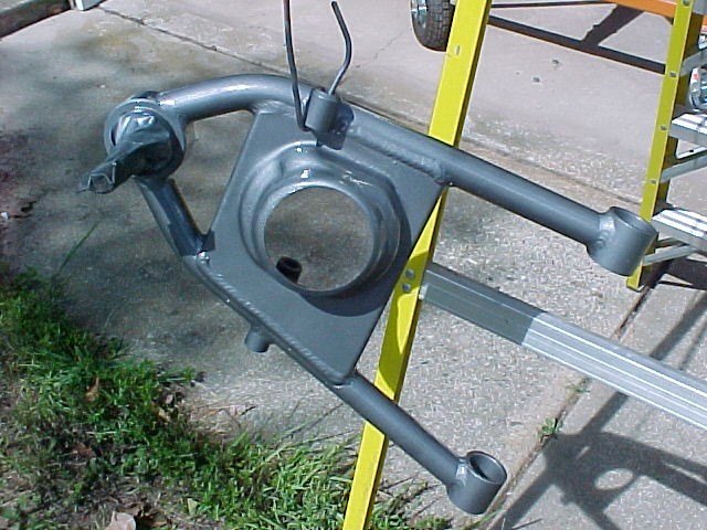

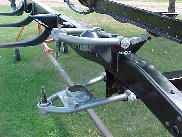

      Hey Ben,
      Look at Rustleom... They have a lot of colors available that look good. I used their "Hammered" gray on the arms for my '49 F1 and it looked great. I will probably use the same paint for Bad Ast's arms...
      Here are some pics.
      Here are the arms installed.

      Ben,
      Here are some pics of the rearend for Bad Ast. This is Rustoleum Black Hammer Tone. It is close to a slate gray. I rattle canned it. 5 dollars. If you put on light coats the HAMMER is not as obvious. I sprayed this yesterday and it was dry to the touch in 15 minutes.
      I will be doing the chassis with this paint also. 12 bucks a quart and it looks pretty good.
