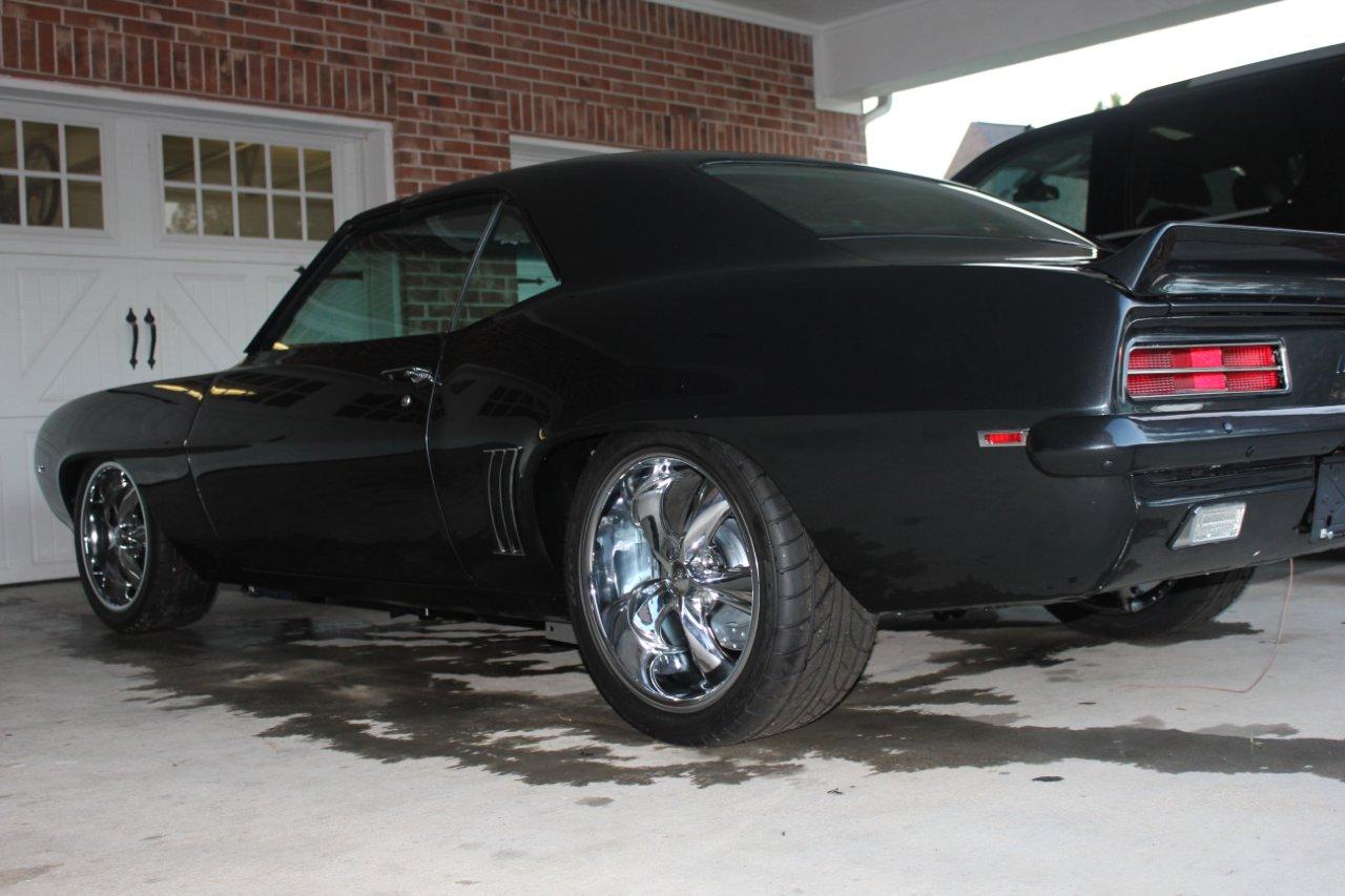

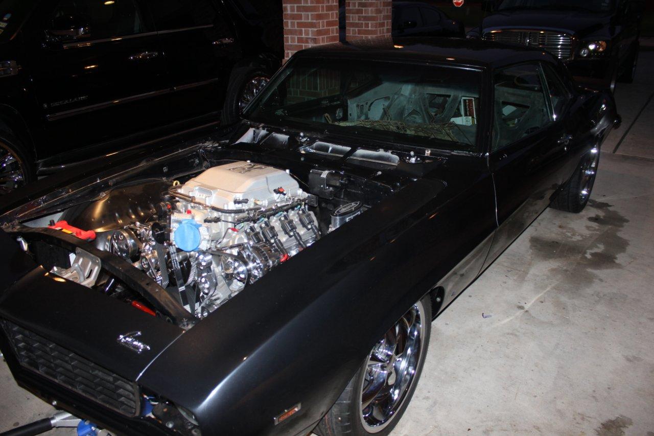

      I'm installing an LSA motor and 6L90 transmission in my 1969 Camaro. I Mounted the complete engine/transmission assembly into my TCI subframe and rolled the whole setup under my car today. Here's a few photos.

      nice build looks nice

      That looks awesome! Looks like it could be the villain in a movie!

      Looks great! Did ou have to mod the transmission tunnel to get the 6L90 in?

      Thanks guys.
      Rod, not yet, but when everything's bolted up tight, I'll probably need to. I see you're from Metamora. I live in Houston, TX now, but I grew up in Washington, and my neighbor lived in Germantown before moving here. Small world.

      You're gonna love that motor! I drove a modded CTS-V recently and your car is even lighter than that. Watch out Bro...

      great engine and car combo!
      cant go wrong with that!
      even if the wheel choice is a little questionable... ahahah

      The wheels are my favorite part of the car (at least till I get the engine running).

      Great engine combo. Its going to scream! We'll need to see progress pictures for sure. Very Nice.

      Totally sic engine tranny combo!! This '69 is gonna fly!! Good luck with the build!

      First off WOW nice Eng/Trans combo, are thinking of running paddel shifters?

      I have a Pontiac G6 shifter, which gives me tap-up, tap-down, but I'll still probably put in paddle shifters.

      Great project. Where did you get your engine/tranny?

      I picked up the engine from a guy in Memphis via eBay. It was a factory replacement engine that was never installed. I picked up the transmission from a guy in California that is also installing an LSA motor, but he decided to go with a manual 6-speed instead. The tranny is from a CTS-V, so the tail/driveshaft connection is a little odd. Mark at Street & Performance swapped out the tail and output shaft so I could run a conventional yoke. The transmission mount was a little easier with the truck tail too.
