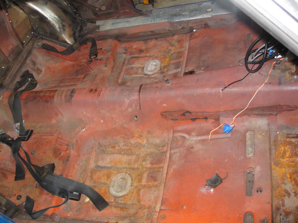

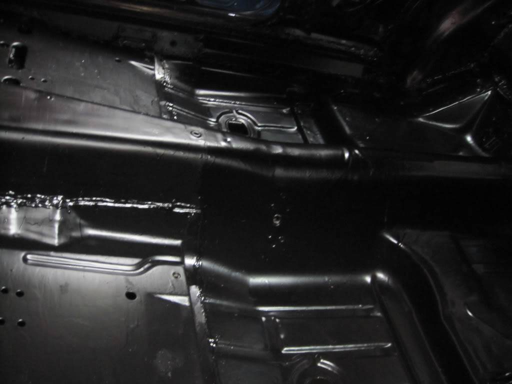

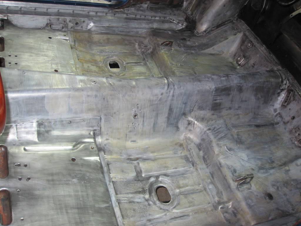

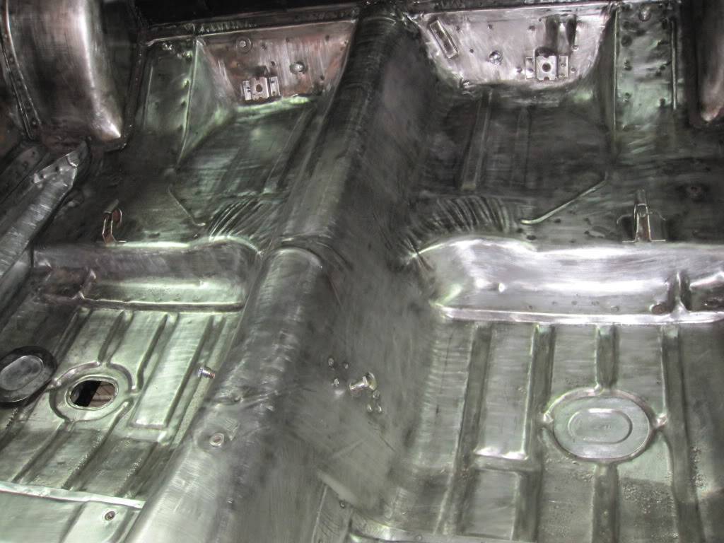

      I took my floors down to bare metal as well. I used Por-15 and their Chassis black. I had previously used Por-15 on my engine block, firewall, rear-end and trans and had been very happy with it. Just have to get everything perfectly clean. Here is a few pics:
      Start:
      Cleaned to bare metal:
      Metal ready prep:
      Por-15 silver undercoat:
      Chassis Black and seam sealed:
