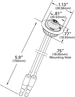

      Here is a small white LED that is designed to mount into a 3/4 inch hole.
      These would be great mounted into a license plate frame.

      http://www.grote.com/product.php?pro...49341&x=13&y=7
      You can get them at any place that sells truck parts.

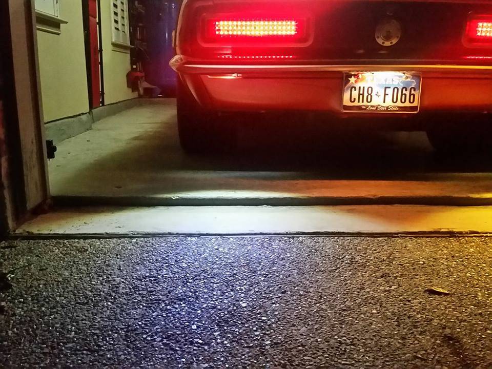

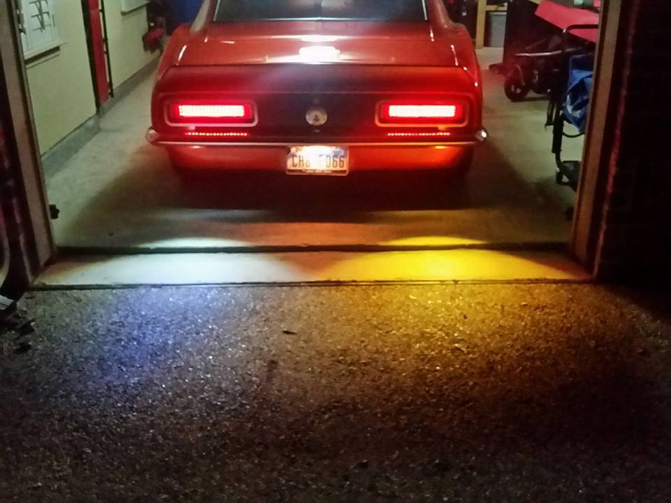

      Played around today and decided to mount the new reverse lights. They are a 1/4" to the fender side of the lower bumper bolt and 1/4" higher than the bolt. You can't see them standing behind the csr but they do give decent amount of light. I ordered 2 more LED bolt bulbs that are brighter and have 3 leds built in them. Go to home Depot and get some magnets to help you determine where you want to drill the hole in your tail pan. Drill the hole out, hook up the red wire to the green reverse wire, ground the black wire on the bulb to the taillight nut and your done. The light on the left is the one I'm going with. I also ordered a led license plate light.
