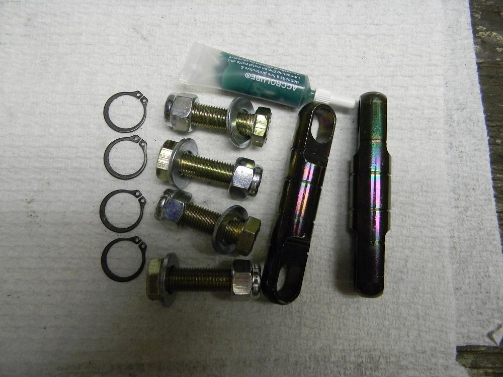

      Here is the hardware im speaking of

      That's a kit for a coil over shock lower mounting. The snap rings hold the shafts centered in the shock.
      Any Camaro end link kit will work if it has poly bushings.

      we may have put the T Bars in the sway bar package to sane some shipping charges, rathe that charcing you for a second package. but yea those are for the lower shock mounts. how then did you mount the bottom of the shocks to the control arms in your other post???

      Lol.....Well my chicane brackets and coil overs came with 4 of the black metal bushings that fit into the shock held in by snap rings. Im using the bushings to mount the top of the coil over to the ATS bracket, and then im using the other bushings on the bottom of the shock along with the threaded ATS brackets that bolt to the lower A-arm??????? What the hell did I do wrong.........lol
      Why would I not get the mounting hardware with my Chicane kit? I had my Chicane kit 3-4 weeks before my sway bar.
