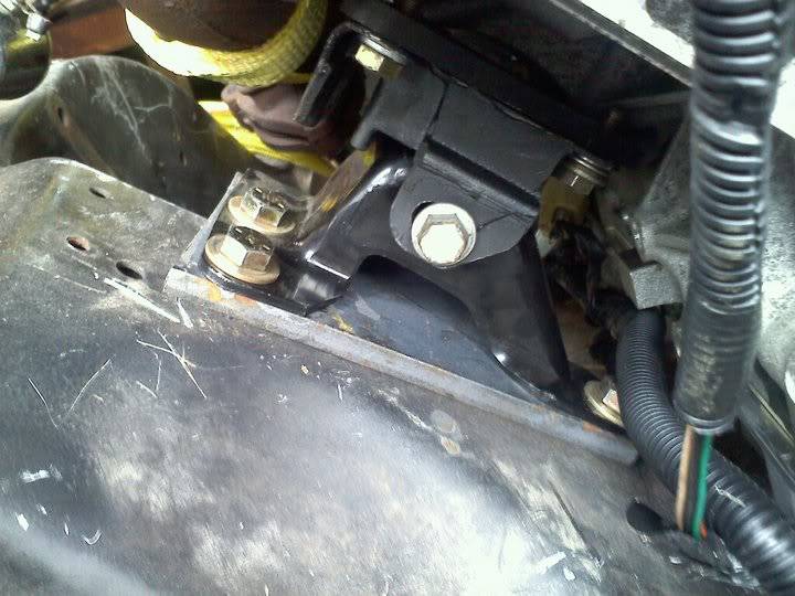

      ok got it this is my prob!

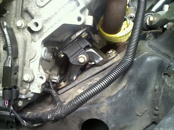

      this is the plates i made it works now but like i said i dont like fabing everything!

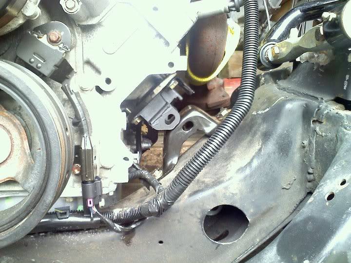

      this is the drivers side

      i have pics but my phone will not up load (it driving me crazy) the kit came with mounts in it and the frame mounts came from summit
      prt# gmk-4020-335-69L and gmk-4020-335-69R

      those look pretty short for SBC mounts...BBC perhaps?

      thats what i think i told summit i needed 350 mounts and this is what i got i will call and see if any one elce can help me find the ones i need

      The looks like short engine stands and motor mounts for tall stands. My Transdapt adapters had motor mounts for tall engine stands. You need to either get a set of motor mounts for short engine stands or get tall stands to work with the motor mounts you have. The correct motor mounts will fit snuggly on the stands. Those mounts probably have about a 1/4 inch gap.

      ya they do!!! so i can call up NAPA and get mounts for a big block? and all will work fine.

      no you should get the proper small block chevy frame mounts/ frame perches. They sit up a bit higher.

      Well that's what I will do thank you every one this helps so much! I will keep you all posted.
