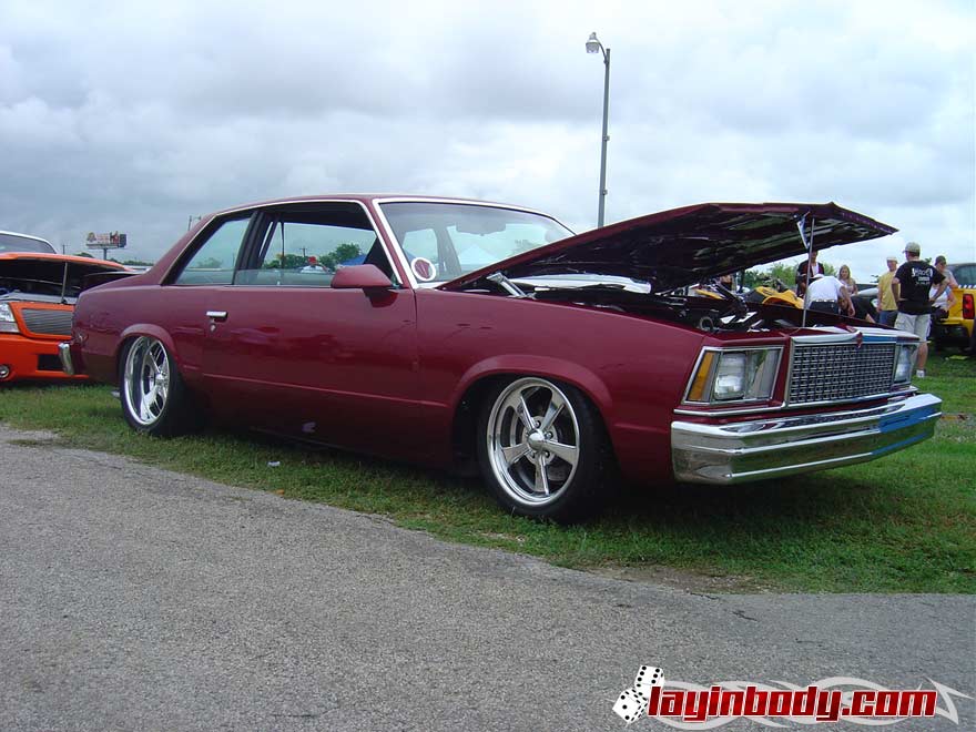

      I think it handles well. But I dont drive the car like a race car either. Mabye its a street machine not pro touring. Who gives a damn anyhow. Its how i like it. Mabye its like Johnny said about the whole showcar/ racer. I like to think of my ride as a modern performence car not really a g machine.

      Jason,
      Do you have any pics of it slammed and at ride height?
      Dan
      133
      ride height
      no air.
      Delaware, OH
      1,379
      DAMN that's SWEET!! Thanks Jason!
