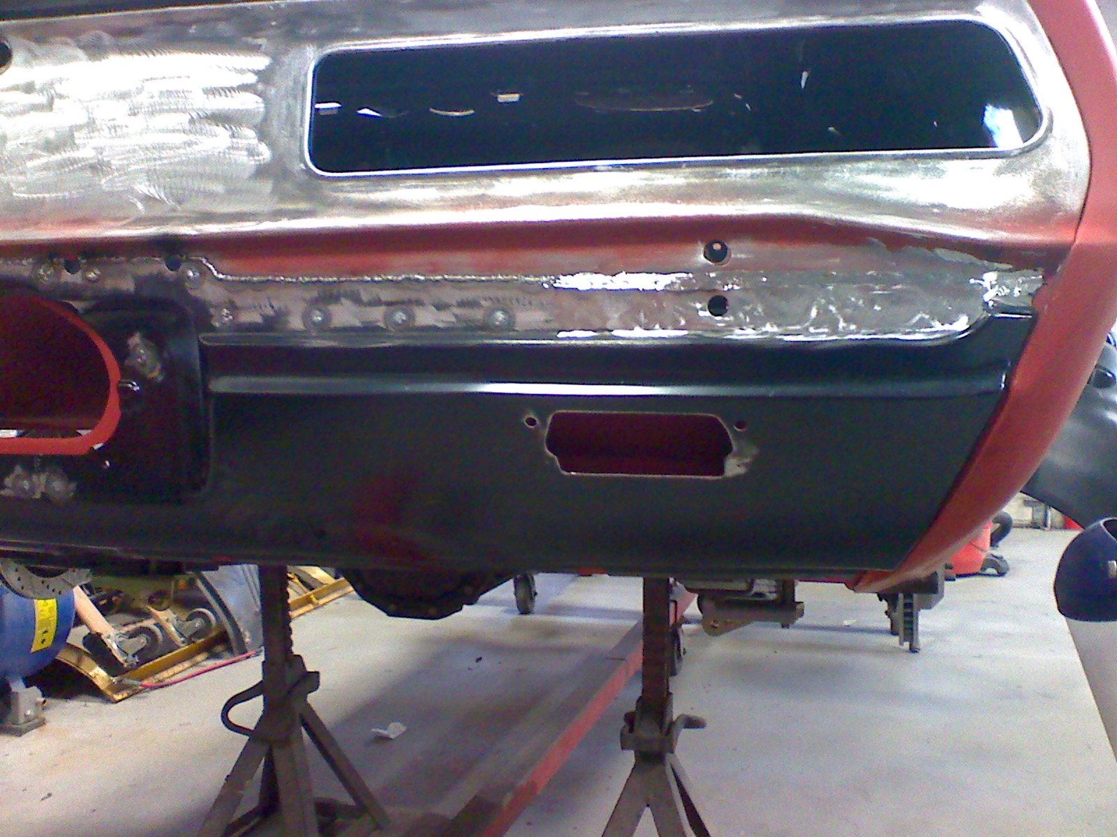

      Heres some pics of my 69 lower part was crunched pretty good . Hope it helps .
      Lawrenceburg, TN
      4,098
      after market tail panels fit fairly decent, I installed a Goodmark rear panel on my 68 camaro and since you're only using the lower half then you only have half the work to do, I did it in my driveway
      new panel
      complete

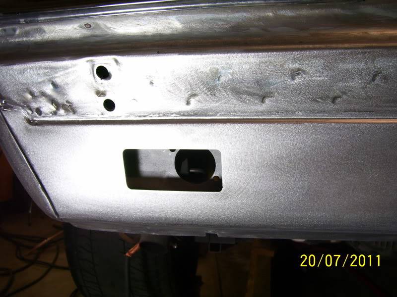

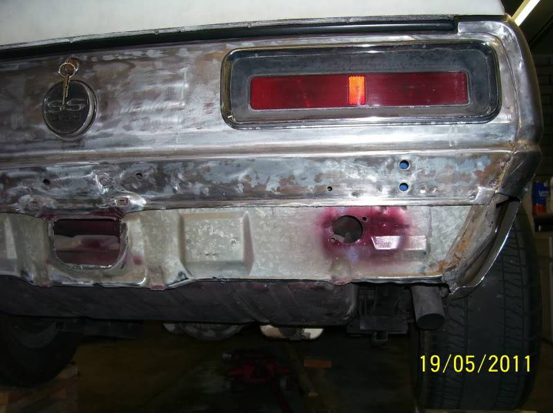

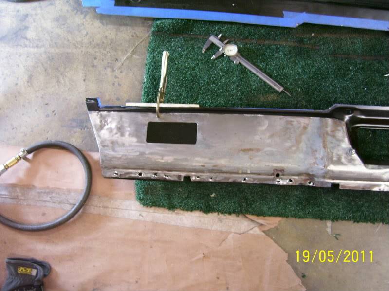

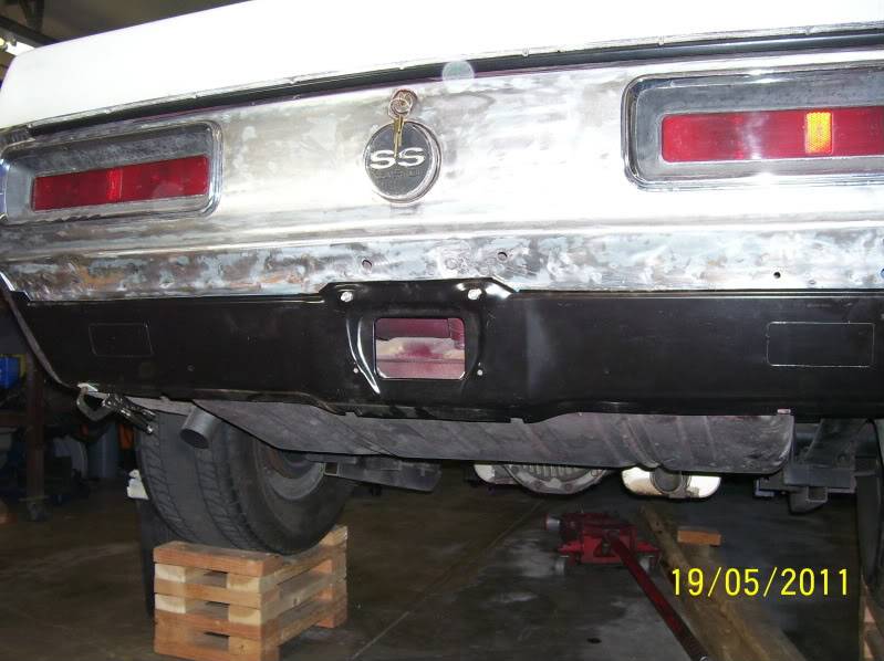

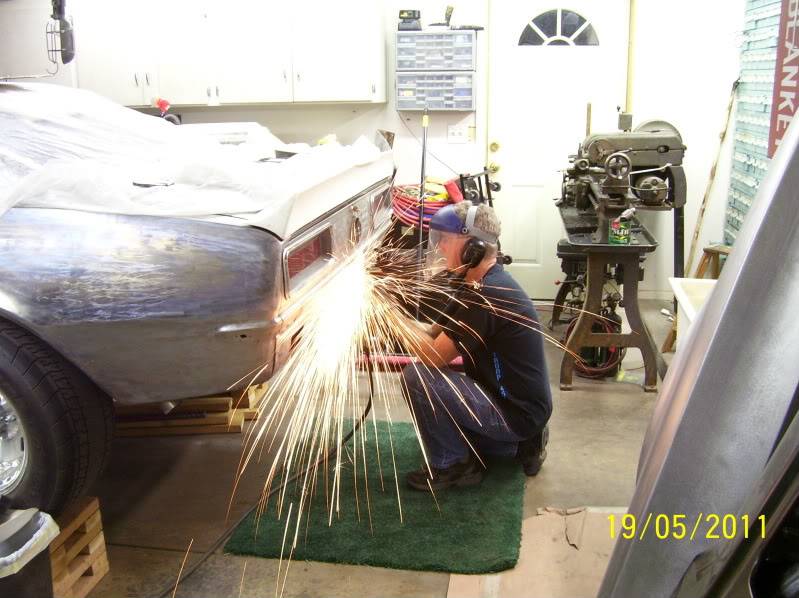

      Here is a little progress on the tail panel.
      Action shot thanks to my son
      Splitting the tail panel
      Using the old panel as a template for the back-up lights
      Mockup ready for the final cut

      Great job! Thanks for the pics. More motivation for me to get to that garage... not raining in the garage! lol
      I also like the wood block idea. Those would be helpful when tightening down eveything at "ride height"!

      The wood block idea has been out there a while. If you know about Detroit Speed they use them all the time. Very cheap and very strong which is nice. The only down side I have found is storage when not in use, but they stack nicely out of the way. Good "rainy day" project.

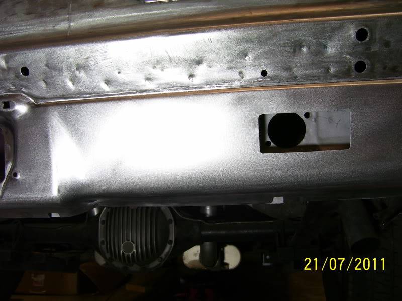

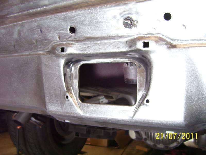

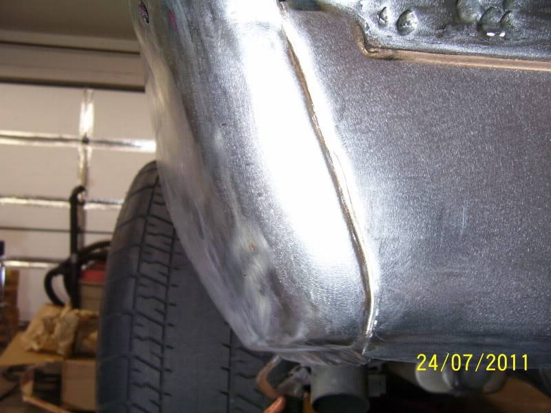

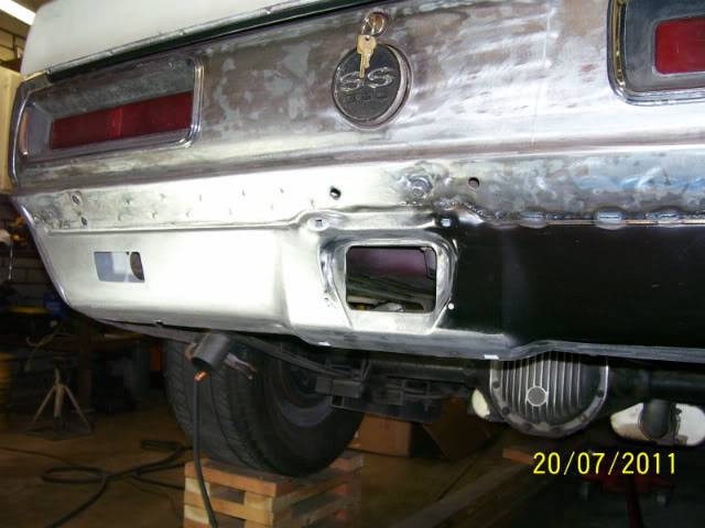

      Updates to the 67 Tail Panel Tune UP
      Ok took a while to make some progress (hence the username "Slowprogress")
      The tail panel welded and starting to grind the welds
      Closer view of the clean-up
      Center done just need to add a few spot welds
      Right side done
      TIG brazed the seam was a little rough need some more practice !

      nice work
      MrQuick ΜΟΛ'ΩΝ ΛΑΒ'Ε
      Auburn, CA
      613
      Looks great to me!
      BTW...a little bit of heavy build primer forgives all sins...
