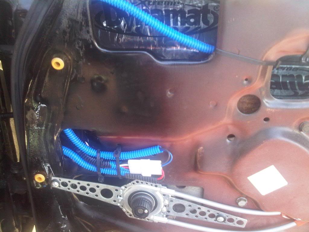

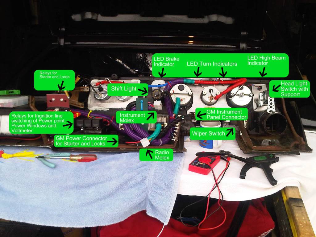

      Was replacing the circuit board on the back of the stock SS gauges and ran into a melted wire. Ordered up the American auto wire classic update kit and ended up with this, along with power windows and power locks from spal.
