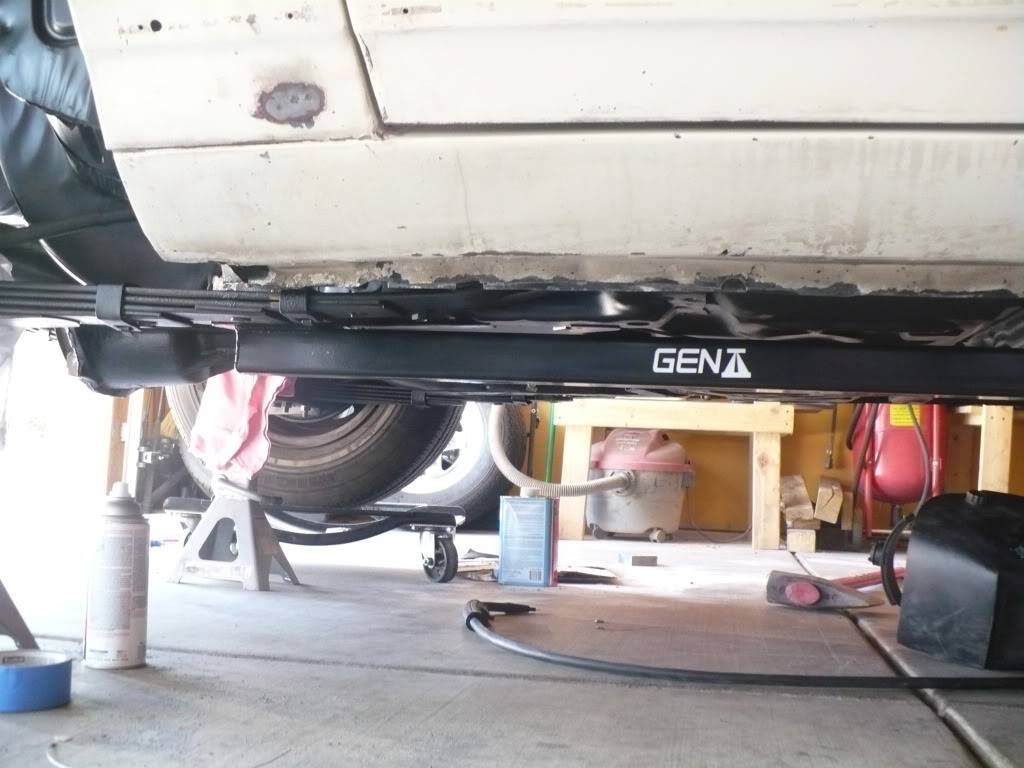

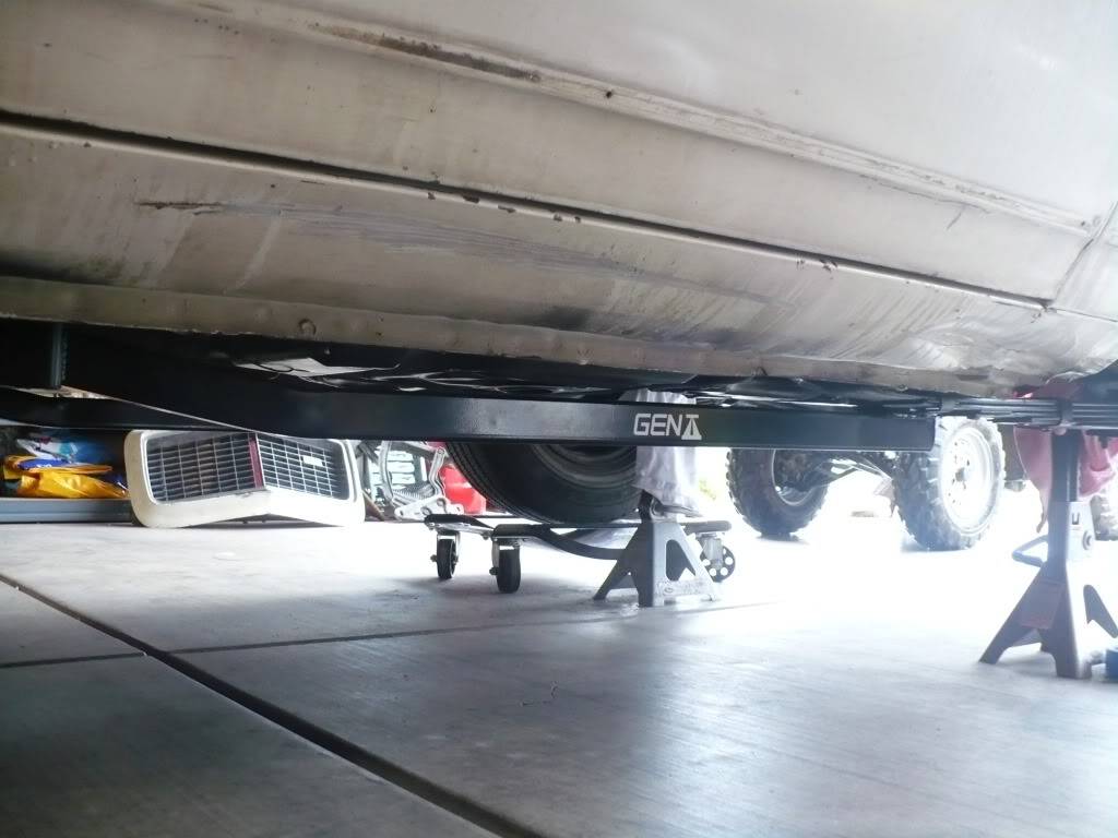

      I don't have much to add, but I think I am going with this setup too. Hard to beat for the money. Anybody used their subframe connectors, I am curious about how tight they tuck in and how well they fit.

      How do you like the fit of those connectors overall? Any issues with exhaust?
