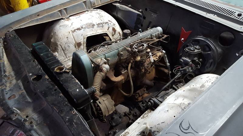

      Long time no update
      Fast forward past a little time in storage, the tempest is back in the garage!
      I've acquired an OHC6 from another 67 Tempest that was getting a V8. I dropped it in the car for text fitting and fired it up. It came to life instantly and just hummed.
      If there is any interest I will post more
