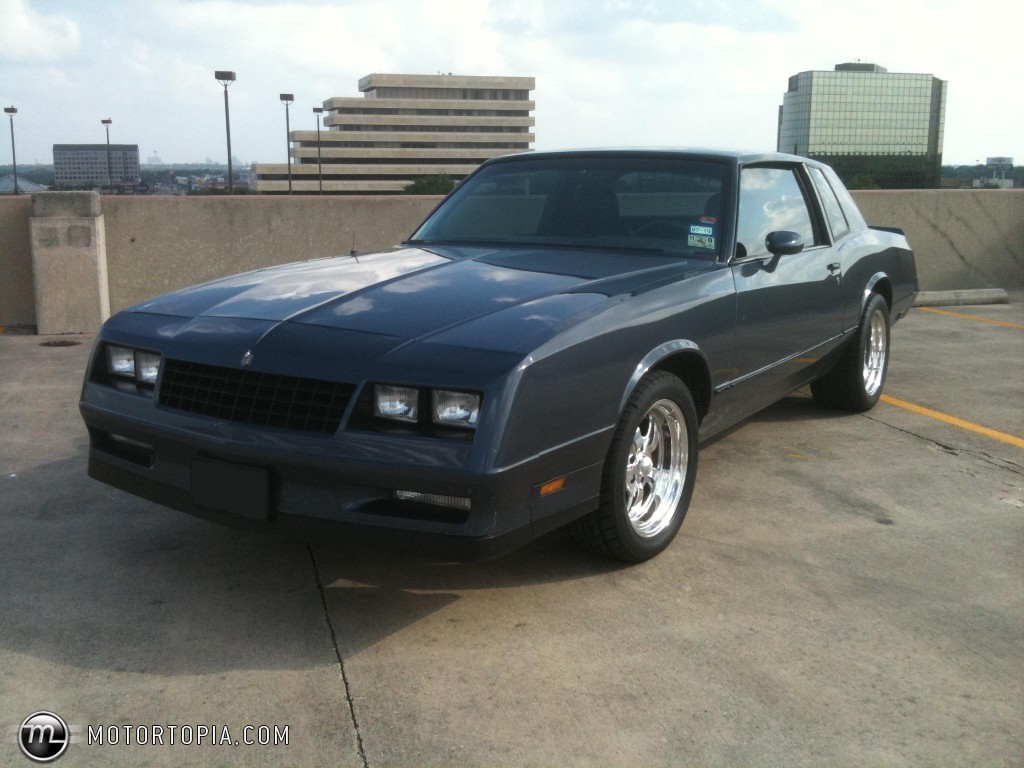

      The 245 on the Burgundy Monte have no rubbing, it has 2" drop spindles, and still the original
      coils, which are being replaced with higher rate coils.
      Only on very sudden dips at high speed (more like 50+ mph) the inner fender gets a bit of a rub, but that is
      due to the drop spindles with soft stock coils.
      No rubbing on full turn, speedbumps, or most road dips/bumps, or 'spirited' driving.
