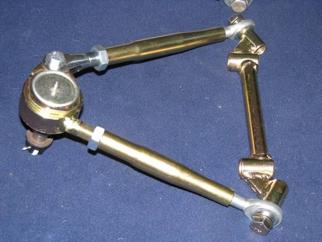

      www.scandc.com street comp kits have adjustable arms and balljoints that fit your stock spindle. Talk to Marcus he will get you headed in the right direction.

      how much caster are you looking for? what are you trying to accomplish? Any decent aftermarket arm should net you near 5* caster or more. much more and the tire gets into the wheel well as the wheel gets set back too much. I think SPC now makes a lower CA that pushed the LBJ forward a bit to alleviate some of that clearance issue.
