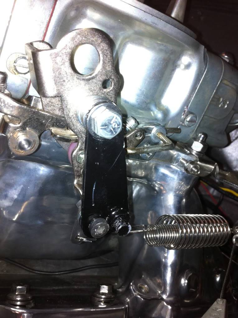

      I had the same issue with my Speed Demon. I used these drawings to fab my own......I did not cut or modify the carb linkage I made one that is a lot like the holley one....

      It was real easy, I took a piece of steel (or aluminum) and marked it out for all the holes. The top and bottom holes for mounting to the throttle linkage and marked out for where according to the specs in the link the cable should hook to. It looks a lot like this one from Holley
      http://www.holley.com/data/Products/.../199R10345.pdf
      but for my application the TV attachment is a lot closer to the lower mounting hole. If the mounting tab is real close to the lower hole like on mine I recommend either countersinking a machine screw or welding/tapping in a stud as my allen head bolt needed to be filed down to clear the TV cable tab.
      I would recommend either using steel for it and either welding the TV cable tab from the back side or either steel or alum and drill and tap the hole so you can just screw it in. I had to space the bracket out a little from the throttle linkage to clear the throttle shaft nut too.
      I am going to refine mine now that I know of all the quirks I had to encounter......

      Here are some pics I just took and uploaded.......
